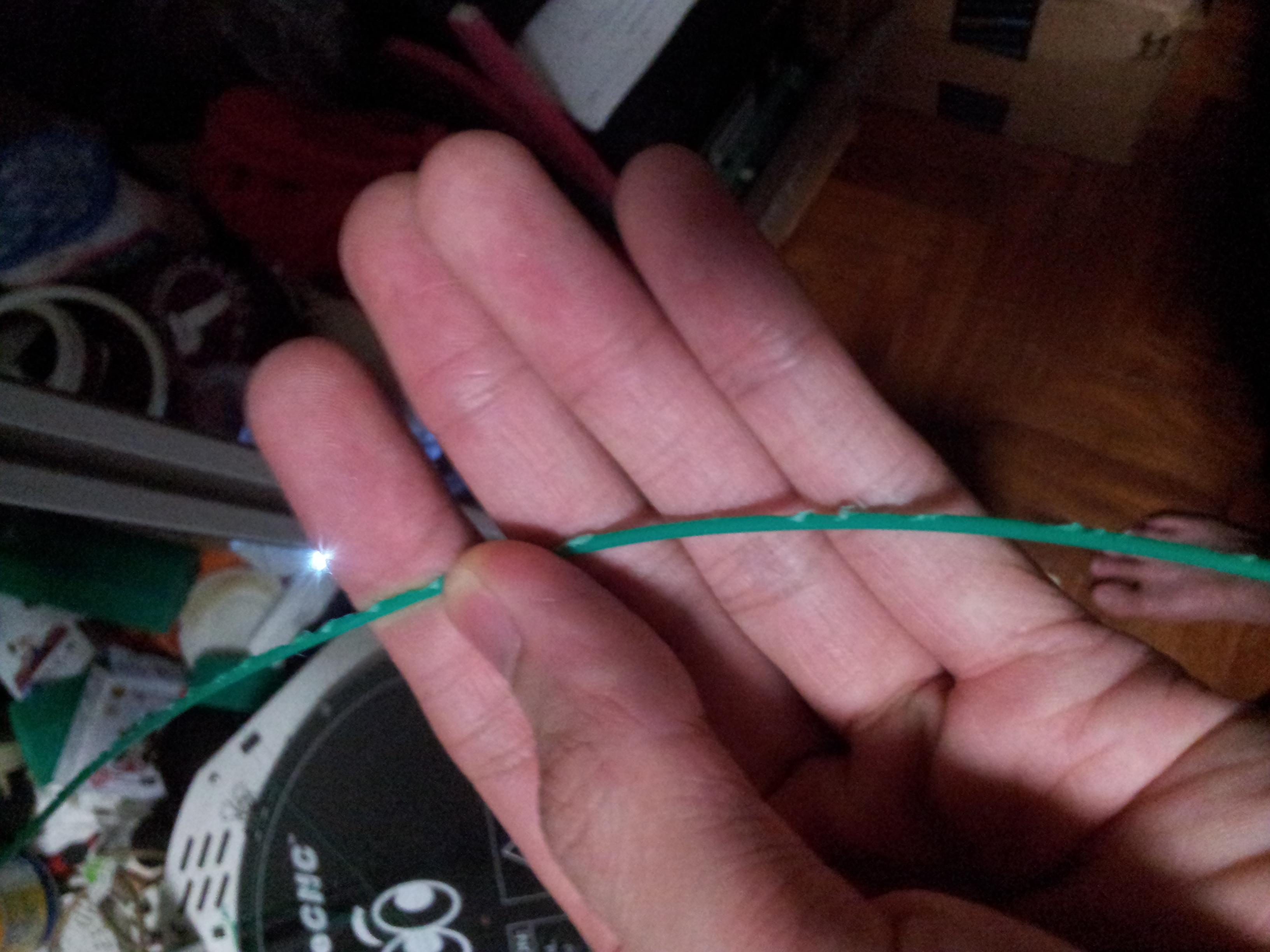

				Rostock Max v2. At seemingly random intervals I get this issue where the hobbed gear grinds into PLA filament and forms large burrs. The larger burrs then get stuck in the 4mm Quick Connect PTC Fitting connectors. Once this starts happening on a print it tends to recur,the burr gets stuck on one or both of the PTC brass connectors, leading to the filament getting slowed down or stuck at the cold end too, causing even more burrs. The choke causes extremely under-extruded portions or even entire layers with nothing more than wisps of plastic in between. Occasionally, after a while, the burr gets pushed through and the print can resume, but with extremely weak layers in between, the part integrity is severely compromised.

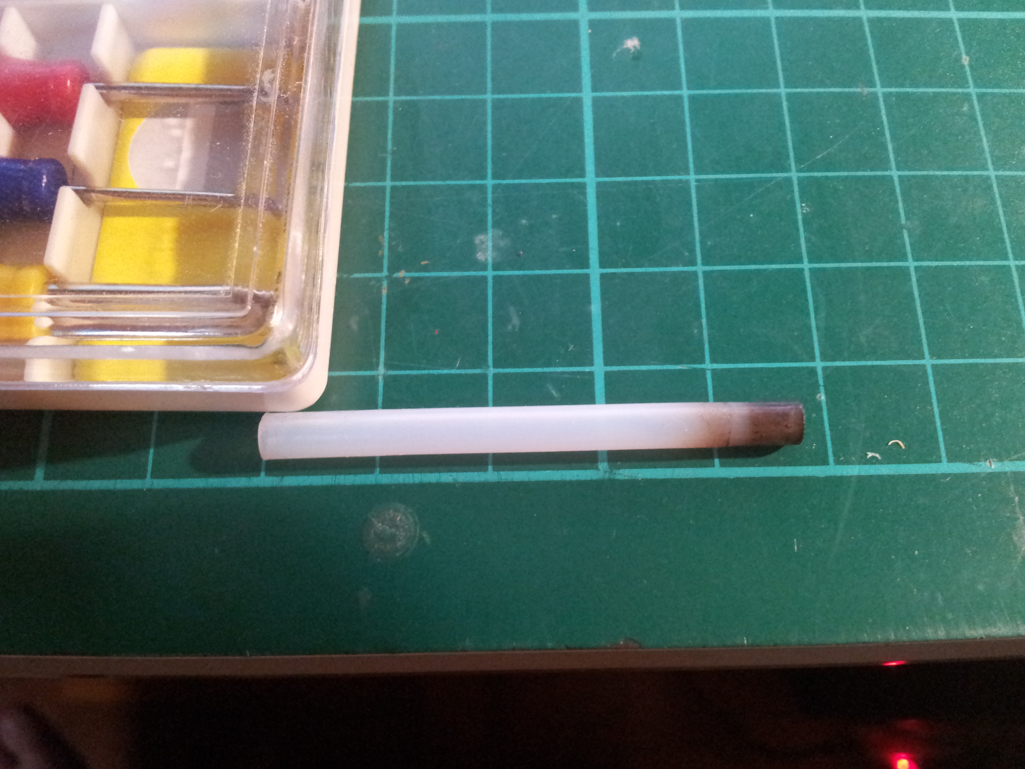

Unscrewed the hot end PTC and had to use pliers to pull this out because the burrs jammed at the top PTC.
If it was just 1 or 2 burrs it probably wouldn't be an issue but once it starts happening the frequency rapidly rises, practically the entire length of filament is covered in burrs.
Huge burr. The thickness is easily 2mm if not 2.5mm.

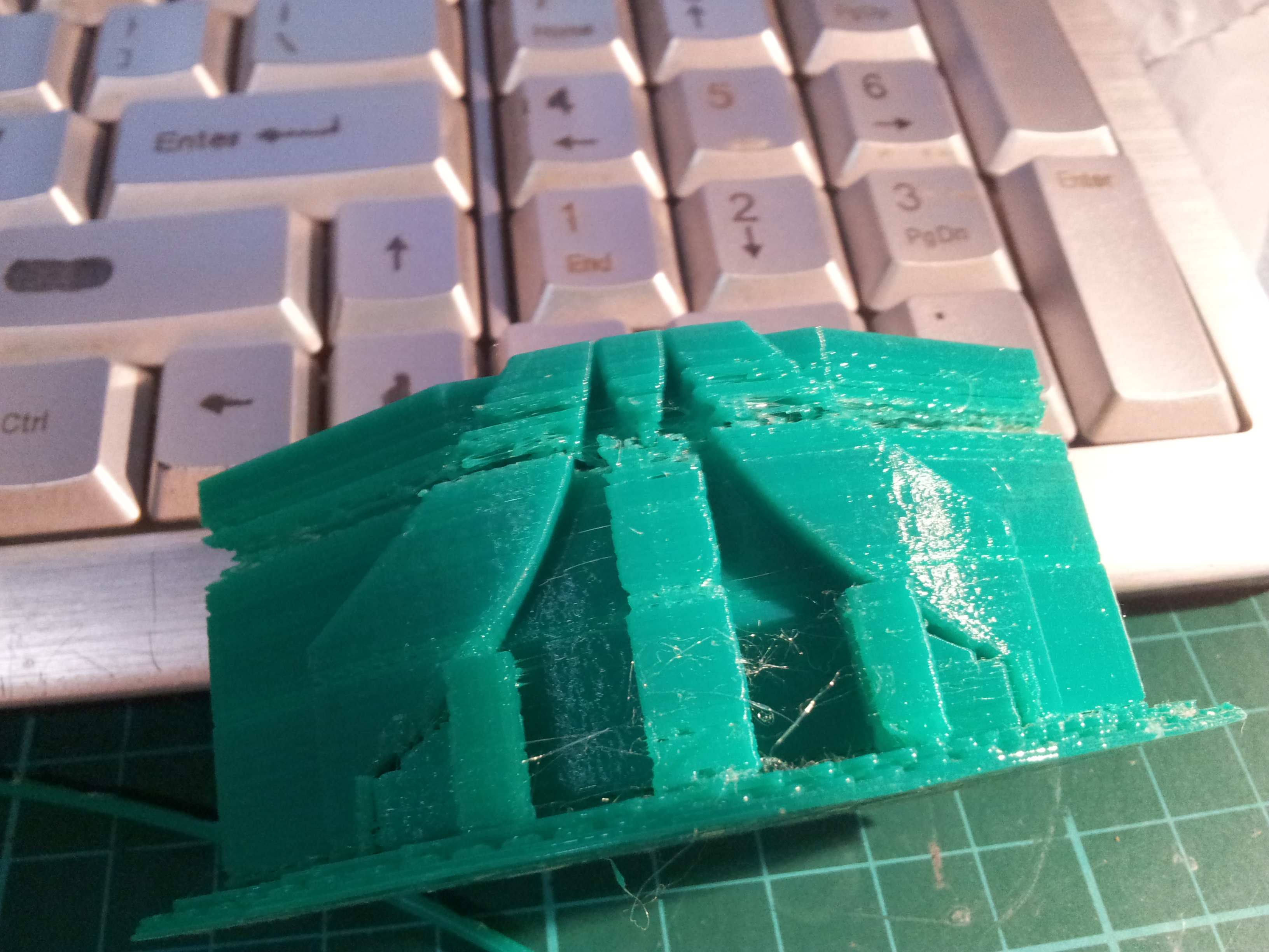

Part ruined due to underextrusion from burr. First, small parts start being underextruded. Then entire layers become wisps of plastic. Finally the part simply broke due to not enough strength.
