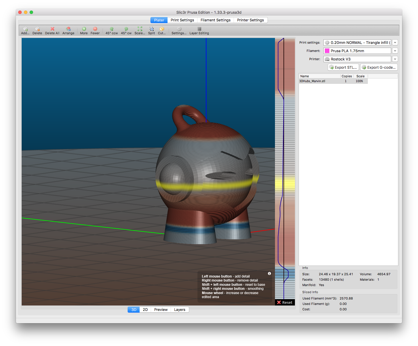

Prusa has been overhauling the venerable Slic3r slicer. The previous release back in Nov was awesome. Not only have they re-written code in C++ to improve performance and reliability, they added some great new features like the cubic 3 dimensional infill (which is excellent). A new version was released this weekend, see above. In addition to additional C++porting it adds variable layer heights (!) and much improved support generation.
Prior to this release, I began using Slic3r Prusa Edition more and more (especially on my i3 MK2) as it is generating very nice gcode and actually works reliably. This new version offers features even my favorite KISSlicer doesn't have. Many people are claiming that Slic3r Prusa Edition is catching up to and surpassing S3D in many areas - and is open source and free. If you are thinking about S3D I STRONGLY encourage you to try this slicer.

Thanks for posting this. I am giving it a try but find the transition from one layer height to another, with the variable layer tool, leaves a very noticeable line.
Re: New Slic3r Prusa Edition (rocks)
Posted: Mon Feb 13, 2017 7:23 pm
by mhackney
This is beta but I found it did a great job on the Marvin model (almost a spherical body). Prusa has a very active git for this project so file bugs if you find them. They are seriously overhauling this slicer by storm.
