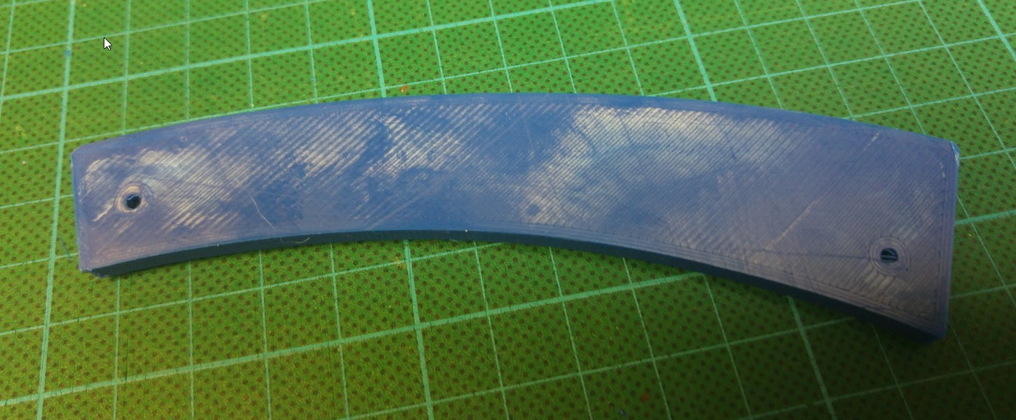

I have another disaster to mention
I am using PEI on glass for a while now, and it works good, but not as well as I hoped. I have been upping bed temp to 90 to avoid ABS prints to curl up. Small parts no problem, but things like enclosure brackets are still curling up at 90C. To prevent that I have been roughening up the PEI surface with sandpaper grid 1000 a bit. Repeated that a few times because it did not seem to help much. Now it's a lot better, but the print is not popping off after the bed cooled down. Usually I give the print a firm spanking to the side to force-impact it off the bed, but that is getting more difficult now. I am too impatient to let the bed cool down completely when I have more prints to follow.
Now I used the spatula a bit to forcefully and the PEI seems to have lifted a bit, so now my bed is uneven and I can start all-over...
My ABS prints are coming off the PEI with a white discoloration on the bottom. That completely ruins the nice finish the PEI gives it.
I am thinking about heat resistant spray glue and an extra alu disc for the next sheet of PEI. Anyone tried that? I hate the 3M adhesive...

Another bracket finished.
I removed this one with the spatula, off a completely cooled down plate. I did not pull at all, just moved the spatula from side to side. There is a white discoloration visible (on ALL my prints!). Only way to get rid of that is to sand, or flame it with a torch. But that makes the bottom of the print bulge. This happened as well before as after sanding the surface.I am DeltaCon, I have a delta, my name is Con, I am definitely PRO delta!

Pulling up on print is wrong way. You should never have to use pliers. Does it not mar the print? Often just a sharp crack with a small hammer in the right spot will release it from PEI. Sometimes putting a metal putty knife under one corner or unimportant edge and giving it a sharp CONTROLLED tap will do the trick.gchristopher wrote:
If the print can be gripped with pliers and pulled directly upward and away from the PEI, that seems to work best, and I have no idea why. Maybe it's that I'm grabbing a corner and pulling that edge up first, then the rest releases?
Re: PEI disaster
One tip I learned from mhackney was to sharpen and bevel the spatula tip so it essentially it is razor thin. all you need is the proper angle to get a tiny portion underneath the print but not dig into the pei surface, then you can level the spatula and slide it underneath the rest of the print easily. I have NO issues getting prints off PEI anymore
