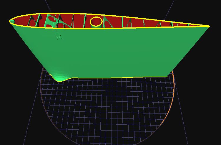

Already tried it - I cant figure out how to get it to slice AND include the ribs/spars. So how do I set it up to for a hollow object, that contains hollow interior objects, with no top or bottom surfaces?
Re: Print 3dlabprint Airplanes and Rostock Max - any success?
Posted: Tue Dec 27, 2016 6:17 pm
by DeweyOxberger
Here is what a mean; from Kisslicer it doesn't seem to know about the interior ribs/spars. When it generates the G-code it creates a segmented perimeter with loads of retracts on the filament and nothing on the interior. I can't figure out what I'm doing wrong.

Here is someone who had success but he had to use S3D to pull it off:
http://forum.seemecnc.com/viewtopic.php ... int#p74148
Posted: Tue Dec 27, 2016 9:21 pm
by Polygonhell
If Kiss is omitting the ribs, I'd run the model through netfabb, it's probably bad geometry in the original model. Slicers vary a lot on how well they deal with various errors in the original mesh.

So 3dlabprint has some test parts that people can try. They have videos (links in the pdf manuals) that show how to configure the various slicers for their prints.
http://www.thingiverse.com/thing:1875834 or http://www.thingiverse.com/thing:1207209
Posted: Wed Dec 28, 2016 6:42 pm
by DeweyOxberger
They use Simplify3D at work so I spent the morning making the fff file for my Rostock Max V3. Printing with S3D totally fixes the voids problem. Now I have a bit too much stringiness but no globbing or zits. I'm going to let one of the wing sections run to completion to see how it turns out.
