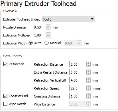

...are you simply ignoring what people have been telling you? I've seen more than reply stating that you need to treat the HE280 like an E3D v6. Small retract distances (~2mm), SLOW retracts (~25-40mm/sec) and ~4mm vertical lift, otherwise you're going to have a mess (or a jam) on your hands.
Below are my retraction settings for S3D and PLA....works great.
s3d pla settings.JPG (33.63 KiB) Viewed 17754 times

No I'm not ignoring anything. I have tried everyone's advice and have ended up here. I used the settings you recommended a while back and they reduced the stringing, but not by much. I don't know ANYTHING about an "E3D V6, nor how to treat one :lol: !!!? I'm new to this and still learning, obviously! No need to bite my head off! :evil: Forget I even asked.

I suspect their "factory" v3 settings are assuming the older, PEEK equipped hot end. That hot end could take really long and fast retracts without any problems since 98% of the filament path was PTFE tubing and didn't hit metal until the nozzle orifice itself.

Geneb, this is using the EXACT numbers you posted. The stringing is still pretty bad. I'm thinking it might be something mechanical at this point, but I don't know what I should check.

Is that with a 4mm z-lift? Those strands look really thick - printing too hot maybe.
Your best object for dialing in retract is a cylinder. Print two at once and adjust until there's no strings between the two parts.

Yes, it's w/4mm Z lift. I'll try the cylinders now. I'm really starting to lose hope in this machine.

I wish I had someone local here that could come and help me get this right. Like you said, I don't want aggressive settings that will destroy the filament. Do you have any other settings I should check? I set my multiplier like you had yours at 1.00, nozzle dia at 5.00 and extrusion width at .60.
Re: Anyone know how to "clean up" rough prints?
Posted: Sat Dec 17, 2016 8:44 pm
by skyjuice
Well, I just printed with Mattercontrol instead of S3d and so for there is absolutely ZERO stringing happening! Settings. You are correct gene
