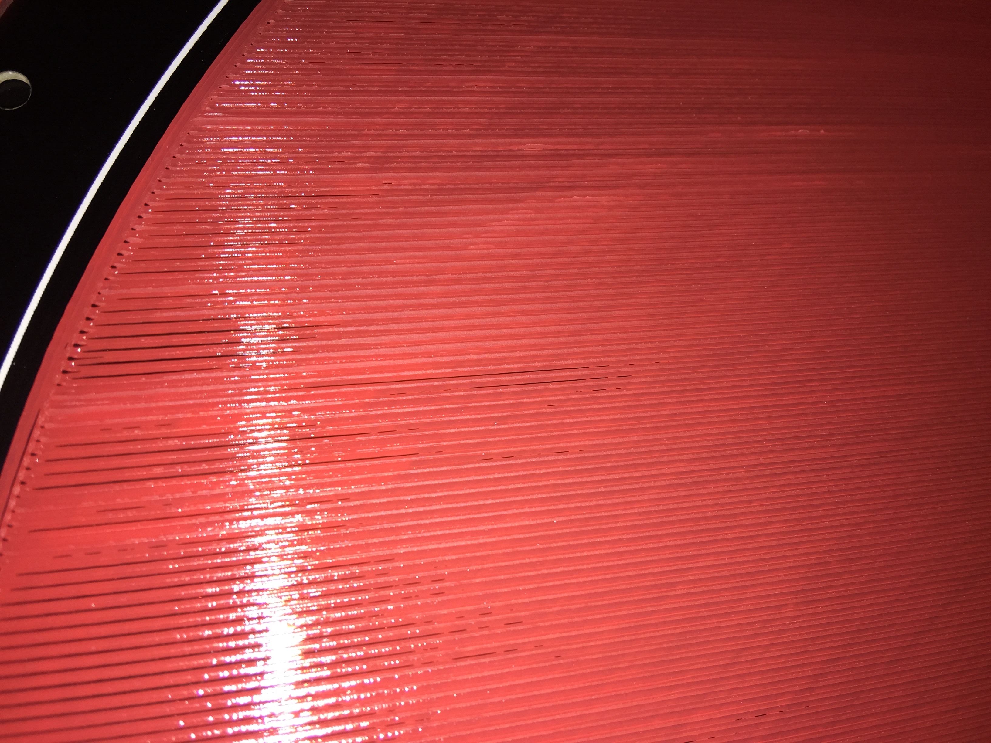

Posted: Sun Dec 11, 2016 1:53 am
by ToddZilla
WOW! After getting the new firmware & OctoPrint plugin working, you can see the great results in the pictures. It's a single-layer 270 mm diameter disk. I still have a few slightly high and low spots, but overall DC42's least-squared calibration routine has made a MASSIVE improvement over what I had before (you can see my post in the Troubleshooting forum on my earlier troubles if you're that bored). The entire print bed is now usable, which was not the case before today. Kudos to DC and the SeeMeCNC crew! Thanks a ton!

Having said that what sort of accuracy are we looking for? My one time got me to .04mm error across the build surface
.04mm converts to .0015748". Human hair varies in diameter, but the average is around .07mm, or .0027559".
So the real question is, Are you happy with .04mm?
