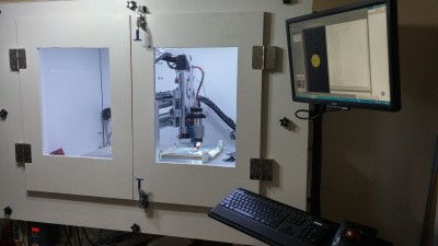

I am also very happy to announce that our new mill is up and running at last and very shortly we will cut our turn around time to just a few days on all orders. We are currently milling tons of stock and will officially change our stated turn around times to the new faster times shortly.
Meet our new Mill! We call him Fred.
