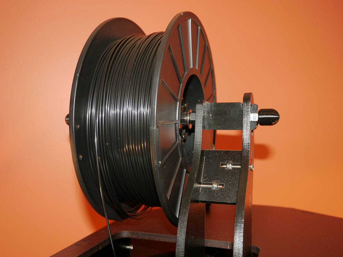

I replaced the spool arm because I found that the spools on the stock arm created a lot of rocking during retractions. My new arm uses 5/16" threaded rod with 608 ZZ skateboard bearings. I printed a mount to hold the threaded rod in the stock spool arm bracket and then printed some 'spring loaded' hubs that fit into my filament spools. The bearings fit into the hubs and everything is smooth as silk.
New spool arm
New spool arm

Thank you for a great write-up and a great build. Your accessories you added really helped the printer, especially the spool holder you created.
A very great job you accomplished and thanks for sharing it with us. We will help you in any way we can, happy printing. :)
