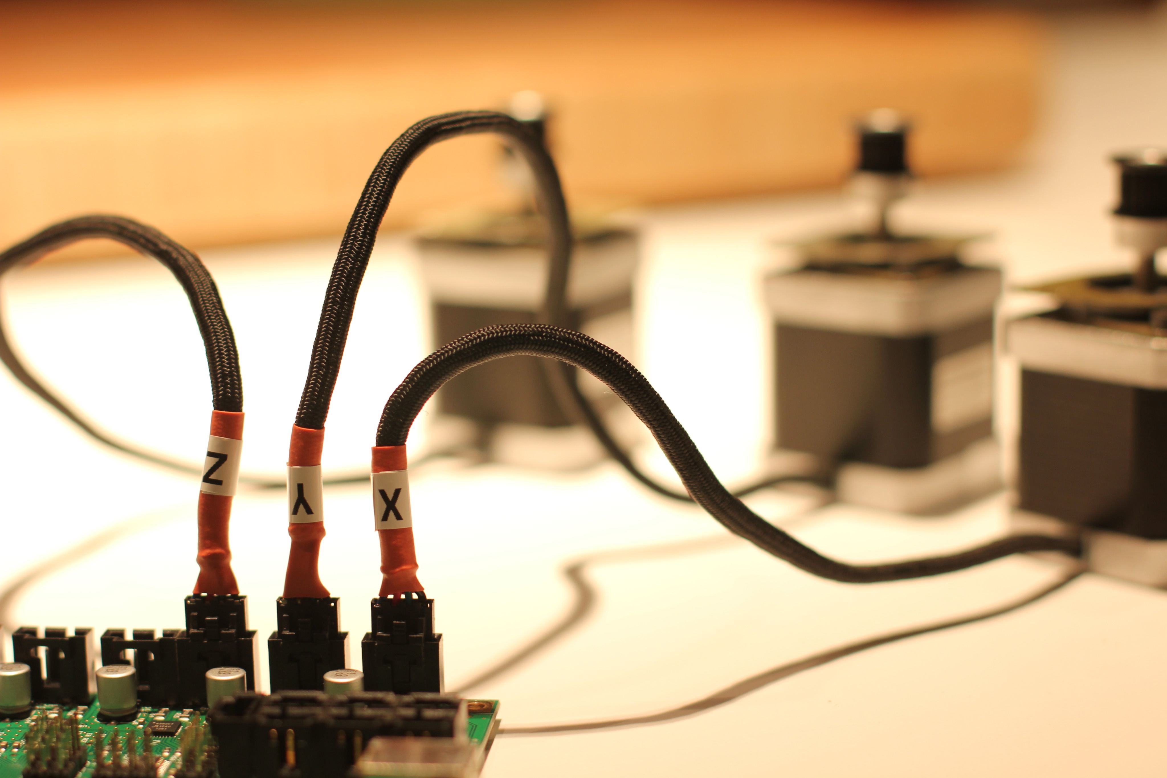

The day before my replacement RAMBo board came in, the motor dampers from astroboy907's group buy came in.
So I installed them. They work great. I'm not sure how much quieter they really are, since the printer was down for three weeks, but they _seem_ quieter.
While I had the motors out, I decided to dress the wires. I used the old paracord sheath trick. That, along with some heat shrink tubing and label tape, made decent looking motor wires. In my ever-so-humble opinion. (-:
1 use for a dead RAMBo.
I need to do something with the limit switch wires, too. And then, if I'm going to high-mount my extruder, I'll want to redo the wiring to the extruder and hot end too. In other words, I want to redo all the wiring. (-:

geneb wrote:I'd love to learn more about the "paracord sheath trick" you used.
"Ah, yes. The old paracord motor wire sheath trick." — Maxwell Smart
Updating a classic.
Updating a classic.
I learned the paracord trick from Bart Dring, who runs buildlog.net. But I can't find a description, nor even any pictures, on that site now.
Parachute cord has a nylon sheath around a bundle of longitudinal fibers (also nylon, I think). You don't need the mil-spec stuff; wire dressing is not life critical. It comes in lots of colors, so you can color code your wiring, but I just used black. Many sporting goods stores sell it. I got mine on Amazon.
Cut a piece of cord about an inch longer than you need. Pull out the inner fibers and discard. Slide the sheath onto a metal tube. (This is the hard part; see below.) Using a soldering iron you don't like very much, melt-cut a ring around each end of the cord. This leaves a fused nylon end that is round, not flattened. Pull off the frayed ends and discard.
I hate you, solder tip!  I coat you with gummy nylon!
Next, stuff the ends of the wires into the tube and slide the sheath off the tube and onto the wires. Slide on a piece of heat shrink tubing.
Note: these wires are too big for paracord.
Attach the connectors to the ends of the wires. Slide the sheath into place, then the heat shrink. Heat it and shrink the shrinkable, being careful not to melt the nylon. El voila!
How do you get the sheath onto a metal tube? I'll tell you how I do it, but I'm sure there's a better way waiting to be discovered.
I got a length of 5/32" OD brass tubing from the hobby shop. First I burnished and rounded the end so that it would slide in a little easier. That sort of worked, but wasn't great -- the tube edges would still catch the nylon fibers and snag.
So I made a needle end. I got some 6awg wire at Lowe's. They sell it, uninsulated, by the foot, and I only needed 6 inches or so. 6awg is just slightly bigger than the 5/32" tubing. This is the wire that grounds your house's fuse box (if your house is wired to US electrical code).
I put the wire in a drill press and used a piece of sandpaper to make a blunt point on one end. On the other end, I turned it down (still using sandpaper on a drill press), then gave it threads using a handheld die.

I enjoyed reading that but I have a question about doing it that way or using ordinary wire sheathing.
Is there an advantage to your method?
Posted: Wed Aug 14, 2013 4:47 pm
by geneb
I know my reaction to an iphone on my shoe would be, *STOMP* followed by, "Eewwww! Scrape it off!" :D
Nice trick kbob. You know they actually make that sleeve material FOR doing wiring harnesses right? I'll have to see if I can find it online.
I like the diy-ness of your method though. Works great if you can't find the "real" wire sleeve material. :)
Posted: Wed Aug 14, 2013 8:24 pm
by lordbinky
Yeah you can buy braided wire sleeving, but for the impatient DIYer I can think of four brick & motor stores I know off off-hand that carry paracord which is still similarly priced as the cable sleeving, and I live in a tiny town in the middle of nowhere so alternatives to waiting for mail delivery are great.
