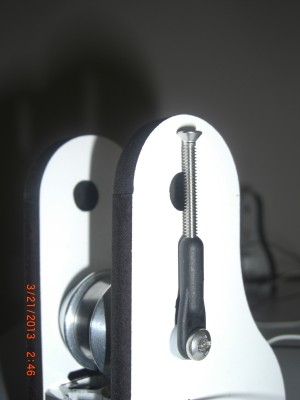

looks like its gonna be a no go, on my turnbuckle belt tensioner idea. If there was more room between the big hole at the top and the slot; It would work, but there's not enough spacing between the two to make it adjustable, even for the smallest turnbuckle so i'm gonna have to rethink this idea a little bit.
here is the other idea, the adjusting screw would go through a rod, in the top holes. I might use 4-40 studs instead of screws and have an adjusting nut at the top.

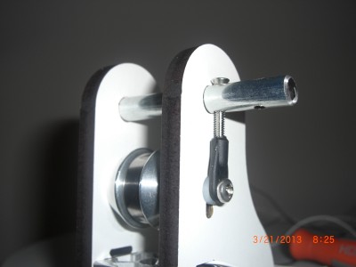

Something along these lines I was thinking.

I just happened to have a perfect sized bit of aluminium round stock sitting here (leterally right beside me) and thought I'd drill a quick hole in it a see how it worked real quick.
Hobby store will have this for sure in their round stock selections.

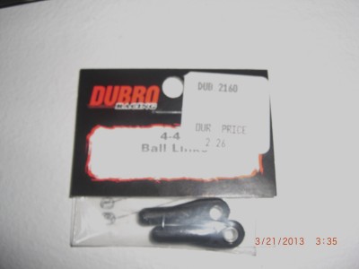

The bottom dogbone end is from their RC car area and can be had in a bag of 10 of them for around 10 bucks I think. I also had it just laying here.

Eaglezsoar wrote:I would appreciate it if you can find the part # for that dogbone part, I have no idea how long to make it and would appreciate it.
My printer assembly is not that far along so I can't measure what it should be as far as length and thread size.
those are actually ball links or tie rod ends. they come in different sizes. the ball links can be popped out like i did to fit 6-32 stock screw.
this one is sized for a 4-40 turnbuckle or screw. They also make a heavy duty version like flateric's
Hardware store should stock some 5/16 diameter steel rod to use as the top rod. brb. lol

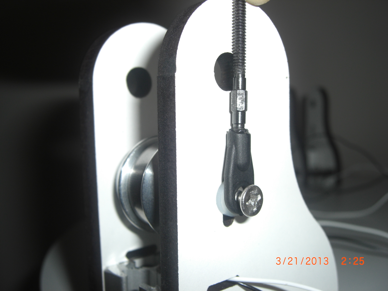

well I made some progress on my idea, I did manage to get some 5/16" diameter steel rod from home depot. I was able to cut it down and drill holes. here is the prototype..
I made a jig to somewhat accurately drill the holes. shown in the photo below, put the rod in the 5/16" hole in the side.
Then drill the smaller holes from the top. Once you drill one of the top smaller holes, put a matching size screw to hold the rod in its place then drill the other hole. That keeps it somewhat lined up. works good.
tomorrow i'll make the rest of the tensioners, almost done with the build.
edit: this idea was not used because I couldn't accurately drill the holes into the rods, even with the makeshift jig i made. I'm currently working a new angle on this. check for it in the following posts

Eaglezsoar wrote:Are those 4-40 screws going into the rod ends?
yes, i had a bunch of those lying around, but I found some aluminum rod ends i'm going to try out and post and update if it works out.
