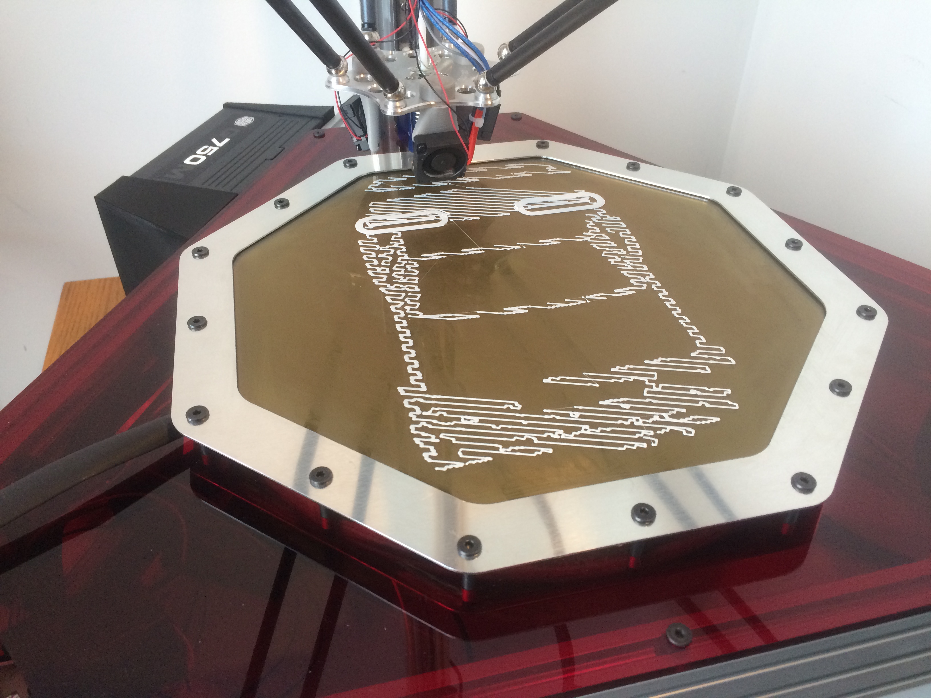

This is why I only use the 1/8" thick sheets and only advise people to use that thickness. The thickness allows the sheet to be held down with only friction, with binder clips on the edges or the like. There is no need for adhesive, the sheet stays flat because of the clamps and the thickness of the sheet.

The sheets I receive all have bows in them. I simply flatten them down to the glass with friction. On my Rostock max I use binder clips around the perimeter, on my new printer I designed custom clamps to hold all around the edges. Maybe using an octagon instead of a circle allows the sheet to more easily be clamped flat. I've been printing for over a thousand hours with the PEI sheet, and I am never looking back, nor would I ever consider adhering the sheet to anything. The beauty of the 1/8" is in not adhering it.

Holy1 wrote:Did you want to share those clamps?bot wrote: I designed custom clamps to hold all around the edges.
I just noticed your post now, sorry. I will definitely share the clamps, but they are for a very specific design, and are cut on a CNC router table, so I'm not sure how useful you will find them. I'll show you a picture. If you want them, let me know and I'll upload some cad files.
