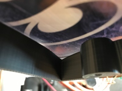

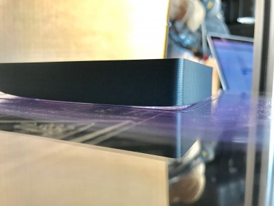

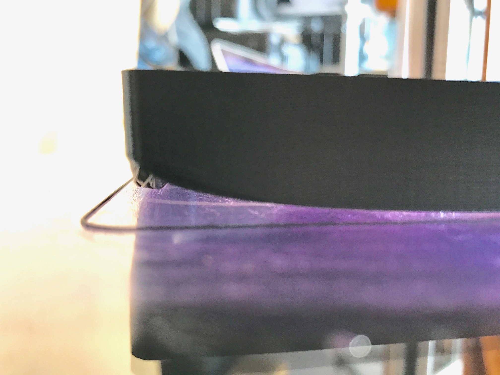

Except it only and always occurs in the same spot. it's not adhesion issues it's bed slant you can see it when it prints the ring around the object. it's squished on the YZ side and round on the XZ side
Re: OpenDACT(Delta Automatic Calibration Tool) - For Repetier
It is likely a combination of these factors. The V2 guides have an entire section on calibration. The first step to calibrate end stop offsets is all you need to do.
Posts: 5357
While it does appear the skirt around that corner is kind of high, the "bent" corner you see is /classic/ ABS warp. To the point where if I was going to write a textbook on 3D printing, I'd use your photo to describe ABS warp. (Unless of course you're using PLA, in which it STILL looks like classic ABS warp, but at least I'll shut up about it. :D )
Just for giggles, re-print that part with a 6mm brim and see how it comes out.

I've occasionally gotten some lift on larger PLA prints, but nothing like that. That looks like ABS to me.

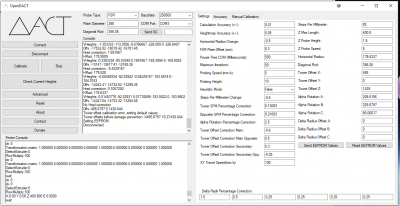

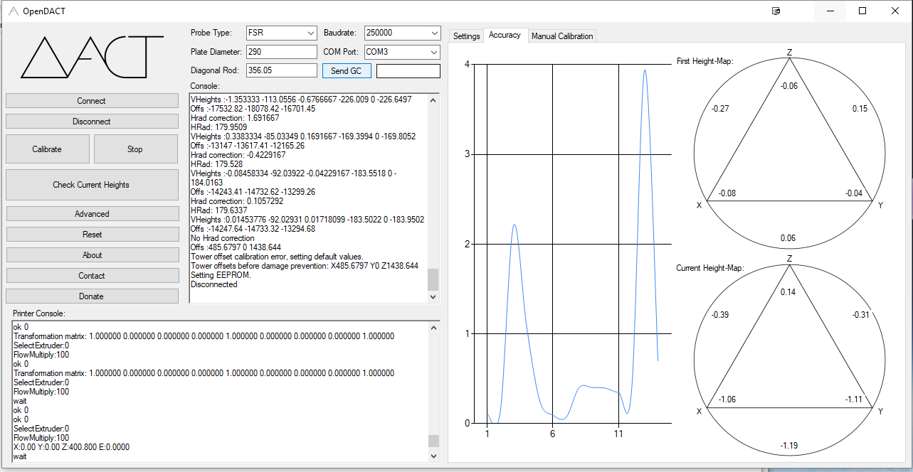

Hey guys
I'm trying to calibrate my custom built Delta Printer.
But I must have set someting worn in the tool, because the results get worse instead of better...
I was using OpenDACT 3.10A
Here I started a tuning process, and I stopped, because Its not working, but you can see, that its getting worse...
[img]http://forum.seemecnc.com/download/file ... &mode=view[/img]
And Here are my setting (default)

Continuing Calibration
Tower:True SPM:False Alpha:True HRad:False
VHeights :-0.1599782 -13.25022 -0.07998911 -26.86886 0 -26.38608
Offs :-2028.193 -2122.97 -2032.08
Hrad correction: 0.1999728
HRad: 180.2
VHeights :0.02749626 -13.23147 0.03249558 -26.77512 0 -26.26109
Offs :-2036.192 -2124.303 -2023.415
No Hrad correction
Offs :88.11084 0 100.8883
Setting EEPROM.
Calibration Iteration Number: 3
Tower:True SPM:True Alpha:True HRad:False
VHeights :-2.719998 -222.5173 -1.359999 -450.2928 0 -443.0833
Offs :-35743.66 -35950.78 -36323.55
Hrad correction: 3.399997
HRad: 183.6
VHeights :0.6799995 -166.197 0.3399997 -336.5189 0 -328.8372
Offs :-26928.86 -26984.86 -27206.52
Hrad correction: -0.8499993
HRad: 182.75
VHeights :-0.1699999 -180.2767 -0.08499993 -364.9615 0 -357.3979
Offs :-29132.5 -29226.28 -29485.72
Hrad correction: 0.2124998
HRad: 182.9624
VHeights :0.02921872 -180.2568 0.03453122 -364.8619 0 -357.2651
Offs :-29141 -29227.7 -29476.51
No Hrad correction
Offs :335.5137 248.8184 0
Setting EEPROM.
Calibration Iteration Number: 4
VHeights :2.073354 172.622 1.036677 346.1007 0 346.4081
Offs :27839.88 27849.48 27666.85
Hrad correction: -2.591692
HRad: 180.3708
VHeights :-0.5183383 129.6914 -0.2591692 259.3756 0 259.3231
Offs :21120.72 21015.13 20717.31
Hrad correction: 0.6479229
HRad: 181.0187
VHeights :0.1295845 140.424 0.06479226 281.0569 0 281.0944
Offs :22800.47 22723.67 22454.65
Hrad correction: -0.1619807
HRad: 180.8567
VHeights :-0.02227235 140.4088 -0.02632186 280.9809 0 280.9931
Offs :22806.95 22724.75 22447.63
No Hrad correction
Offs :359.3164 277.1211 0
Setting EEPROM.
Calibration Iteration Number: 5
VHeights :0.4400222 36.57982 0.2200111 73.58115 0 73.49393
Offs :6189.809 6132.699 5872.589
Hrad correction: -0.5500277
HRad: 180.3067
VHeights :-0.1100056 27.46874 -0.05500278 55.17514 0 55.01154
Offs :4763.804 4682.249 4397.694
Hrad correction: 0.1375069
HRad: 180.4442
VHeights :0.01890721 27.48163 0.02234488 55.23959 0 55.09748
Offs :4758.303 4681.332 4403.652
No Hrad correction
Offs :354.6509 277.6797 0
Setting EEPROM.
Calibration Iteration Number: 6
VHeights :0.1333332 11.04122 0.06666659 22.41518 0 22.24926
Offs :2119.045 2050.638 1780.342
Hrad correction: -0.1666665
HRad: 180.2775
VHeights :-0.02291665 11.02559 -0.02708331 22.33706 0 22.14509
Offs :2125.712 2051.749 1773.12
No Hrad correction
Offs :352.5919 278.6288 0
Setting EEPROM.
Calibration Iteration Number: 7
Tower:False SPM:False Alpha:True HRad:False
ABC:209.8156 329.8797 90.06017
Setting EEPROM.
Calibration Iteration Number: 8
VHeights :0.08667374 6.860276 0.04333687 14.19611 0 13.91259
Offs :1434.083 1369.268 1188.342
Hrad correction: -0.1083422
HRad: 180.1692
VHeights :-0.01489705 6.850119 -0.0176056 14.14532 0 13.84488
Offs :1438.417 1369.99 1183.647
No Hrad correction
Offs :254.7692 186.343 0
Setting EEPROM.
Calibration Iteration Number: 9
VHeights :0.03685497 -0.3445101 -0.006884798 -0.229965 0 -0.4946545
Offs :186.3295 128.3286 36.82776
No Hrad correction
Offs :149.5017 91.50081 0
Setting EEPROM.
Calibration Iteration Number: 10
VHeights :0.06001918 4.645482 0.03000959 9.701002 0 9.429336
Offs :881.8104 826.4779 833.1454
Hrad correction: -0.07502398
HRad: 180.0941
Tower Offsets and Delta Radii Calibrated
Setting EEPROM.
Calibration Iteration Number: 11
VHeights :-0.003288761 -0.3590479 -0.02672242 0.1391668 0 -0.2182557
Offs :10.16529 -67.75176 25.8729
No Hrad correction
Offs :77.91705 0 93.62466
Setting EEPROM.
Calibration Iteration Number: 12
VHeights :-0.03002927 -0.4683785 -0.0400143 -0.4017672 0 -0.7001047
Offs :3.327781 -74.67357 112.6585
No Hrad correction
Offs :78.00135 0 187.3321
Setting EEPROM.
Calibration Iteration Number: 13
VHeights :1.806687 143.9698 0.9033434 305.2922 0 300.2098
Offs :23675.97 23274.71 24683.34
Hrad correction: -2.258358
HRad: 177.8358
VHeights :-0.4516716 106.5604 -0.2258358 229.7193 0 224.3234
Offs :17820.98 17319.36 18627.61
Hrad correction: 0.5645895
HRad: 178.4004
VHeights :0.1129179 115.913 0.05645895 248.6112 0 243.2937
Offs :19284.82 18808.29 20141.63
Hrad correction: -0.1411474
HRad: 178.2592
VHeights :-0.01940776 115.8998 -0.02293645 248.545 0 243.2055
Offs :19290.47 18809.23 20135.52
No Hrad correction
Offs :481.2402 0 1326.289
Tower offset calibration error, setting default values.
Tower offsets before damage prevention: X481.2402 Y0 Z1326.289
Setting EEPROM.
Calibration Iteration Number: 14
VHeights :-1.353333 -113.0556 -0.6766667 -226.009 0 -226.6497
Offs :-17532.82 -18078.42 -16701.45
Hrad correction: 1.691667
HRad: 179.9509
VHeights :0.3383334 -85.03349 0.1691667 -169.3994 0 -169.8052
Offs :-13147 -13617.41 -12165.26
Hrad correction: -0.4229167
HRad: 179.528
VHeights :-0.08458334 -92.03922 -0.04229167 -183.5518 0 -184.0163
Offs :-14243.41 -14732.62 -13299.26
Hrad correction: 0.1057292
HRad: 179.6337
VHeights :0.01453776 -92.02931 0.01718099 -183.5022 0 -183.9502
Offs :-14247.64 -14733.32 -13294.68
No Hrad correction
Offs :485.6797 0 1438.644
Tower offsets before damage prevention: X485.6797 Y0 Z1438.644
Setting EEPROM.
I hope someone can help me with this.
Thanks in advance ;)
