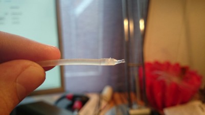

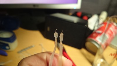

My first attempt to remove the filament was a failure. I had my pliers in the freezer as well, to make sure the nozzle didn't heat up too quickly. Unfortunately when I twisted, the filament twisted too and it broke off at the end of the nozzle. There was no more filament to grab, so I reset the procedure. Right now I have another piece of PLA in the nozzle and this time I put the freezer to the max! Hopefully in a few hours it will pop right out.
Re: E3D V4 All metal hotend
Posted: Wed May 21, 2014 1:51 pm
by mhackney
I haven't done this with 3mm filament. You could coat take the nozzle off, cut a 4" section of filament. Coat the tip of it with mineral oil or vaseline - sparingly, then hold the nozzle in pliers and heat with a lighter or candle, pushing the filament through. As soon as a little comes out the tip, remove the heat and chill.
Posted: Wed May 21, 2014 1:54 pm
by milosonator
mhackney wrote:I haven't done this with 3mm filament. You could coat take the nozzle off, cut a 4" section of filament. Coat the tip of it with mineral oil or vaseline - sparingly, then hold the nozzle in pliers and heat with a lighter or candle, pushing the filament through. As soon as a little comes out the tip, remove the heat and chill.
Thanks for the suggestion, I thought since there is much more volume of potientially shrunk PLA compared to surface area that It would be even easier. In a few hours, we will know. If that doesn't work, ill try your suggestion.
Update:
I've failed at another freeze test, the filament is just not strong enough to overcome the friction of being stuck to the nozzle. However, after some attempts, the vaseline method did pay off. But due to the warmth of the nozzle, the measured length of the bore cannot be realiable! But since that is all I have to work with I did some measurements, and established that is pretty much 2mm.
Then I grabbed a 2mm drill bit and tried to dig down another 1 mm into the nozzle, reducing the bore to about half its original size. After trying to do this, i've re-measured using the vaseline method. The tip of removed PLA probably strechted a bit, BUT: I quite accuratly removed 1mm of the bore. You can see the beatifull 2-staged rocket that is my rocket now.
Two-staged rocket, looks very smooth
Now it's time for some static extrusion tests, but moving the filament by hand already _seemed_ to be easier after the initial flow.
Comparison of the before and after inner nozzle inprint
Update 2:
Statically extruding material went very well, too say the least. At 180 degrees, at 40 mm/min (filament) speed, long hauls of filament extrude without hickups, as it should!
Illustration:
https://www.youtube.com/watch?v=Blnxfb0Izxw

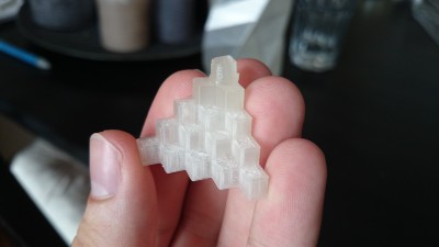

Update:
First print out looks great. No jams, all looking good. More prints will determine if this was a permanent solution for my problems, but at this point it looks very promising. Need to tune my minimum layer time though.
Calibration piece after nozzle modification.
Update 2:
aaaaaand it starved again.. any more tips?

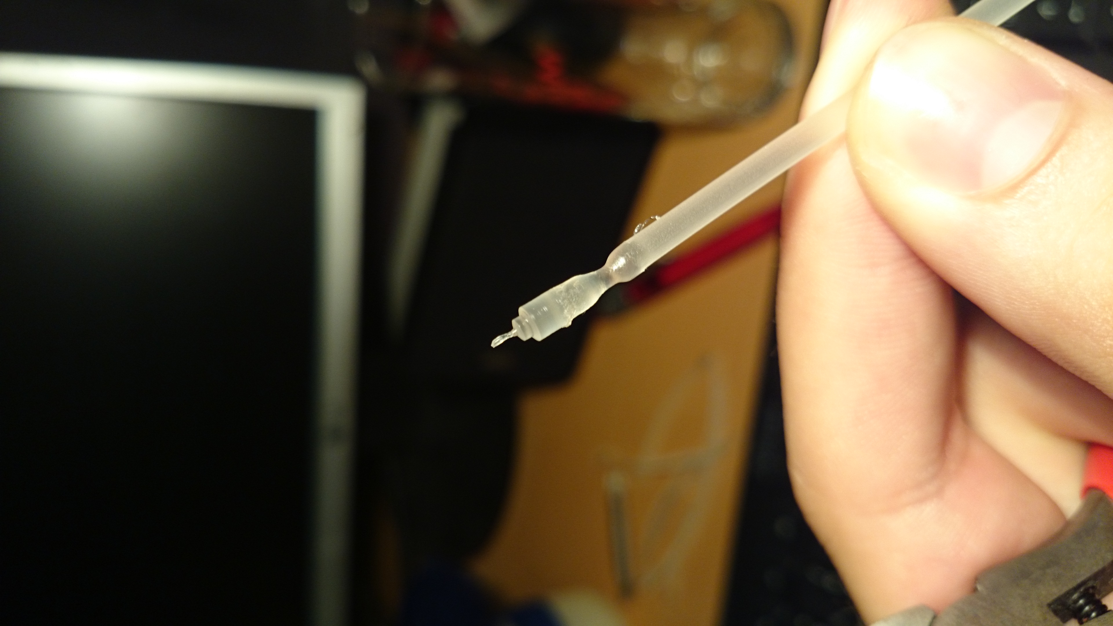

Another jam, printing at 210 degrees (10mm/s) constant extrusion, no retracts.
This is what it looks like when i retract the filament from the hotend.
picture of the removed filament
Posted: Sat May 24, 2014 7:34 pm
by McSlappy
That looks identical to all the filament I've pulled out - that little step there....
