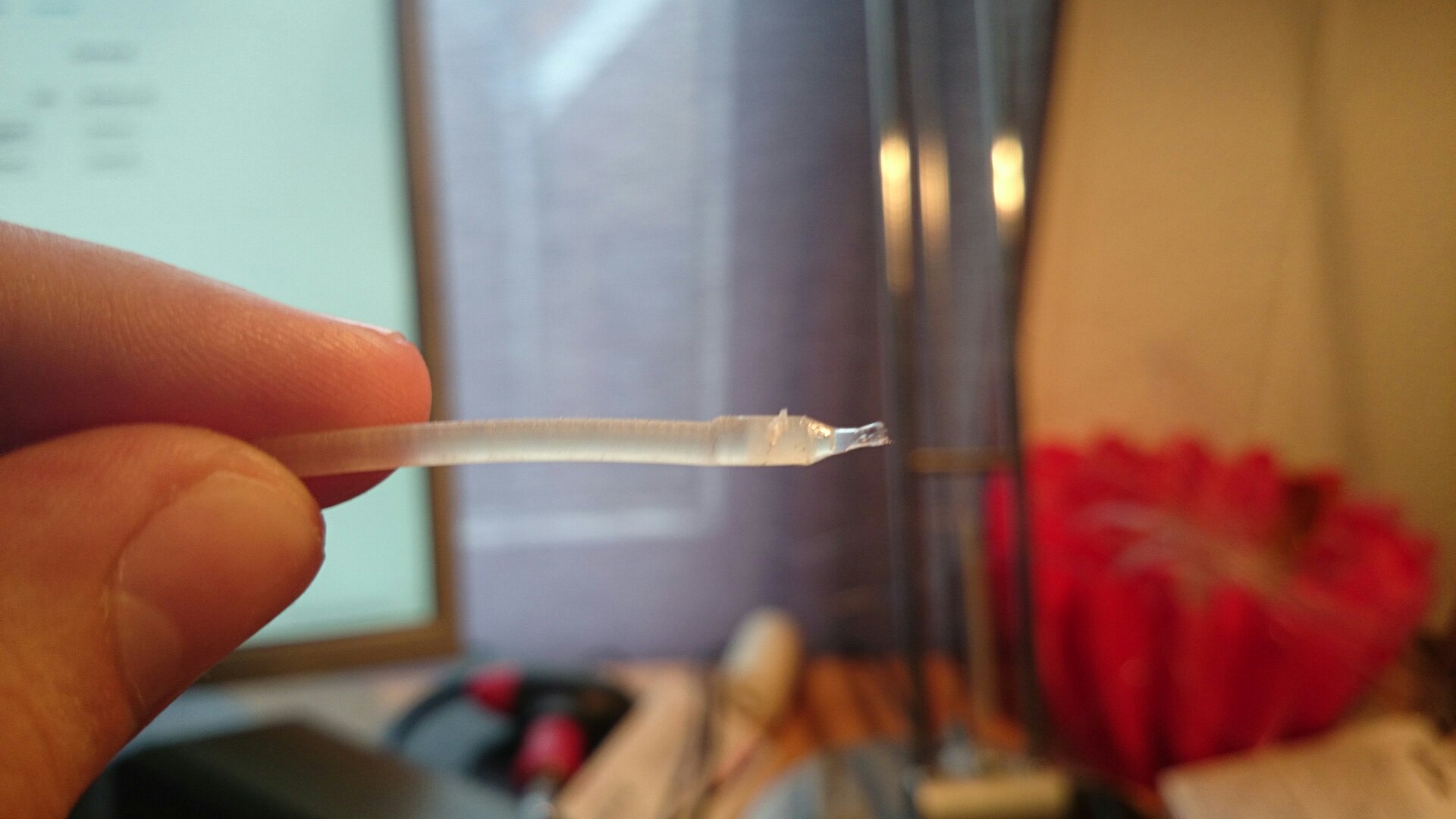

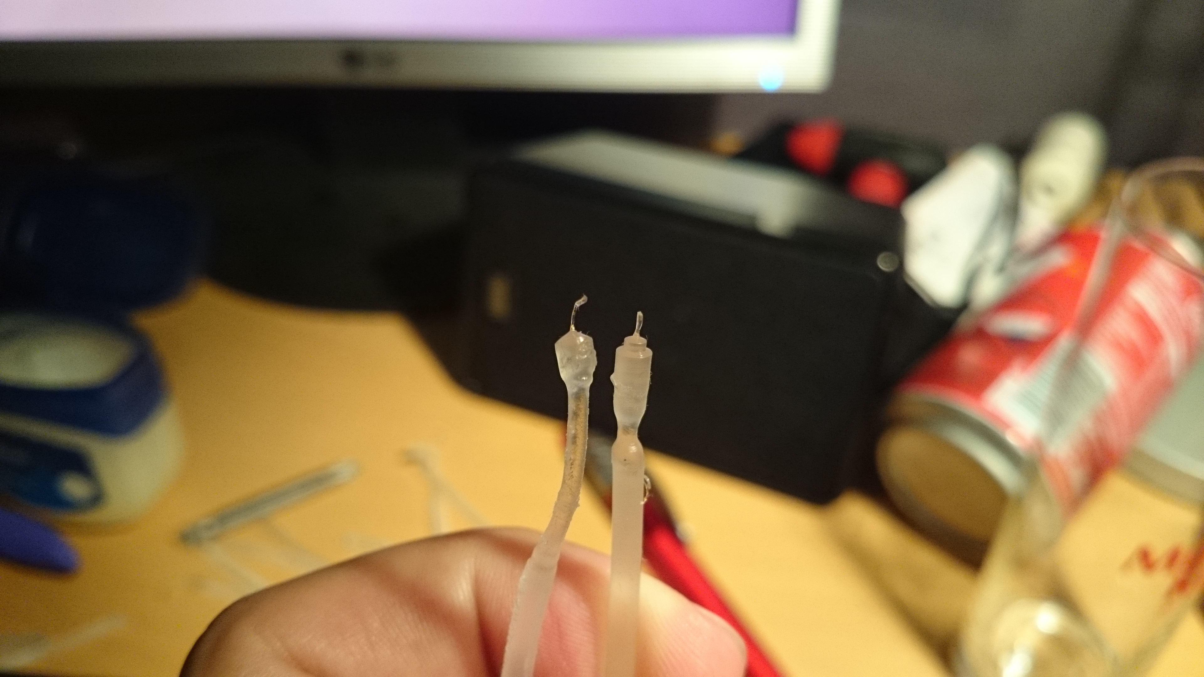

Re: E3D V4 All metal hotend
Another jam, printing at 210 degrees (10mm/s) constant extrusion, no retracts.
This is what it looks like when i retract the filament from the hotend.
- Posts: 800
That looks identical to all the filament I've pulled out - that little step there....
