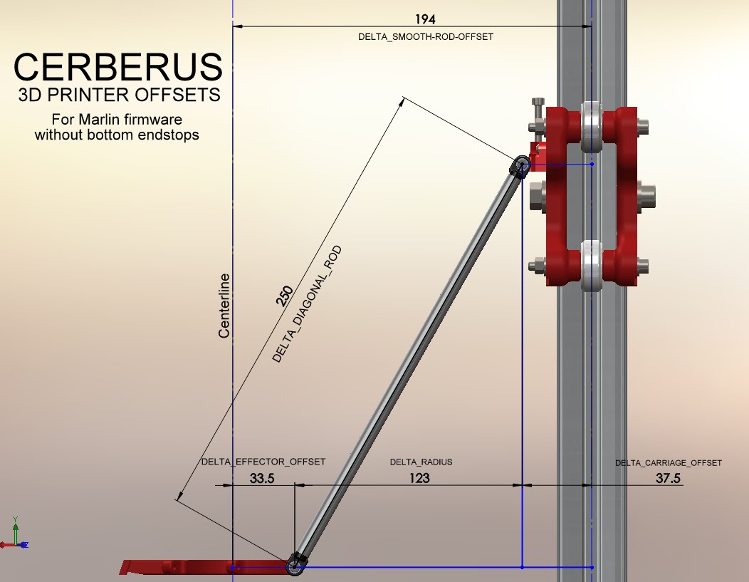

Here are the original constants from RepetierMAX.
Code: Select all
#define DELTA_DIAGONAL_ROD 269.0 // mm
#define END_EFFECTOR_HORIZONTAL_OFFSET 33
#define CARRIAGE_HORIZONTAL_OFFSET 35
#define PRINTER_RADIUS 198.25
#define DELTA_RADIUS (PRINTER_RADIUS-END_EFFECTOR_HORIZONTAL_OFFSET-CARRIAGE_HORIZONTAL_OFFSET+0.0)
And here's the canonical diagram. Marlin's DELTA_EFFECTOR_OFFSET is Repetier's END_EFFECTOR_HORIZONTAL_OFFSET, and Marlin's DELTA_SMOOTH_ROD_OFFSET is our PRINTER_RADIUS.
(Shamelessly stolen from somewhere on the Internet)
The Measurements
I measured DELTA_DIAGONAL_ROD at 270.029 mm, +0.104 mm, -0.335 mm. One of my arms was ~0.4 mm shorter than the others. If you discard that arm, the other five are all within 0.1 mm of one another.
END_EFFECTOR_HORIZONTAL_OFFSET came to 31.638 mm, ± about 0.1 mm.
CARRiAGE_HORIZONTAL_OFFSET is 37.970 mm ± 0.1 mm.
PRINTER_RADIUS I measured just above the bed and also just below the top. The average of all measurements came to 200.823 mm. The minimum was 200.741, and the max was 200.972, a difference of 0.231 mm. (These measurements should be accurate to about ±0.04 mm.) I have not yet used my alignment jig to square the towers up, but I will, and PRINTER_RADIUS will change slightly.
Using these numbers, DELTA_RADIUS is calculated at 131.216.
The two numbers that are actually used by Repetier firmware are DELTA_RADIUS and DELTA_DIAGONAL_ROD. DELTA_RADIUS is off by ~0.97 mm. DELTA_DIAGONAL_ROD is off by 1.03 mm.
My best calibration efforts without changing the firmware constants left me with the hot end about 0.2 mm lower in the center of the bed than at the edges. I honestly don't know whether the errors I measured would account for that -- I find it hard to reason about how changes in rod length and printer radius affect the delta warp.
Anyway, that's where I am. Suggestions welcome.

Following up on myself... Early this morning I wrote up all the facts, but didn't summarize.
Conclusion
The dimensions in the firmware are all wrong. Not drastically wrong, but they're all a little bit off.
  • Delta arm length: off by 1.0 mm.
  • Effector offset: off by 1.4 mm.
  • Carriage offset: off by 3.0 mm.
  • Printer radius: off by 2.6 mm.
That bugs me -- it indicates that SeeMeCNC was just hacking at it until it appeared to work. Either that or there are deeper reasons not to use the actual dimensions that I don't understand yet. Or maybe some sizes changed between the kickstarter generation and my May, 2013 kit. But still. How can they all be off by that much? Bad data for one or two dimensions would be understandable. Not good, but understandable.
And there is good news. The good news is that the errors all more or less cancel each other out. Delta radius, which is derived from the last three, is only 1.0 mm. That's 0.7% undersize. And the delta arm length is also undersize by 0.3%. So the overall misalignment is, uh, something smallish less than half a percent. (I am not going to do the trig right now.)
Of course, if you're trying to get a thin layer of plastic to adhere to the whole bed, you need much better accuracy than that.

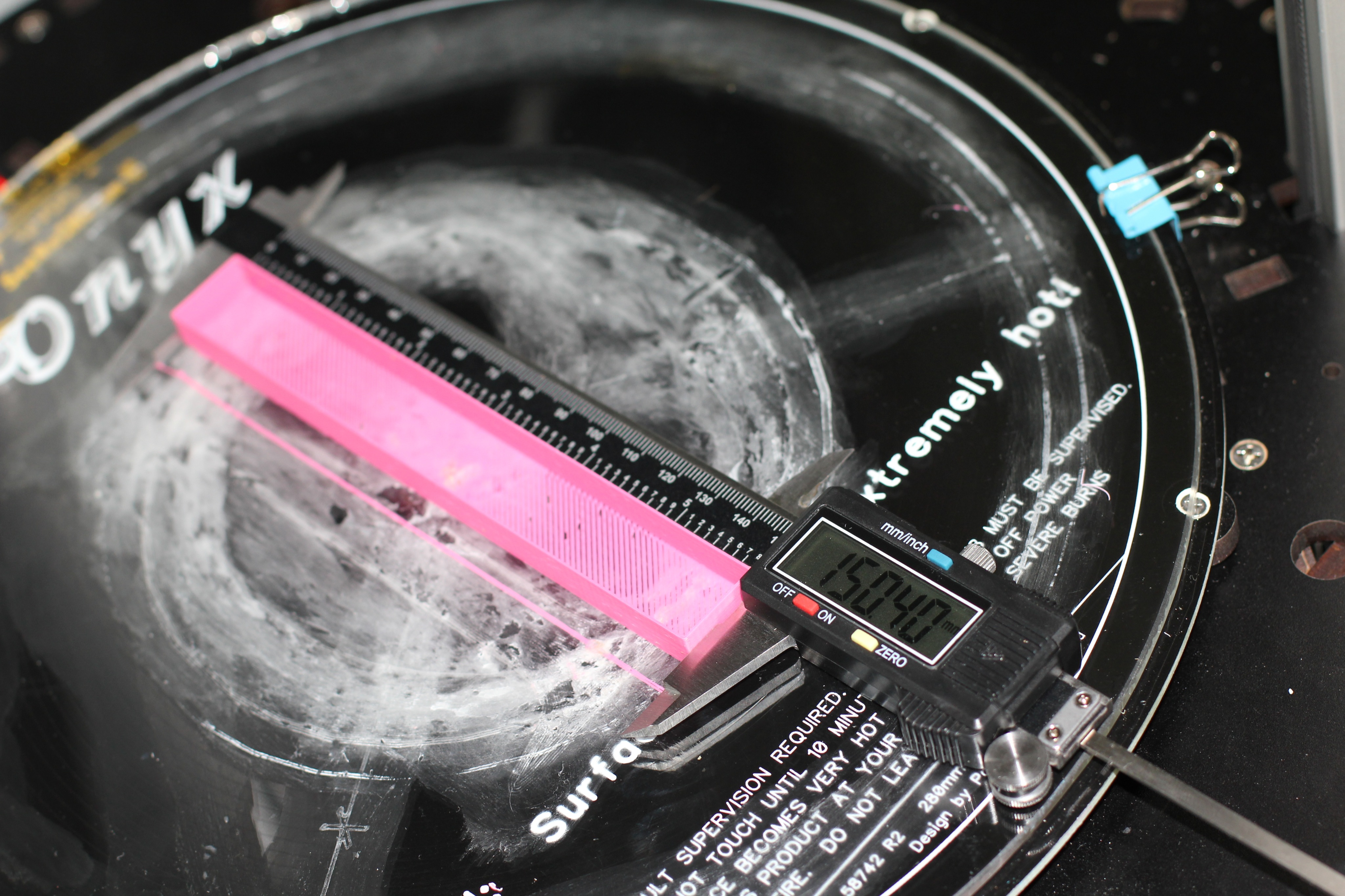

Here is the cube that I printed. It measures 20.00 mm across.

Calibration Results
Posted: Sat Aug 10, 2013 5:31 am
by kbob
ApacheXMD wrote:So your measured geometry values worked out well I presume? That hollow cube looks pretty good!
It looks like my last post about calibration was on July 18th. Between then and now, my printer has been inoperable most of the time for a bunch of reasons.
I measured the distance between each pair of towers both at the top and at the bottom. I picked the tower that was furthest away from the others as my reference. Then I squared that tower to the base. (It had been square once. But I've picked the printer up, transported it in the car, and generally manhandled it enough that it had gone out of square.)
Measuring distance between towers
Once that one was square, I locked it down and installed the triangular alignment jigs. One triangle went at the bottom and rested on the Onyx. The other triangle went at the top. It rested on some clothespin clamps, and the top assembly rested on it. The alignment jigs had to support the weight of the towers and the top piece, so I made sure they were clamped tightly enough.
Then I loosened the screws holding the other two towers (being careful that the alignment jigs prevented them moving vertically), and carefully adjusted the nuts on the threaded rod until all six triangle sides were exactly the same length, as measured using the above technique. Well, almost exactly. There is still 0.2 mm difference between the longest and shortest. Of course, re-tightening the screws changed the alignment, so there was a lot of trial and error.
Then I updated the dimensions in the firmware, installed the dial indicator and started testing. My dial indicator is not metric, so readings are in inches instead of mm. If I remember correctly, the first reading put the corners about 0.004" (0.1 mm) lower than the center. So after all this effort, I went back to tweaking PRINTER_RADIUS to find the value that works best. The best result was 0.675 mm less than the calculated value. With that done, I got the gauge to read the same number to within 0.0004 at all three corners and the center.
Here's a pro tip for bed calibrators.
The procedure in Gene's manual measures the corners 90 mm from the center. That was probably a good choice for the early adopters who had 8 inch square beds. But the Onyx is big enough to measure the actual corners. On my printer, the delta arms are vertical at 129 mm from the center. (129 ± 0.5. I wasn't real precise.) So I measured at X, Y = (0, +129), (+111.72, -64.5), and (-111.72, -64.5). Keeping the delta arms vertical improves resolution a little.
That's where I was on July 24th. Then stuff started breaking, and the printer did not run again until August 7th.
On the 7th, I set the absolute Z height. The dial indicator could only verify that the four points all had the same height, not that they were the right height for the hot end. I followed the usual procedure: heat the bed and hot end, move gradually down until a piece of paper drags, copy the calculated number into EEPROM.
Then I checked that the paper dragged at the corners. It was gratifying that the drag felt exactly the same in all four spots. I checked three times, partly to be sure, but partly to feel how nicely it repeated.
Then I printed a calibration cube. I'd switched to a new color of filament (Neon Purple from Toner), and needed to calibrate the extrusion rate. The second calibration cube is the one that measured 20.00 mm (+/- 0.02 mm) across. The walls are a tad thin on that one: 0.53-0.54 instead of 0.55. (photo)

Then I printed another calibration cube -- er, brick. This one was 20 by 150 mm. After the bed cooled, it measured just slightly oversize, 0.3%. (After I peeled it off the bed, it was too flimsy to measure.)
This caliper is neither substantial, alloy, nor from Birmingham.
So I'm happy. You can see that the printer is still not perfect, but it is a lot better than it was, and I bet it's better than the average working Rostock MAX.
