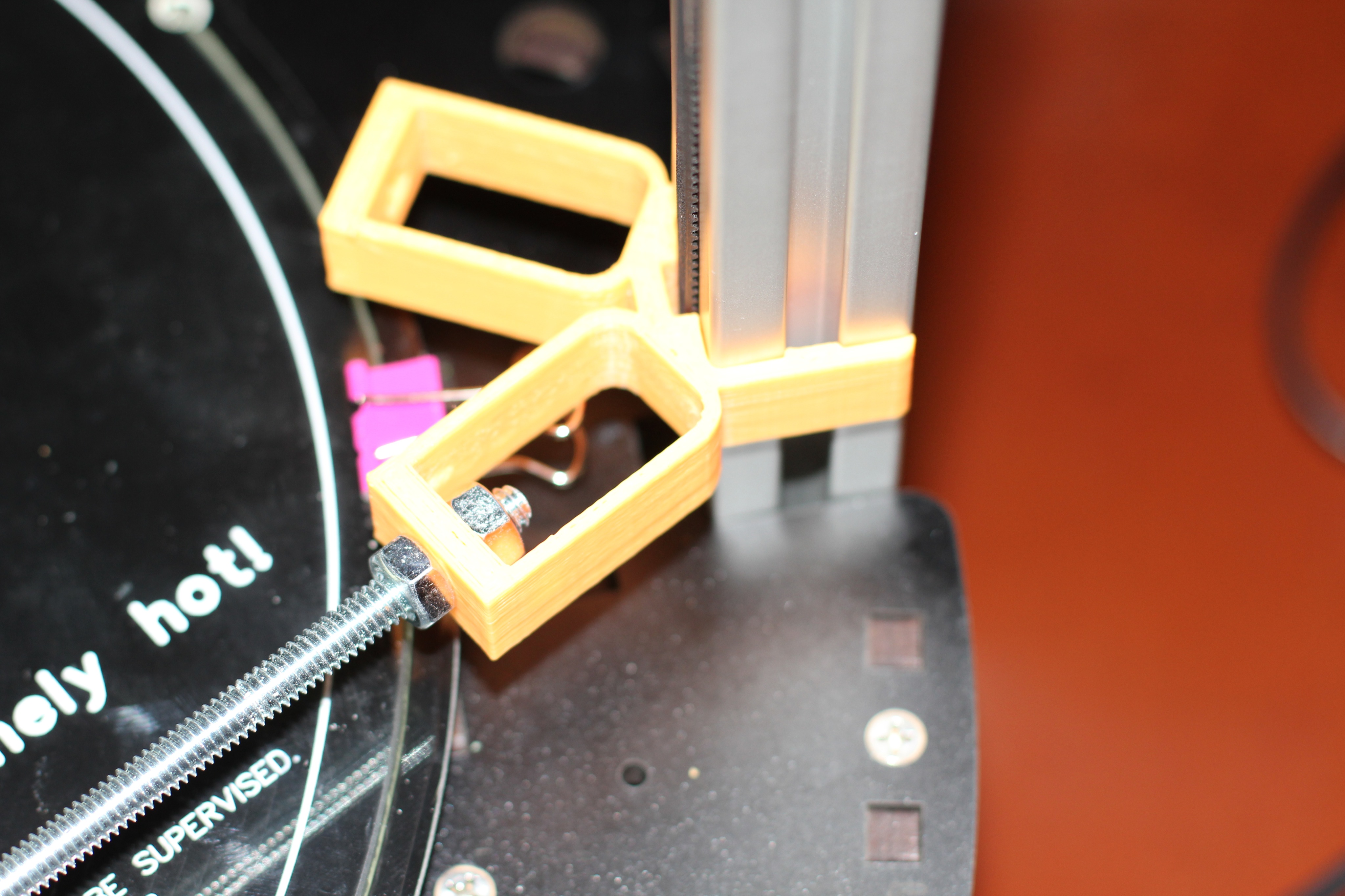

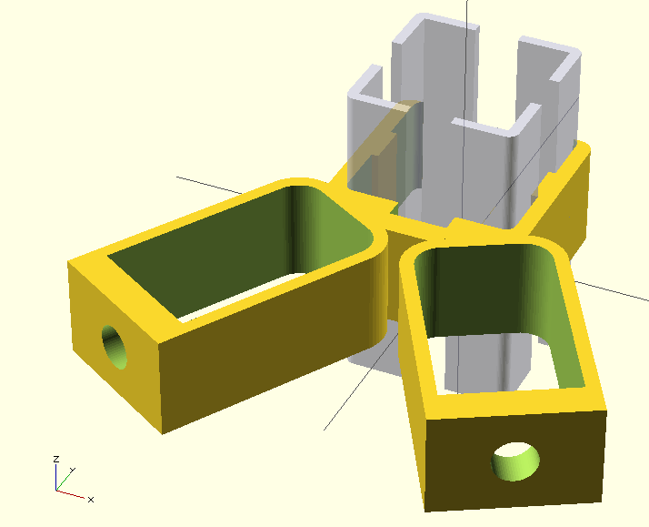

Tower Alignment Jig
Post by kbob »
I've been designing a jig to align the MAX's towers. I posted an OpenSCAD drawing of a draft version several days ago.
Here is the fifth iteration. It clamps onto the extrusion (lightly). It has a hole for a 1/4-20 threaded rod. With nuts on both ends, I should (in theory) be able to precisely adjust the distance between any two towers.
One brace/jig/clamp.
Here it is attached to two towers.
What were The Two Towers, anyway?  Minas Tirith and Barad-dûr?
Here's a closeup. There is a little tab that fits into the extrusion slot for alignment. You can see the two nuts that position it on the rod. The rod is pointed straight at the centerline of the extrusion.
Or Minas Morgul, maybe?  We're gonna need Three Towers.
The plan is to make a delta of these at the bottom, just above the table, and another delta at the top. Loosen the screws clamping the towers to the T-slot nuts, then carefully adjust the rods until the towers are exactly PRINTER_RADIUS (198.25 mm) from the center. Then I'll tighten the T-slot screws and remove these braces.
That is the plan. We know what happens to plans that contact the enemy.
Here are the OpenSCAD and .STL files.
Tower Brace v5.scad
Tower Brace v5.scad
(4.08 KiB) Downloaded 1101 times
Tower Brace v5.stl
Tower Brace v5.stl
(234.54 KiB) Downloaded 1013 times

Re: Tower Alignment Jig
Post by 626Pilot »
kbob wrote:I've been designing a jig to align the MAX's towers.
This is great. I was thinking of doing something similar last night.
Post by kbob »
You're welcome to start with my design. I made six clamps. I got some 1/4-20 threaded rod at Home Depot and cut it to 10" lengths. I haven't done the alignment yet because I found out I'll have to re-measure everything.
