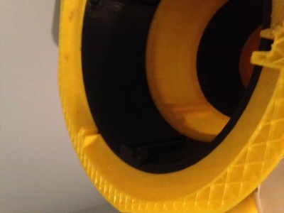

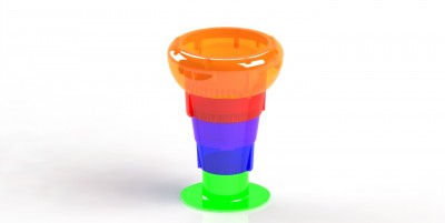

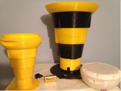

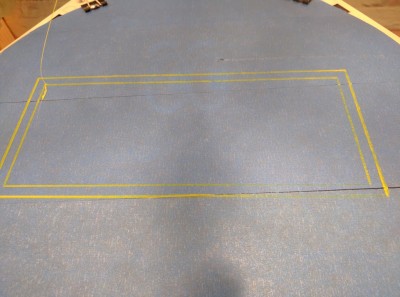

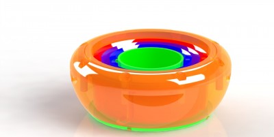

Re: OpenDACT(Delta Automatic Calibration Tool) - For Repetie
I've been asking help pretty frequently on this form and you guys have been really generous with it.
And now, I'm about to ask for more. But first, I thought I'd share what it's all about, in case one or two of you guys would find it interesting, and a reason
why it's worth your time.
My whole reason for building the Rostock was to print a full-scale prototype of something I invented - a patent-pending telescoping musical drum, with a
maximum 10.73" diameter, comprised of 7 rings. Pictures at bottom.
The idea is to print a full scale prototype to test for functionality, and pursue crowd funding. The final product will be made of colored and/or uncolored transparent copolyester and should look pretty freakin' cool.
Unfortunately, printing at the edge has been and remains a huge challenge - I've yet to succeed with the last and widest components.
I was thinking OpenDACT would be the answer, but was not able to get it working, and must
give up on it till I can get access to another windows computer.
Meantime, I'd like to go back to the HTML tool. But so far I have not been able to get a tight enough calibration with it.
My questions are,
1) would it be feasible to reconfigure the probe algorithm to take measurements all the way out near the white line?
2) If so, would those measurments be useful to the HTML tool in its current form?
3) If not, would it be feasible to rejigger the HTML tool to work with them?
If you think this project looks cool and you'd like to help me get over this many-months-long hurdle, I'd greatly appreciate your continued input.
