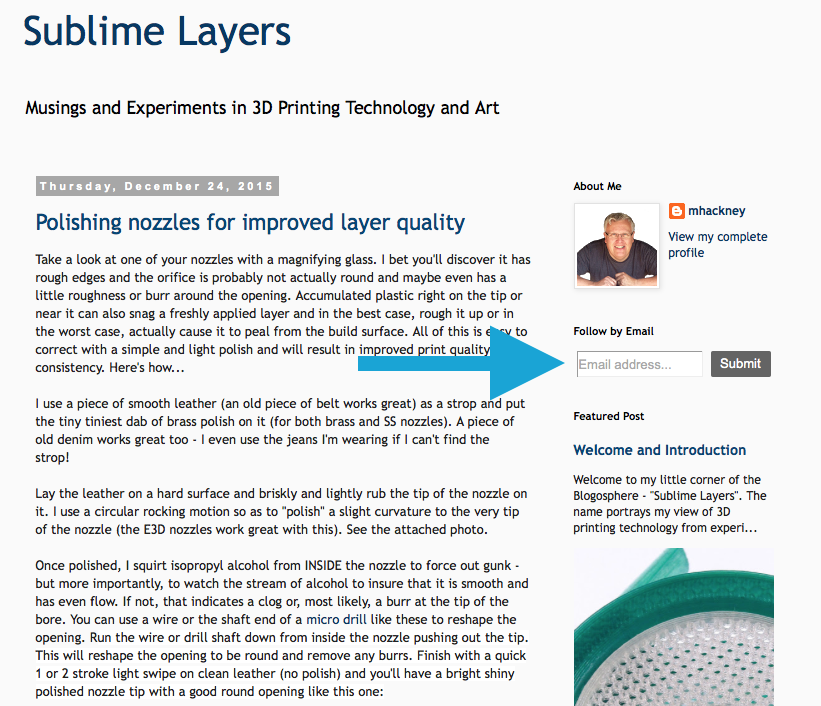

Re: Mhackney's Rostock Max
You can subscribe and get updates when I publish something new (like this morning). There is an email subscription link on the right sidebar and a feed subscription at the bottom of the page.
Thanks for the font feedback, I wondered about that. I am changing it now, let me know what you think.
