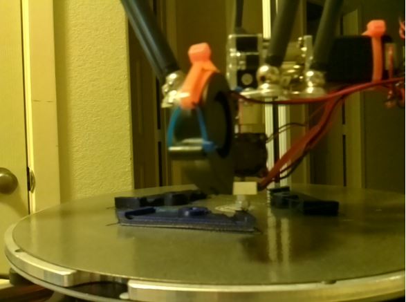

Should I design something fancier or stick with my getto zip tied layer fan...

What does your effector look like? I have the full size berrybot effector and made some fan holders that work with the holes.
I've attached an STL that has two parts in one -- you'll have to separate the shells using meshmixer or the like.

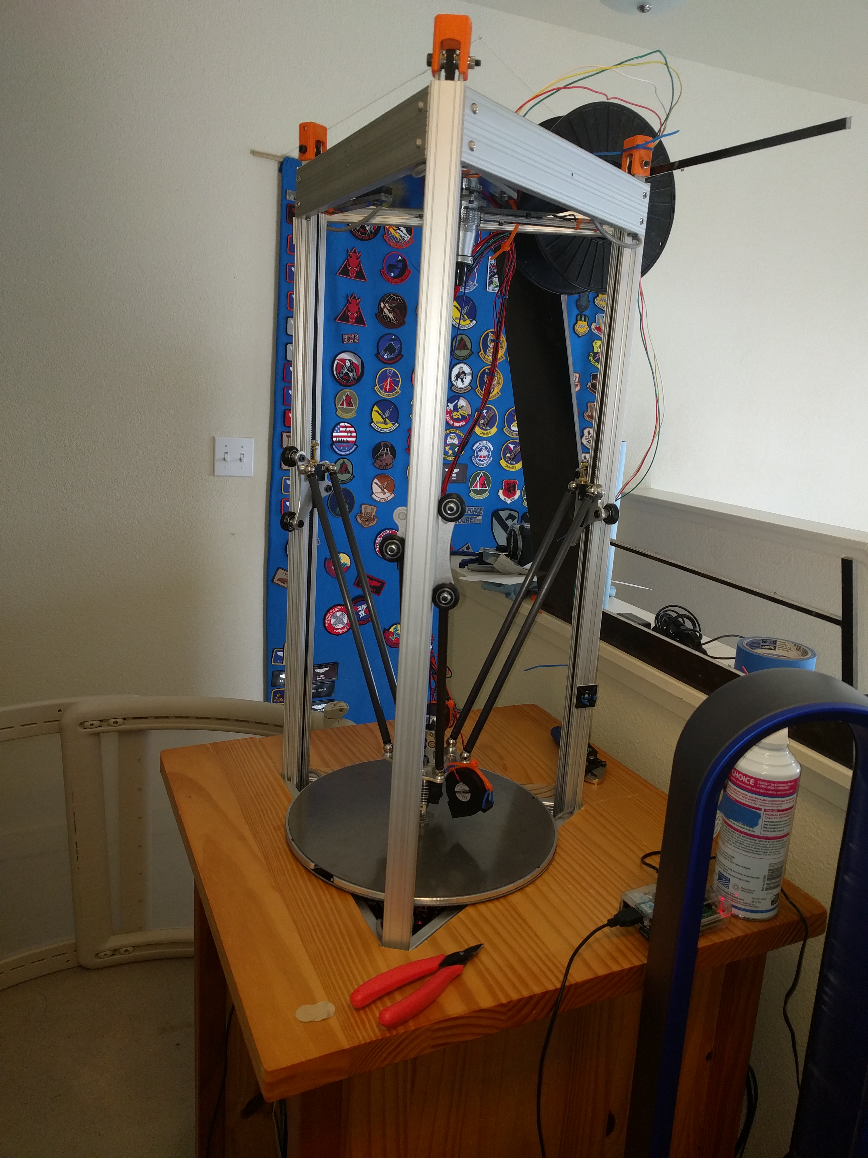

Still need to build an enclosure for ur, but overall it's coming along nicely. The table top is held on by magnets so it's easy access to get in to work on things

There is also no place that the printer actually touches the wood. It's connected to a phenolic that is good for high heat and electrical uses

Aflac, what size arms did you use if you remember?

Eaglezsoar wrote:Aflac, what size arms did you use if you remember?
330.77mm

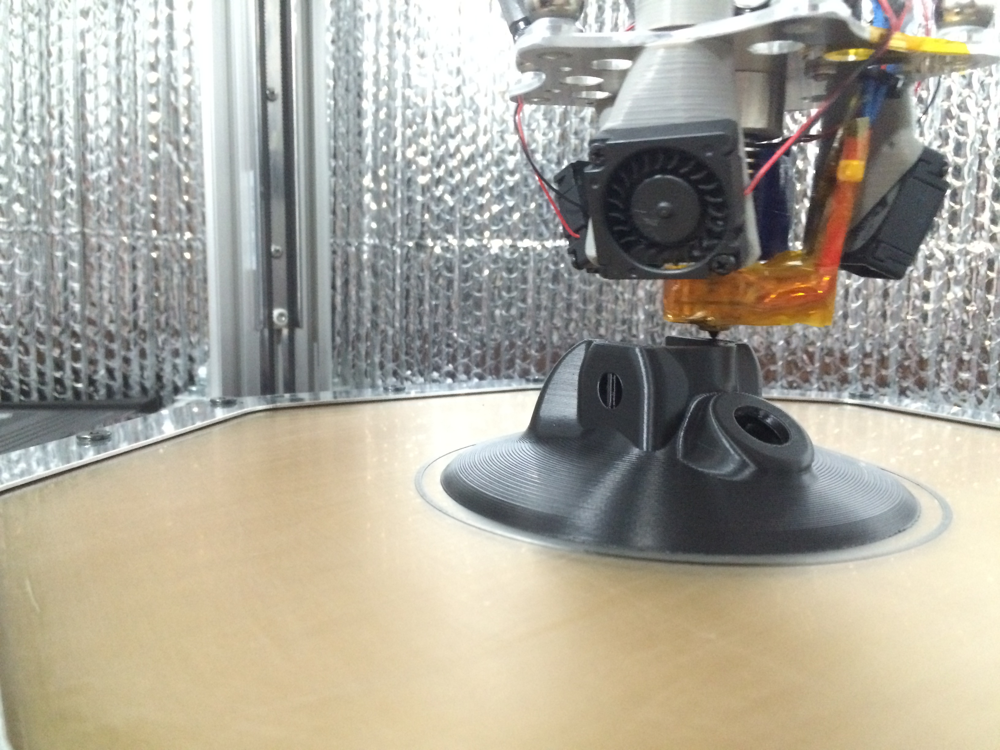

Ok, time for my next problem.
I have the prints printing beautifully....unless I need retraction. For some reason Emmett time it retracts it had a delay before it starts extending again, leaving a gap. Sometimes the delay is really short, sometimes it's fairly long. In a 50mm radius circle it's sometimes not extending for the first halfway around the circle. And it is not a consistent amount.
It's almost like the extruder is losing steps on the extend after the retract, after it starts again it works just fine until the next retract.
Anyone have any ideas?

Eaglezsoar wrote:What is the length of retraction and speed of retraction that you are using?
I am using CURA to slice and the retraction settings i can find are only min travel combing min extrusion and z hop, i can not find anything about retraction distance nor speed. so i have no idea what the answer to that would be. I dont see anything in my config file about it either.

mhackney wrote:On the Advanced Tab there is a Retraction panel near the top with Speed, Distance. Those are them.
wow, no idea how i missed that, i only looked at that tab like 40 times. but there it is right at the top. its set to 40 mm/s and 4.5mm retraction, should i try shorter and slower?

Post by Aflac »
i changed it to 20 and 1, its still doing it, however the distance of the gap is a lot less now.
