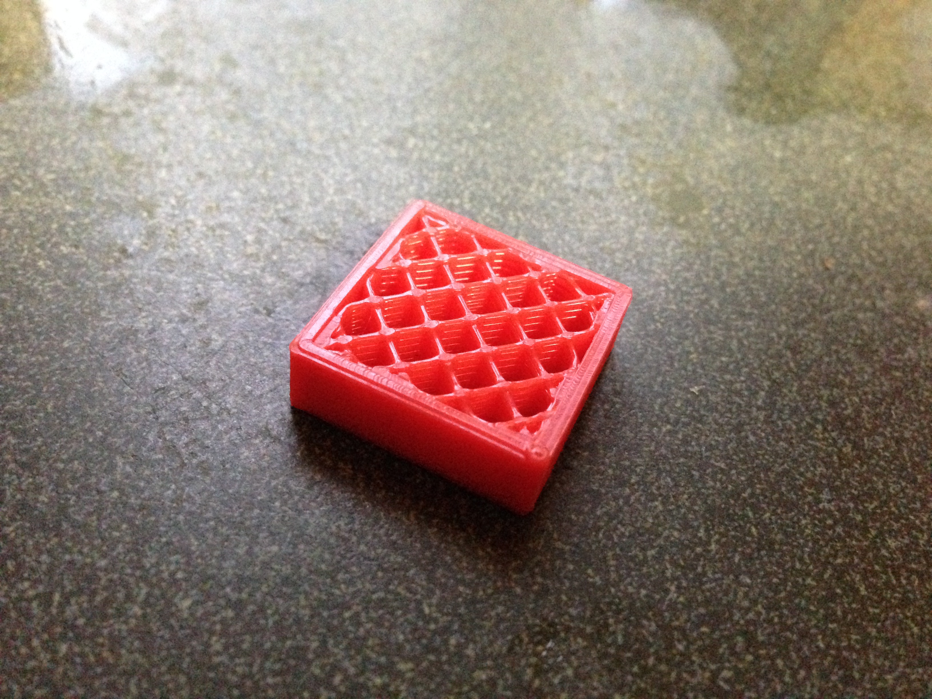

I did print a calibration cube with S3D and the infill wasn't as strong as what matter control produces. If I figure out the right settings for that I'll post them.
Re: Broke down and bought a license...
The infill extrusion width needs to be cranked up as high as 200%
Yeah the 200% infill width is a neat trick. Kinda weird at first, when you think about it, but in practice it is great. It lays down a double thick line of infill on the first layer, and then all the other layers are extruded at double height. Because of the nature of FDM, the printer doesn't actually distinguish between extrusion width or layer height, that is simply a function of the distance of the nozzle from the substrate. I'm definitely a fan of the infill, now. I wonder if the same technique could be used with a triangular infill pattern, by setting the infill angles to be that of a triangle and setting the width to 300% (Can you set it to 300?) edit: yes. yes you can. glorious.

with the 200% setting, the infill turns out strong.
the nice part of the simpler infill is faster print speed compared to matter control's default triangle setting. I attached a picture of the calibration cube.
