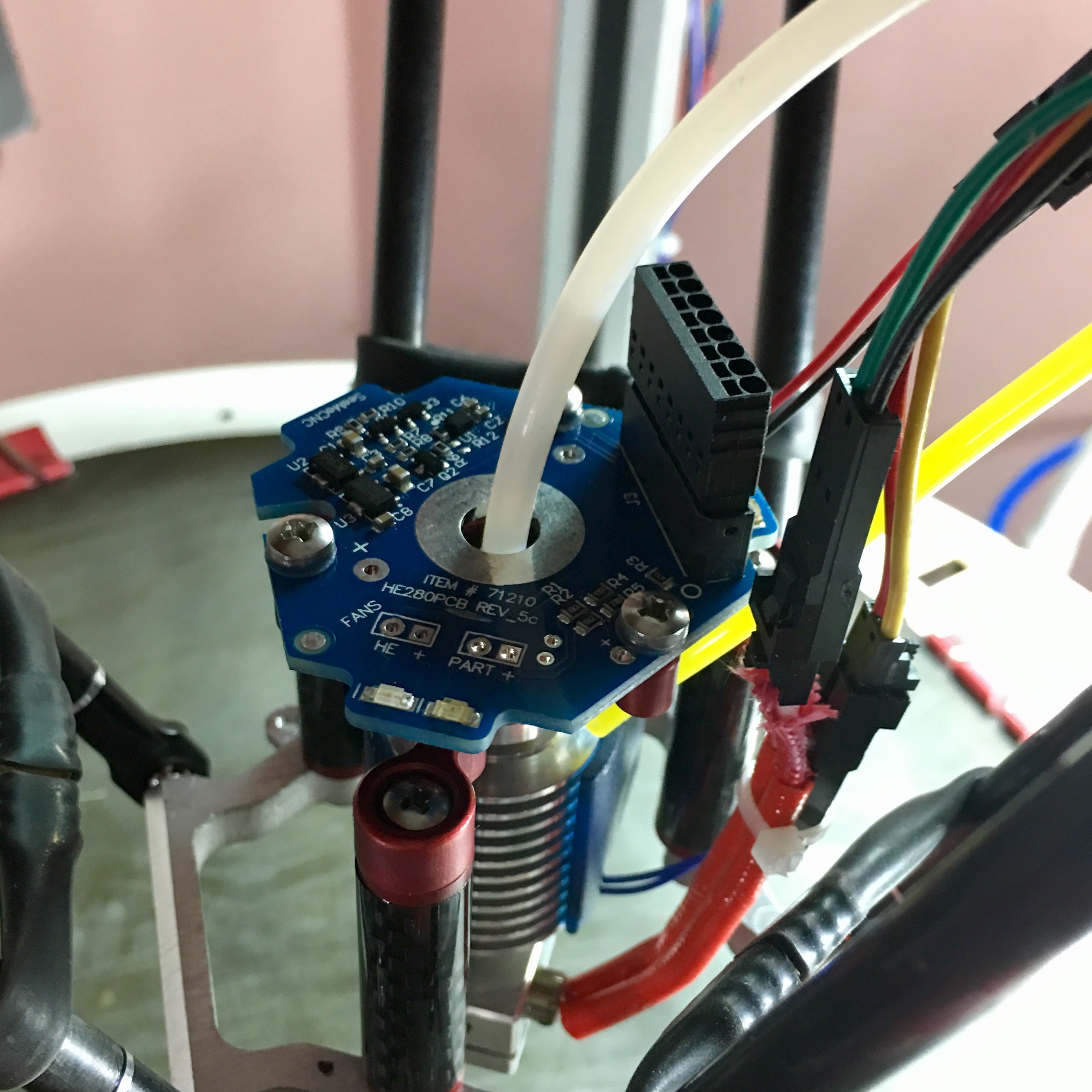

Here is the overview on the board and how I think it should attach and operate. I have a couple of alternative ideas for the processing etc depending on costs and whether an ATTiny85 can handle both 3.3 and 5V. If not, perhaps two different boards could be produced simply populating the proper ATTiny. Or a regulator could be added. These are the types of questions that need to be answered in the next phase of the prototype.

More progress, I have the interface talking to Duet! I have the interface hooked up to the E0 endstop connector in Duet. I can trigger the probe and I see the Duet LED flick off then on. The only issue is that the Duet end stops are 3.3V and the pin output from the Arduino Micro is 5V. I don't want to risk frying my Duet so I'm not going to do any more testing until I sort that out.
I do have a 3.3V trinket that supports I2C. I used it for my accelerometer experimenting last year. It should be easy to port my now working code over to it and test. If I can get it to work, it is actually small enough that I could mount it on one of my printers and test it actually working. There are some very small ATTiny85 based boards on the market and they have everything I need to do this, they just don't have the form factor to plug into the HE280 connector. But, maybe an off the shelf, inexpensive, option where you simply splice one of these ATTiny85 boards into the 3 wires coming from the whip would be a good short term and functional option. And it could be reprogrammed by the customer if I make tweaks to the firmware. Any thoughts on this?

I've been doing a little more investigation. The ATTiny85 processor supports 2.7 to 5.5V operating voltage. It comes in an 8 pin DIP and a surface mount option. The 8pin DIP version would be very easy to prototype so I've ordered a couple and a programmer (arriving Sunday).
With this chip, I can make up a few "splice in the whip" prototypes to send out to a few folks to test and it is very small.

So I have the proof of concept working on my bench. The HE280 is interfaced to Duet (an 0.8.5) as a three wire endstop on E0. I tap the HE280 and the probe captures it, relays it to my Arduino Micro where I process the signal and output the probe event to the Duet. Duet sees the probe tap and would act accordingly if it were controlling a printer!
The next step is to get everything installed on my V1 to actually test probing. I do have a little wrinkle in that I'm using an Arduino Micro on my testbed and it is not suitable to use on the machine. I have some ATTiny85s on the way and can program and connect one of these easily. I'm not using the HE280 on this machine to power the hotend and fans since this is a test. So I need to run 12V power to the HE280 as well as the 3 lines I need to mimic an end stop. I'll have all the wiring installed and ready to go when the chips arrive.

Most of the arduino chips will operate on 3.3V. Of course, the I2C signals from the HE280 are 5V based, ironically having been level-shifted from 3.3V.

Thanks Eric, yes the wires can be removed safely from the connector so the connector can be reused. I've done it a few dozen times already.

As far as "universal" board mounting, I think a single 4 MM hole in board at one corner would work in most situations. You simply sandwich board under one of the stand-off screws.
Or possibly a single ear tab may provide cleaner mounting options?
Re: Interfacing to the new HE280 accelerometer...
Brian, I might be concerned about the spring board effect when probing with that. In fact, that's basically how mechanical accelerometers work - a strip of stiff material is fastened at one end and the deflection is measured at the other end.

Position the accelerometer chip near the mounting hole.

I had mounted my test last year vertically so I was actually using the Y axis oriented in Z.
