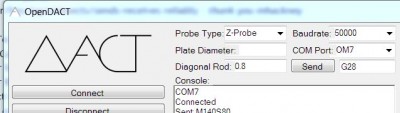

OpenDACT Version 3.1.0A
Version 3.1.0A - Timing fixes, calibration fixes, tons more
Changes:
-The program now utilizes responses from the printer to initiate the next step of the height map generating process.
-Also, the calibration algorithm is ran on a separate thread than the reading thread. This prevents the printer console from being locked up.
-There is also a manual calibration included on the third tab of the advanced area - which utilizes the same exact algorithm as the automatic calibration.
-Slight changes to the calibration control flow, the steps per mm is now corrected afterward. This reduces the error between the horizontal radius changes and the steps per millimeter.
-Heuristic mode fixes
-Disconnection fixes
-Stop button for calibration
-Basic mode is now fully iterative
From default settings on my printer, I got a successful calibration in 3 iterations. After randomizing values (tower offsets, horizontal radius, alpha rotation), I had a successful calibration after 9 iterations - would be faster if heuristic was enabled.

So I ran OpenDACT (current as of 01/30/16) on Red Sonja (v1) after installing the FSR mod. After 121 iterations it still hadn't come up with a solution. When clicking "Stop" the application freezes after homing the machine. The only way to get out of it is to end-task it.
Suggestions?
Suggestions?

Well I am going to assume that this is because the program is using the default parameters for the V2 i.e. the SPM percent correction/change, horizontal radius change, alpha rotation correction, and tower offset correction values. These are all printer specific, so try to flip the heuristic mode to true. Before I did this my printer took ~40-50 iterations, now it takes around 5-15. I haven't used this function in a while though, so hopefully I didn't break it along the way. If it doesn't work properly let me know and I will look at it later today! Also for the stop button, there must be commands in the buffer that are causing the program to get upset - I will look into this as well.geneb wrote:So I ran OpenDACT (current as of 01/30/16) on Red Sonja (v1) after installing the FSR mod. After 121 iterations it still hadn't come up with a solution. When clicking "Stop" the application freezes after homing the machine. The only way to get out of it is to end-task it.
Suggestions?
Re: OpenDACT(Delta Automatic Calibration Tool) - For Repetie
The only setting I changed from the defaults were the arm length (to 290.8). RS has got the new carriages and ball-socket arms so it's very tight.
In a prior run I tried Heuristic mode (I set the dropdown to "true") and it ran for a while and then apparently decided to go back to "normal" mode as the Heuristic setting was flipped back to "false".
I was unable to take a screen shot of the Accuracy pane since it froze. When I try it again, I'll take a screenshot before I stop it.
The best result I ever noticed was x, y, and z at .01, and a, b, and c were around .03-.09.

Yes, in the heuristic mode it will figure out the parameters of your printer then once that step is complete it will perform a normal calibration.geneb wrote:The only setting I changed from the defaults were the arm length (to 290.8). RS has got the new carriages and ball-socket arms so it's very tight.
Steps in the calibration(~ -> approximately equal):
0. If heuristic mode = true, then check how much each value changes when increased by a set amount. Else: 1
1. Checks if the X ~ Y ~ Z, if no then calibrates offsets again. Also, if it can't calibrate it will adjust the horizontal radius so it can. This will throw off every height on the next measurement. Else: 2
2. Checks if XO ~ YO ~ ZO, if no then calibrates alpha rotation. Else: 3
3. Checks if (XO ~ YO ~ ZO) ~ (X ~ Y ~ Z), if no then calibrates the steps per millimeter. Else: 4
4. Checks if (XO ~ YO ~ ZO ~ X ~ Y ~ Z) ~ 0, if no then calibrates the horizontal radius. Else: Calibration Complete

Anyone have openDACT working with Repetier firmware 0.92.X? Ever since I updated Repetier firmware to 0.92.8, openDACT can't read in EEPROM values. It will function for what seems to be a random amount of time and then enters an endless "Resend:####" "ok" loop that begins with "Error: Missing linenumber", then freezes when I attempt to reset or disconnect. At one point I noticed in Repetier Host that a few of the EEPROM values (XYZ steps per mm, Z max height, etc) got erased after running openDACT. I ensured that baud rates match.
Update: I also noticed occasionally in Repetier Host when updating EEPROM values I will get "Error: Missing linenumber", "Resend: ####". Perhaps my problem involves the USB connection?
If your computer does not have US number format, it can be the issue.
I do have Opendact working with repetier 0.92.8, I had no more problems to get it working than the number formating.

Thanks - I verified in Control Panel that Windows 7 is already using US English number format.

Just completed an 11 iteration calibration in heuristic mode after clearing the EEPROM, cycling power, then reloading the firmware. However, every time Repetier Host 1.6.0 is even just connected (and disconnected) first, OpenDACT will have the missing linenumber error. The printer power then has to be cycled for it to work again.
