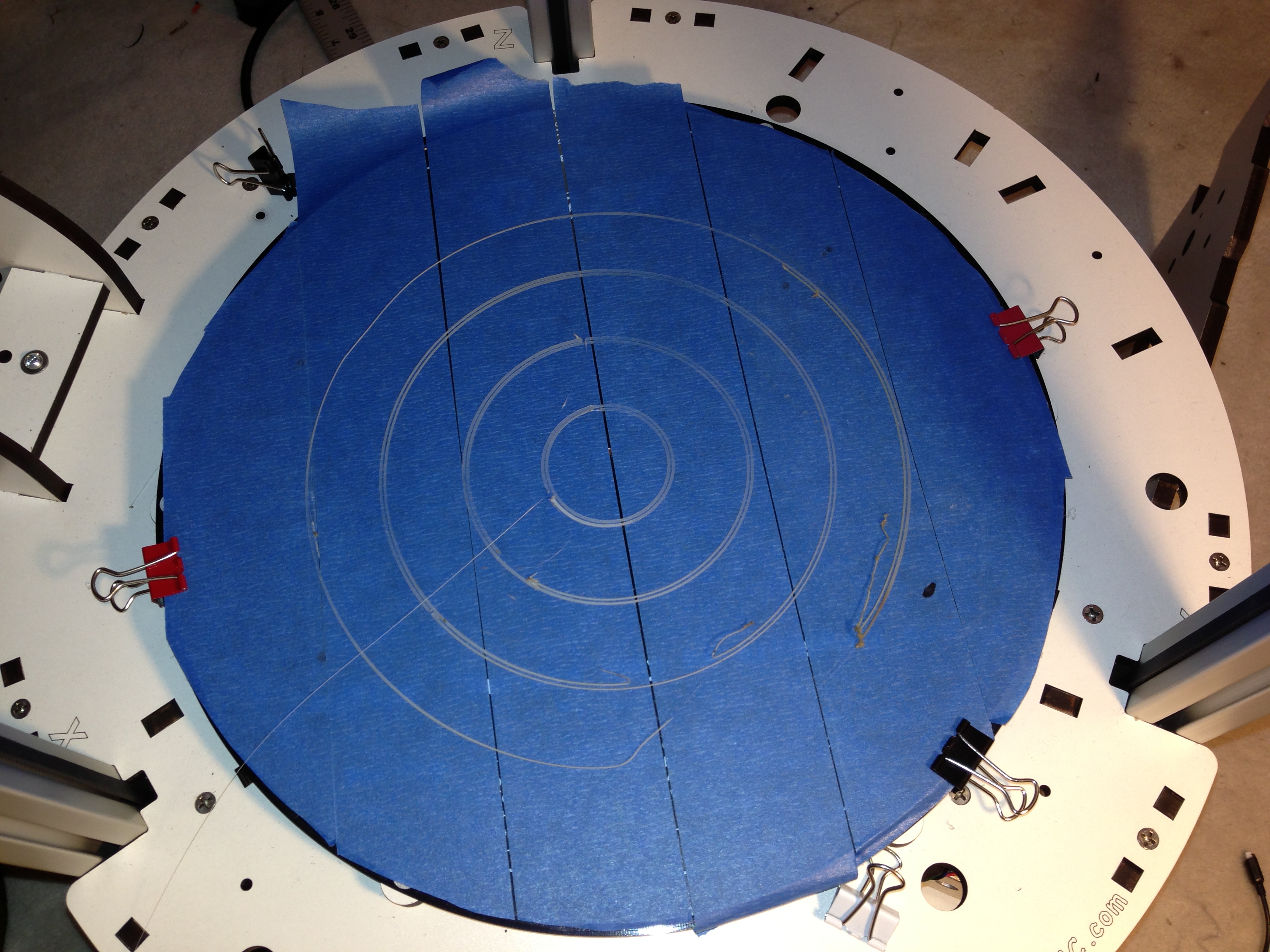

did a quick reprint. did not make any changes just homed the axis and printed
Checking for consistence.
Printed another that looked just like this.
As anyone printed something like this before to check the flatness of the bed. I am interested in seeing some other results.
Re: First 3D Printer Build
Posted: Wed Apr 03, 2013 9:31 pm
by Polygonhell
Honestly that last one doesn't look very far off o me, I'd say in general your 0 is a little high, possibly a little higher on the outside than the inside but I don't notice any gross errors.
If you're having issues with repeatability of the endstops, move the switches so that the screw head hits closer to the button.

Looks much more like missing steps than backlash to me.
I can't tell is the print vertical before the obvious shift?
