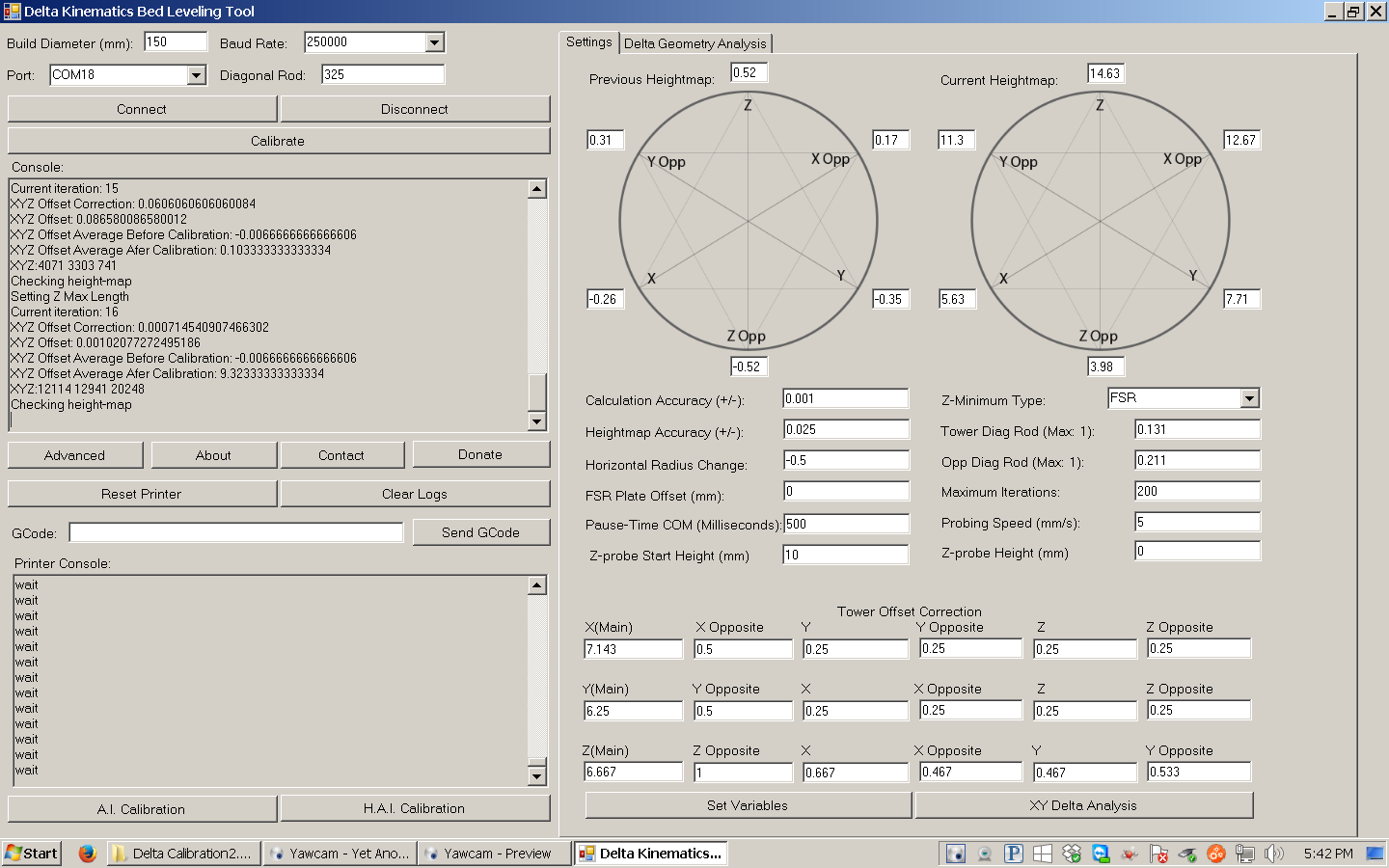

				It seems like it's working about the same. hasnt given any crazy numbers yet though. I have my webcam set up so you can see the console and printer if you wish, i have to do some chores around the house.
Tinyurl.com/printerviewer3
EDIT
eek it was going good, luckily i was in the room when it decided to crash, it went down 6 inches, almost back up to home, then HA-ZAAA into the plate. this is a screengrab

				CaptainMerica wrote:It seems like it's working about the same. hasnt given any crazy numbers yet though. I have my webcam set up so you can see the console and printer if you wish, i have to do some chores around the house.
EDIT
Well, your tower offsets are about 5 times what they should be in the first column. Why may you ask? Not the slightest - this is a first. However, it definitely is caused by increasingly bad XYZ offset values - impart from the left column of the Tower correction. I would recommend using the default values for the time being, it will just take longer to calibrate. (I will have a new version up tonight - will work a lot better)

				by CaptainMerica
				hmm. How do those tower offset values get adjusted like that? I didnt touch them at all, i will retry it with a fresh open of the app.
				Re: OpenDACT(Delta Automatic Calibration Tool) - For Repetie
				Posted: Fri Oct 30, 2015 7:28 pm
				by RollieRowland
				CaptainMerica wrote:hmm. How do those tower offset values get adjusted like that? I didnt touch them at all, i will retry it with a fresh open of the app.
Those are adjusted in the AI and HAI calibration modes

				by CaptainMerica
				ah, gotcha. I reset everything and am currently running the standard calibration. so far so good.
edit. nope. same thing. screen grab below. I think i'll just wait and try later haha.
