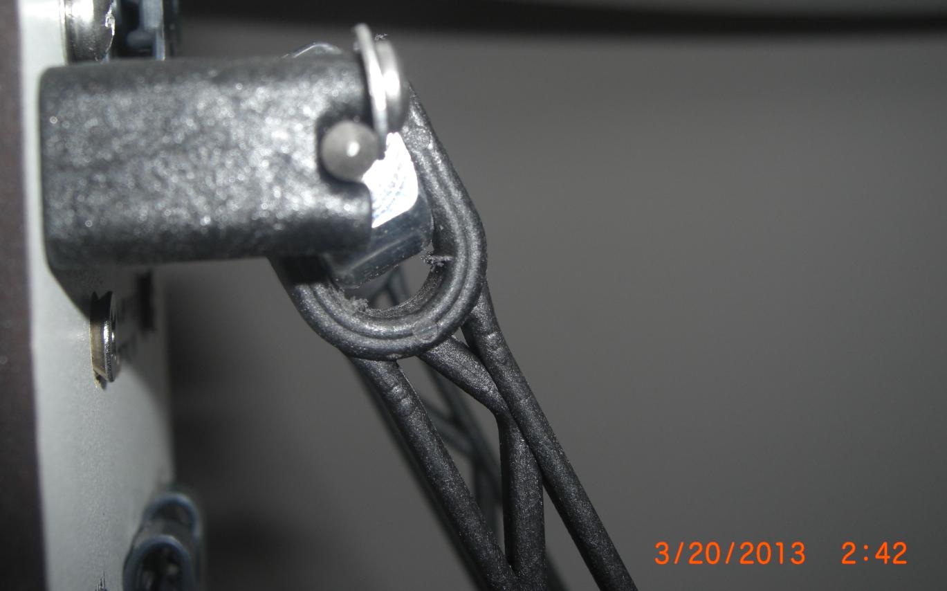

to keep progress moving along I continued work on the hot end and the ujoints for that area. The assembly of the hot end ujoints actually went a lot faster then the cheap skate ujoints. Seemed like the hot end ujoints were a lot easier to sand and didn't require to much effort. Assembled the hot end tonight. took some pointers from the forum and used teflon tubing to insulate the thermistor and the resistor wires. Then laid a layer of high temp rtv on it. I wasn't going to use the rtv originally but it was about the only thing I could get locally so rtv it was. I'm still trying to get a hold of some resbond 920 to use later.

more work done today getting the rostock arms installed. This required an insane amount of sanding for a smooth fit. I can't tell you how many times I had to install, remove, sand and reinstall to check fit. definitely not installer friendly, I got to a point where I said enough was enough and just left them alone, I still think they could use more sanding for better, smoother motion. I started around noon and 3 hours later here's the result.
The hardware for my adjustable bed leveling idea came in today. Its nice to have mcmastercarr close by. I ordered the parts last night and they were here today.
more to come on this implementation, hopefully fixes my uneven rostock frame.
