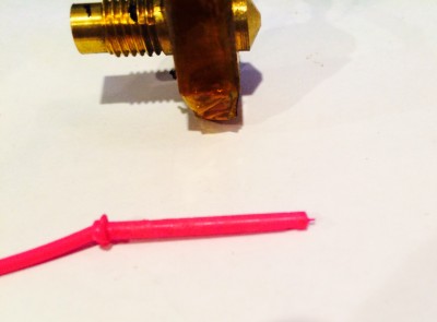

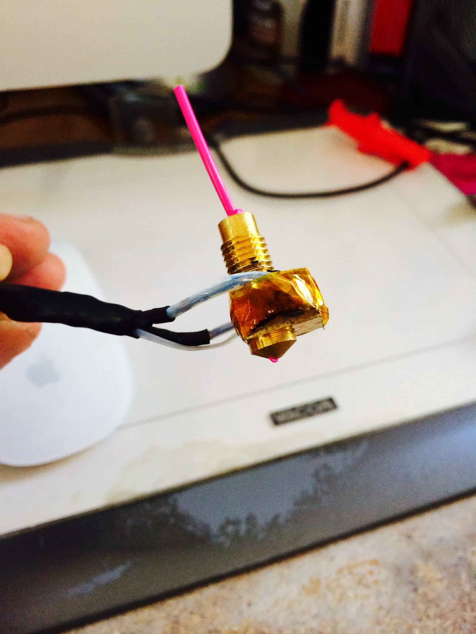

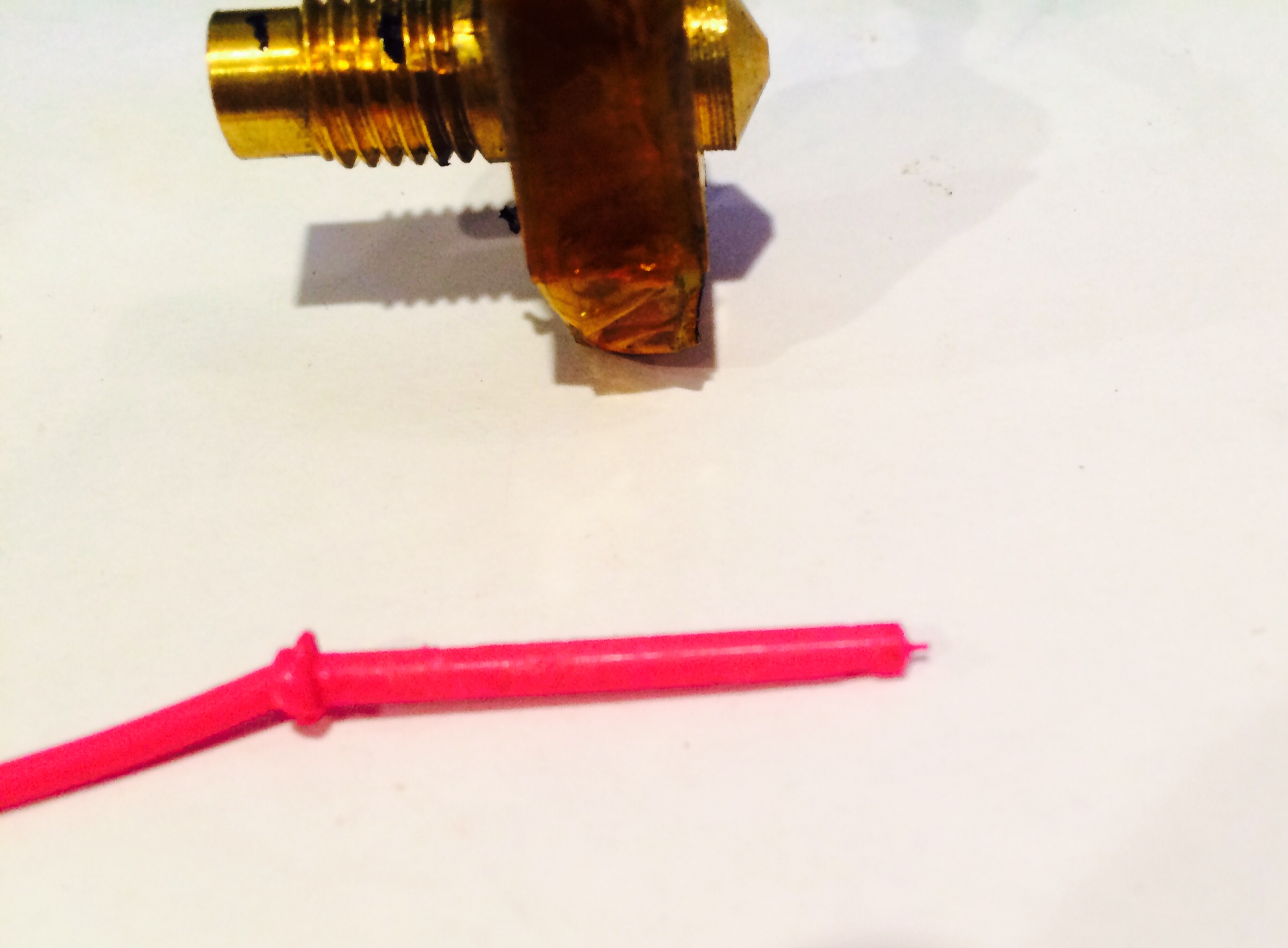

I understand (and experience) your frustration. The Kraken has the same basic mechanical setup as the E3D (I have both) but with water cooling. I find it is less prone to PLA jamming but just when I have it dialed in, printing reliably and very nicely, odd filament starving issues pop up once again. I've slowed down, sped up, increased temps, decreased temps, polished, deburred, scrutinized, dissected, injected, rejected, ... you get the point (with a tip of the hat to Arlo Guthrie). I've not had a single jam with ABS with these hot ends.
I've also experienced the filament chewing phenomenon and worked on the extruder end of things - cooling fan on the driver, tuning the current setting, debarring the sharp knobbed gear, etc. Each time I do something things seem really good for a while. And when I say good, I mean the best PLA parts I've ever printed.
Just yesterday, after reliably printing dozens of parts, things started going astray again (filament starving). I thought I had addressed and at least thought about all of the problem possibilities and even combined, this is still occurring. Once I get into this state, I disassemble the hot end, clean, ream and reassemble and am good to go - for awhile. It is nearly impossible to determine where the issue is occurring and I've tried to look at the bore with a scope, the filament itself when I remove it, etc.
I am starting to suspect and think about the heat break geometry or nozzle itself. I do not think the brass-SS joint is at fault in my situation. I've polished both ends (the brass nozzle and SS heat break), assembled at 300°C and when I disassemble and look later this joint is mirror like with no evidence of leaking.

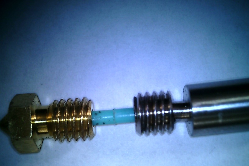

While I was writing this I was able to pull a complete filament out of a "jammed" hot end (Kraken) by chilling it down. This is a deburred and polished heat break and had been printing well for over a week (LOTS of parts). I used my little USB microscope to scrutinize things and do some more experiments. Here's what I captured:
Note that you can even see the .4mm tip that was in the nozzle. The dirt and stuff on the filament are my fault, they came from the brass threads (oxidation). A couple of points:
The .40mm tip section is pretty long, something like 2mm

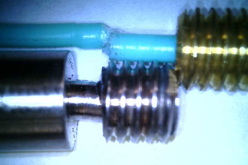

You can also see a ridge where the plastic filled the chambers between the heat break and nozzle. You can see that much clearer here:
The other thing I was able to capture was where the cold break occurred.
You can clearly see the enlarged diameter of the PLA right up to thee top of the narrow heat break and where the water cooling would take effect. (Note also that I bent my heat break
) I have 3 others with the Kraken so I have more to play until a replacement arrives.
The other think interesting about this photo is that the melted PLA is clearly well below where the PTFE tube inserts into the top of the break. I had theorized that this is where the jamming might occur. I've since been able to dissect a second plug today and it shows the same thing.

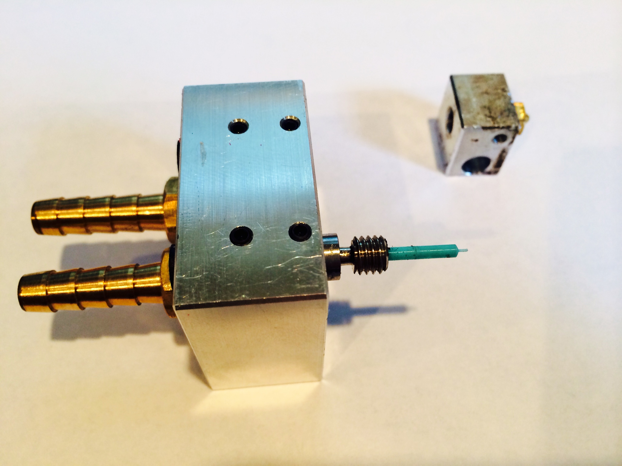

And that led me to some experiments.
I removed the hot end assembly from the water jacket and heated it up to temperature. I inserted a 2" section of PTFE in the top of the heat break and then pushed some PLA down the bore. This was the heartbreak and nozzle shown above after pulling the plug out. As soon as I pushed, PLA flowed very easily for about 1cm and then more and more pressure was required. I tried this 4 or 5 times to verify. The temp was 195°C. I then started ramping the temp up in 5° increments. Long story short, at 220°C I was able to carefully push many cm of filament without the apparent plugging. At the lower temps, the extrusion would often come out curlycued, like there was some obstruction in the tip. I did a lot of permutations and even removed the heat break and used PTFE down to the nozzle. It really seemed like the jam was occurring down in the nozzle itself.
I then did some experiments with positioning the tip further away from the heated block - attached by only a couple of threads. Now, it was nearly impossible to push any filament until I got to 215°C. This might not be unexpected since there is much less metal-to-metal contact for the brass nozzle to heat transfer properly. That leads me to wonder if perhaps the nozzle is fluctuating in temp and when it cools, the PLA freezes and backs up and plugs. Almost anything can make the nozzle cool - the movement as it prints, air from a part cooling fan (or cold end fan), rapid transfer of filament (at high extrude speeds), retract, etc.
I'm not sure what to make of this yet. Options like insulating the tip with Kapton tape or a ceramic paste come to mind. Meanwhile, I just successfully printed a part at 220°C (for PLA!) that I was completely unable to print yesterday in 6 attempts using exactly the same hot end with no additional cleaning or polishing. I am going to attempt a print at 210, 200, ... and see what happens. This is very perplexing as I've printed this exact spool of PLA with this exact same hot end at 185°C on much more complex parts (lots of short hops and retracts) with no problems multiple times. Just odd!

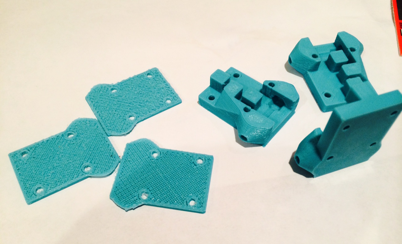

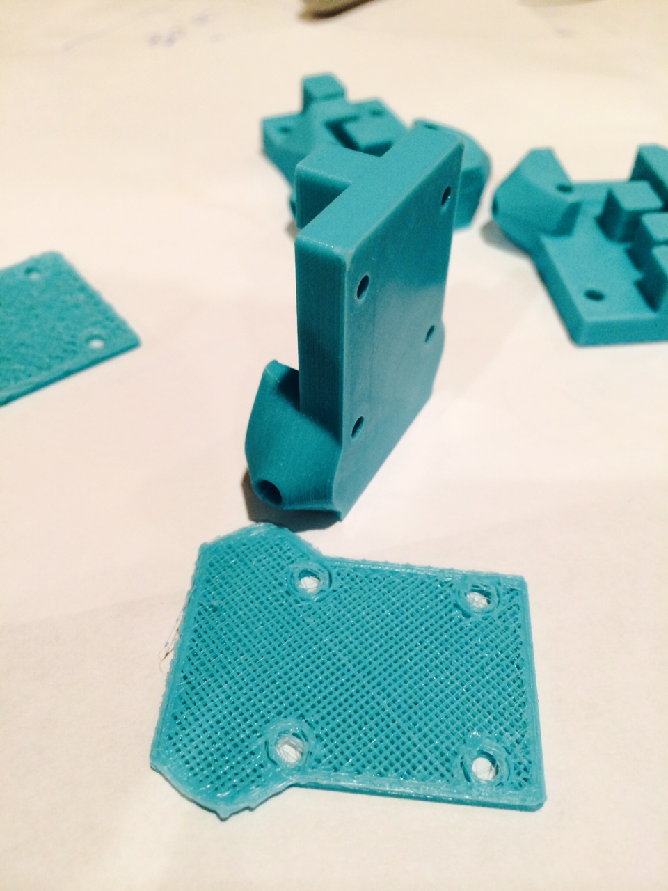

So, here's what I'm talking about. I printed three parts, 1 at a time, that all came out perfectly. Yesterday I attempted to print this part 6 times and got filament starving on all 6 parts. The ONLY think I did was chill the hot end so I could remove the filament intact as per the post above. I then reassembled with no additional polishing or anything else. BUT I printed all 3 of these parts at 220°C (they are PLA) and the 3 terminated parts yesterday were at my usual 195°C for this filament.
Here's a closeup where you can see the yucky filament starting.
I've printed several other parts tonight at 220° and all have come out good.

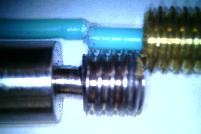

Made some measurements of the bore length of some nozzles. First, here's the setup. I make sure the bore is clean then hold it in needle nose pliers. I have a 3" length of PLA at the ready. I then heat the nozzle with a little butane torch MILDLY. When the too is just hot enough to allow the PLA to flow (takes about 10 seconds or less) I push the PLA in until a little nipple comes out of the end like this:
Let this cool, do not touch the protruding nipple. When it is cool enough to touch, cut the protruding filament off with a single edge razor blade and place in the freezer for several hours. Put a pair of needle nose pliers in the freezer too. When ready, use the frozen pliers to pick up the nozzle - that way it does not warm up too fast. Grab the PLA and pull gently. Don't force it. It takes about 10-15 seconds for the brass to warm up from air temp and expand enough to let the PLA slide out. It will and will look like this:
As you can see, this J-Head is dead-nuts on at .5mm bore length. Interestingly, the cone is also very flat like the E3D.
I also measured three other nozzles and they were all within .5 to 1mm in length. Only the E3D has been anywhere close to 2mm.
Today I am going to chuck one of the E3D nozzles in my lathe and rebore the 2mm lead up to the nozzle bore. I'm shooting for .8mm. I don't have any data that substantiates this but I'm thinking a length to diameter ratio of 2 is a reasonable ballpark. I've googled to try to find any information and there is very little discussion about bore length in the RepRap world, everyone is focused on bore diameter. But, at these small diameters, there is a significant friction component and the longer the bore, the more friction. Stay tuned!
Nozzle bore...
Too early to claim victory, but...
First, I setup and printed a part that has been causing problems the last few days (a mini Kossel effector). I have been able to print it at 220°C but any lower and I get filament starving. One comment on this - I like the KISSlicer curved infill. It really puts the printer through its paces though and seems to exasperate this filament starving problem. Printed with straight infill, I can print this part at 205°C. I verified that the problem is occurring today. I then immediately took the nozzle off the machine and pulled the execs PLA out.
Down in my studio/shop/man cave I used a 2mm drill and twirled it between my fingers to remove any excess PLA - some did in fact come out. I then measured the length of the drill and then the length of the drill inserted into the nozzle. The difference, at least to a reasonable approximation, should be the length of the nozzle bore. I got 1.96mm (in reality, since the bit is pointed, it inserts a little into the bore of the nozzle so the measured length of the bore would be expected to be shorter than actual). I then chucked the drill in a pin vise (a handheld drill bit holder) and used it to gently lengthen the hole. I wanted to try this for several reasons - 1) it wouldn't require a lathe to fix the nozzle and 2) it gives very precise control. With just a gentle twirling of the pin vise between my fingers and a little pressure, the brass was easily bored. I frequently removed the bit, cleaned off the brass bits, and remeasured the bit and nozzle as above. I was taking about .1 to .2mm off at a time, so very precise control. At some point I decided to shoot for .5mm rather than the .8mm I mentioned in the last post. When I was close to the mark, I decreased pressure on the pin vise, twirled faster but for a shorter time. This was to take a fine cut and leave a better surface finish. I was able to get right at .5mm This entire process took a little less than 10 minutes and resulted in what I believe to be a reasonably accurate bore length.
Then, I did my frozen PLA test to capture a plug to see how long the bore actually is. I've gotten the technique down pretty well now so with a minimum of heat to melt the PLA and then dropping in a glass of ice water I can almost immediately remove the plug without freezing for 2 hours. Success, the nipple measured as close to .5mm as I could measure. At least it was significantly less than the 2mm stock bore!
Now, armed with a modified nozzle, I cleaned out the inside with a stream of isopropyl alcohol from a syringe with a 26 gauge needle to clean it out. Very little material washed out. I then mounted in my Kraken, rezeroed my Z axis, loaded my gcode, lowered the print temp to 185° where I used to print this particular PLA with a J-Head or the SeeMeCNC hot end (by editing the gcode, thus ensuring that everything else was identical to earlier prints), said a Hail Mary and pressed Print. Actually, before I did that I did extrude about 100mm of filament into the air to prime the nozzle and see how it would behave at 185°C. It seemed to flow fine and in fact, almost seemed to start faster when I hit the extrude button.
As I've been writing this (20 minutes or so) the part has been printing. Here are my observations:
- I'm successfully printing at 185°C (so far).
- The first layer went down incredibly smooth. One of the nicest first layers I've seen in a long while.
- I'm about 1/2 way done with the part. Earlier, I would get to about the 4th layer and have filament freeze issues. I'm at layer 22 of 41 and the part looks very nice. Very smooth layers, no indication of starving, no stringing, Absolutely no evidence of filament starving.
