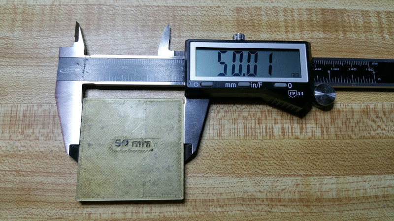

Based on the video, it appears to be over-extruding. (Super hard to see, though - have you considered mounting the hot end BELOW the effector?) The extra filament is being pushed around by the nozzle. You can see it piling up near the loops in the first few seconds.
I whipped up this filament/arm length calibration method JUST FOR YOU: http://www.thingiverse.com/thing:1439048
Okay, it's not just for you. I'm working on it currently, and so far the results have been good.
The main idea is to ensure that your filament extrusion rate is totally freaking nailed, and that your arm lengths are set correctly. For now, I would only worry about the filament multiplier, which is covered in steps 0 and 1. After you get that tightened down, maybe the rest will be useful as well.

626Pilot wrote: I whipped up this filament/arm length calibration method JUST FOR YOU: http://www.thingiverse.com/thing:1439048
...Okay, it's not just for you.
Wow thanks for doing this! It looks very concise and serious. I think it is the first time when I've seen the suggestion to use an outside micrometer. This should be a part of Rostock manual. If we do not understand why our prints do not come out, we get frustrated, and without understanding of why and how to fix it, we give up. I won't be able to try the method for a few days though, as I am working on my Replicape.

Calibrating the extrusion steps/mm is a good idea, but I found it to be somewhat tricky. You have to lay the filament flat and measure it, but it wants to curl, so it's hard to get a precise measurement. It's worth it to do anyway, to get yourself as close as possible. After that, if you use the calibration system I posted on Thingiverse, you will absolutely nail the rate of extrusion for every filament that you run the single-wall test with. That will correct for any error in the steps/mm setting. There is a catch, though. You have to measure the filament in multiple places for the slicer's sake, and then you have to do the single-wall print to perfect the extrusion multiplier, for EVERY spool of filament, even if it's the same color from the same manufacturer.
If the filament is still piling up near the loops, and your extrusion is perfectly calibrated, your Z height is too low. Try reducing it down by ~50 microns. Also, when it draws the first layer loops, look at how flat the filament is.
It should look like this:
Code: Select all
 __
It should be a little rounded on the side, with a flat top. If it's way too flat, it'll pile up, causing these issues. On the other hand, if it's totally round on the top, the Z height is too small.
