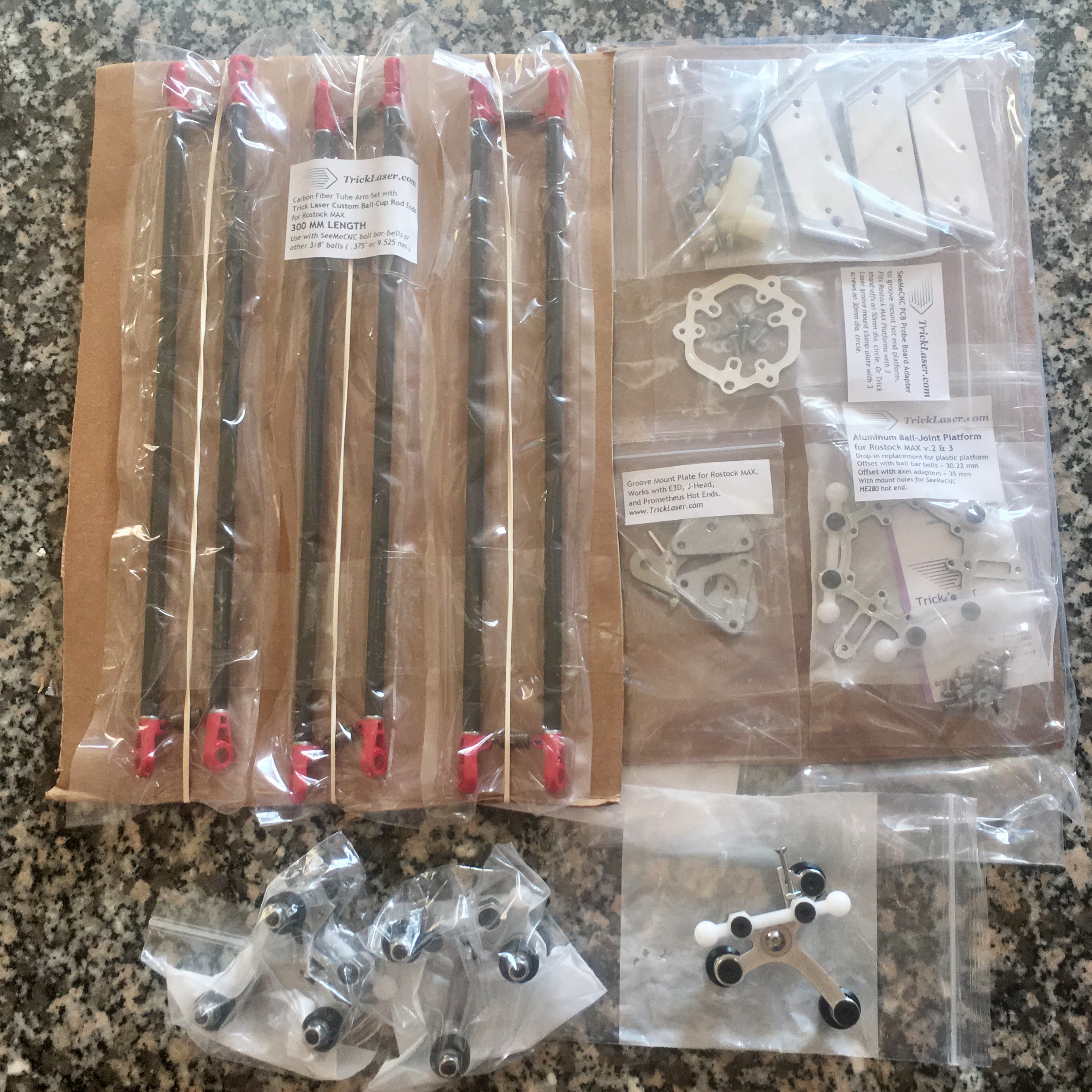

Then along comes Brian and TrickLaser's new Trick Truck X Mini Carriages and new ball-cup CF arms and matching effector. These will accelerate completing this machine and provide basically a "assemble from existing parts" solution that might be more appealing to folks wanting a state of the art, rigid delta printer.
Here are the new parts: So the new Max Metal project will consist of:
- Max Metal frame
- .8° steppers for motion
- all new TrickTrucks, CF Ball-Cup Arms, platform
- DuetWifi
- 7" PanelDue
- 24V Meanwell power supply
- two Bondtech extruders
- E3D Systems Cyclops hot end (dual mixing hot end)
- Onyx heated bed
- FSR bed leveling (primarily because Duet firmware does not support the accelerometer probe yet, but I am going to mount an extra PCB so I can start working on that)

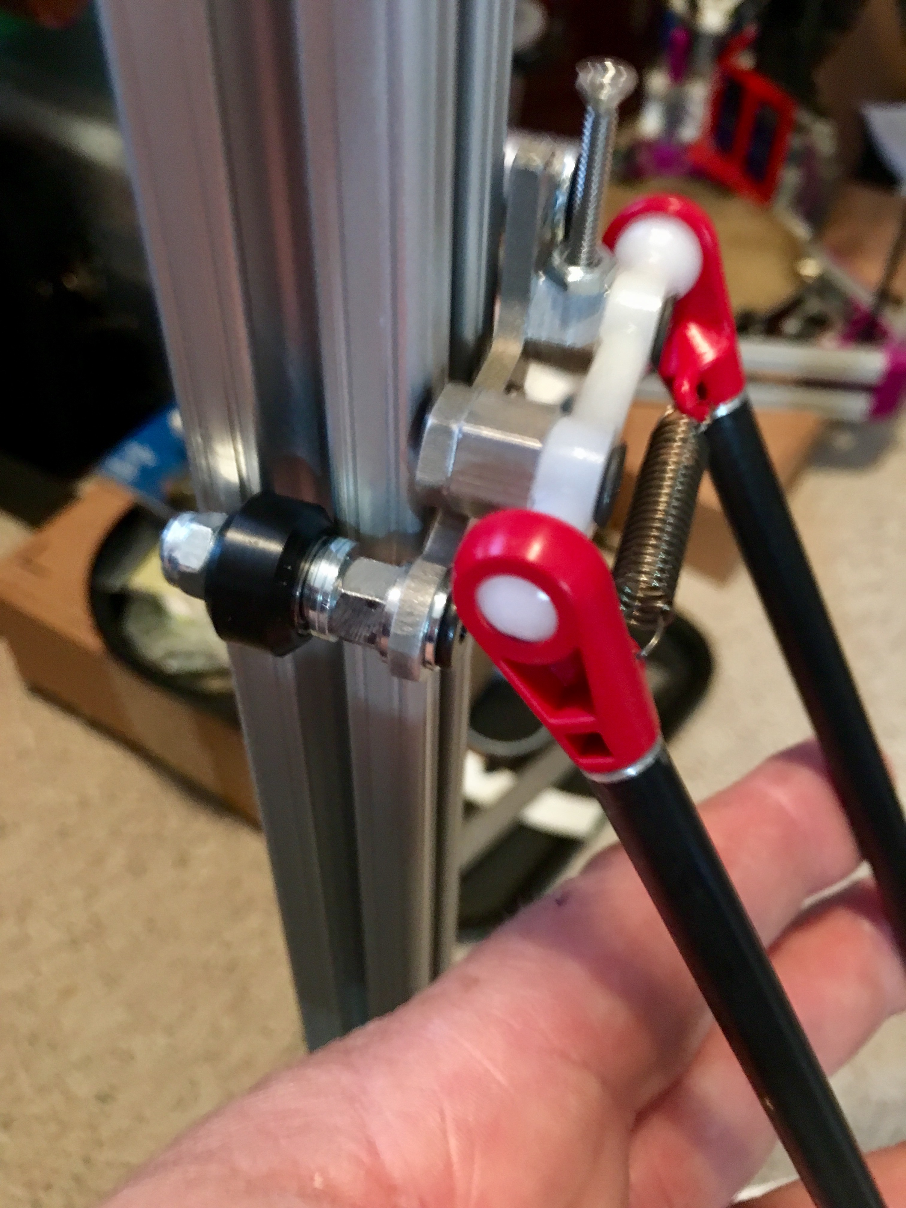

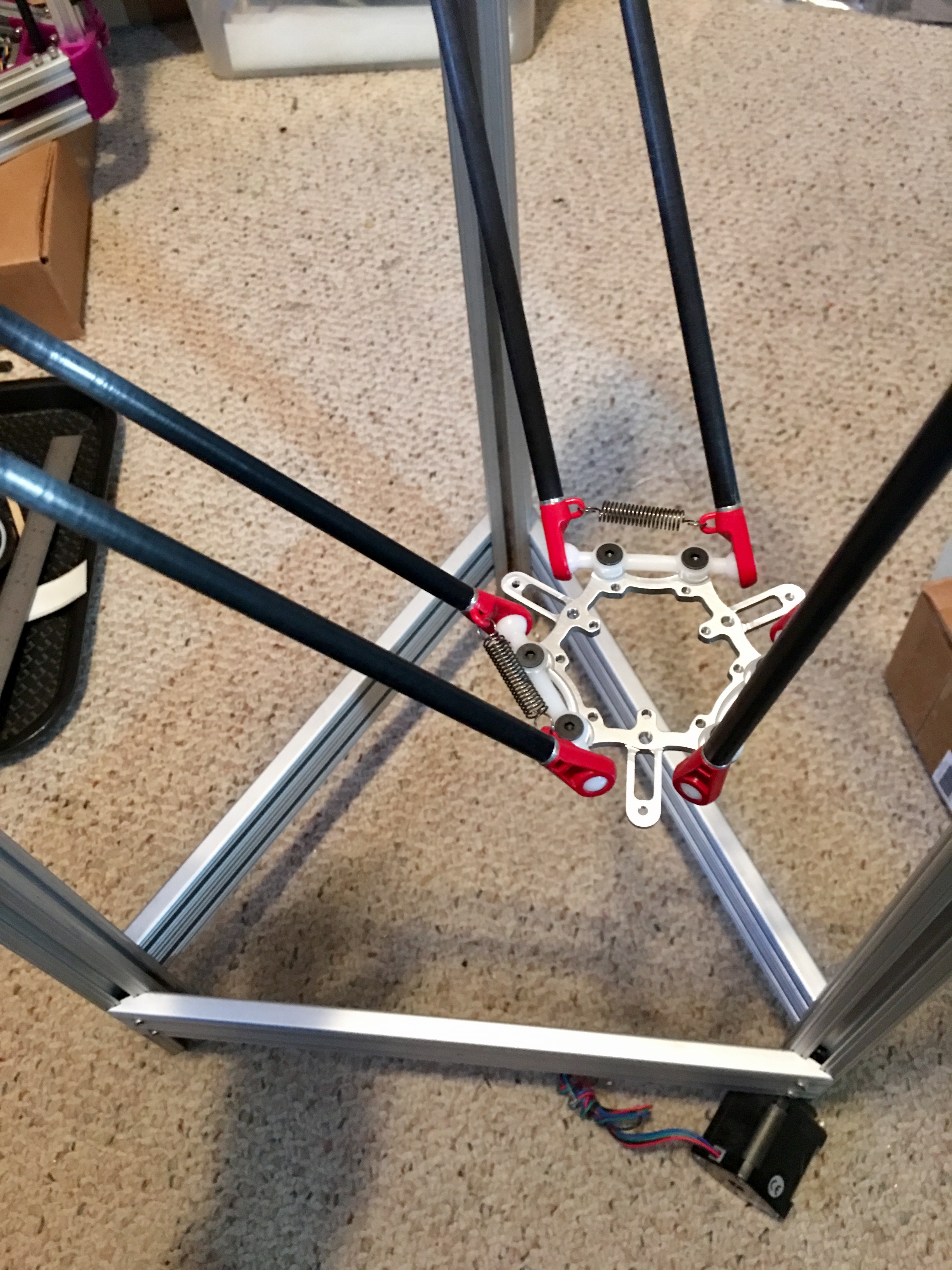

I couldn't wait to get started, these parts sitting on my desk were like a Siren calling "build me, build me". I took off the linear rails and my custom offset belt guides, carriages and tensioners. Once I had the Max Metal down to it's stock frame, assembly of the new Mini X Trick Trucks, Ball Cup Arms and plate took 6 minutes. And boy are these parts beautifully machined and those red ball cup ends are the perfect bling!

I really like the simple belt attachment on the new carriages Brian, bravo1

Re: Trick Laser MAX METAL with Linear Rails
Thanks!mhackney wrote:1475731359811-867362821.jpeg
I have been trying different things for almost a year, but was never satisfied with anything.
Until one day recently I had a "Ah ha" moment... this design I am pleased with.
