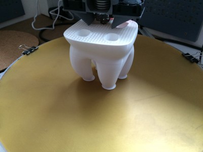

I'm using this mini IR height sensor without any issues with PEI ( tested it on glass, aluminium, tape, glue). It basically shoots light at the surface and bounces back to the IR receiver once the angle the reflection aligns.

Have Davids IR-Probe working with a 3mm PEI Sheet without any problems. No Black Paint, no nothing. Just sanded the PEI with 800grid Paper and clipped onto a 5mm Aluminum Heatspreader.

On David's link https://miscsolutions.wordpress.com/min ... sor-board/ to the IR sensor board he does mention that PEI is transparent to IR and to paint the underside black.
Can you guys tell if it is reflecting off the surface of the PEI or the back side (aluminum plate or Onyx)? The height offset would tell you that.

My PEI is heavily sanded. It looks almost frosty to the point you cant really make-out any of the shapes/words on the onyx underneath.
That might be why I'm not having issues.

I'm not sure this video will help. I was recording it to determine the cause of the inconsistency and fluttering of the detection.
I ended up having to twist the outer IR LED to correct an alignment issue. Every printing surface seems to detect at different heights.

My IR-Probe is working perfect. Like KAS said, every surface is showing different probe heights. Think it´s because of better/worse reflection.
But my sanded PEI is giving me repeatable accuracy in 0.01-0.02mm. Same on Glas, which is painted black on the rearside, or on Buildtak.
I have now 3 IR-Probes installed on my Printers and every Probe is working like the other. Never seen this behavior KAS is showing in the video.
Guess it´s a misalignment of the IR-Diodes. But I would ask David for a exchange. Thats not a normal behavior.
As far as I know he changed the Diodes in the latest batch which are working better and giving better results with different surfaces.

on the second time I watched your video I recognized that your IR-Board is attached too far away from the surface. Normal probing point is between 3-4mm. But yours is much more.
Maybe one of the IR-Diodes is heavily missaligned. Send this video to David and I´m sure he knows what to do or whats the fault. But I guess the angle between the two Diodes is far out of normal alignment. Please report what David suspects.

You're absolutely right on the placement, this was an initial setup just to test it out. Everything is working fine now after twisting that outer LED. I'm now using it on a mini kossel I built. The IR sensor would detect the surface about 2-3 inches off the surface with very inconsistent results, but that's all been corrected now.
