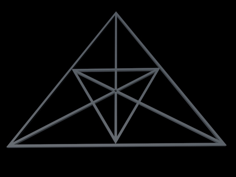

Ok, well there may also be a simpler way to measure inaccuracies in the XY plane. I am assuming with this that the inaccuracies will be in part from issues with the tower, so I drew up an stl real quick. From the center to the outer tip of each point, the measurement should equal 124mm. I am not sure how well this will work, if at all. But I figured it'd be enough to ponder on for now.
If the value is smaller, then increase the delta radius for that tower... maybe? I haven't quite delved into the XY domain yet. Let me know if this method won't work.
calibrationTest.stl
(11.8 KiB) Downloaded 719 times

You can also tape a sheet of paper down and run a script to touch each point. Then measure from center dot to each location. A .4mm nozzle leaves a perfect circle to take a measurement with a digital caliper. Might be quicker than reprinting after each change. Ultimately you want equal values for each tower to center.

KAS wrote:You can also tape a sheet of paper down and run a script to touch each point. Then measure from center dot to each location. A .4mm nozzle leaves a perfect circle to take a measurement with a digital caliper. Might be quicker than reprinting after each change. Ultimately you want equal values for each tower to center.
That is definitely a faster method! Thanks!

You could put a pen on the effector and make it draw lines, rectangles and circles on paper paced on to the bed.
