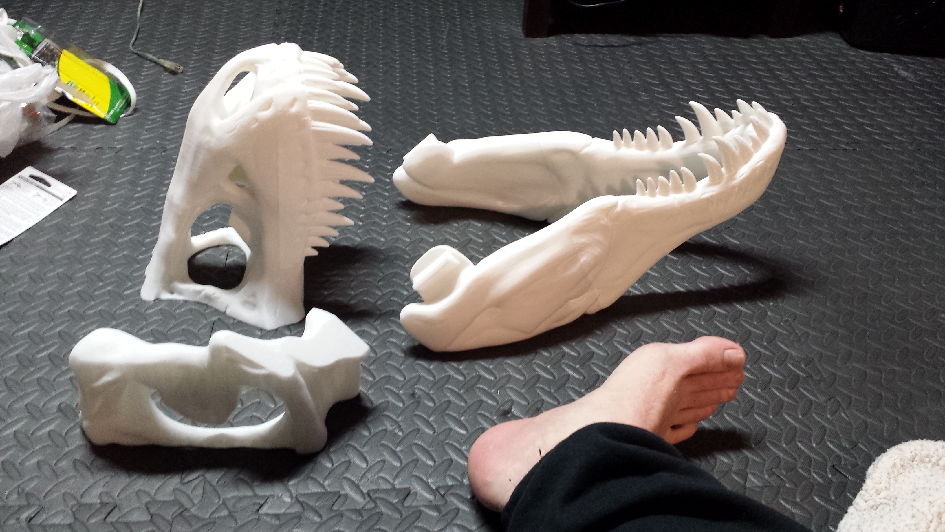

same here I just havnt played with mine because of the large t-rex skull mask im working0110-m-p wrote:Guess I was lucky...my payment went through first time no problem. I had my license and everything installed in a couple of hours.
