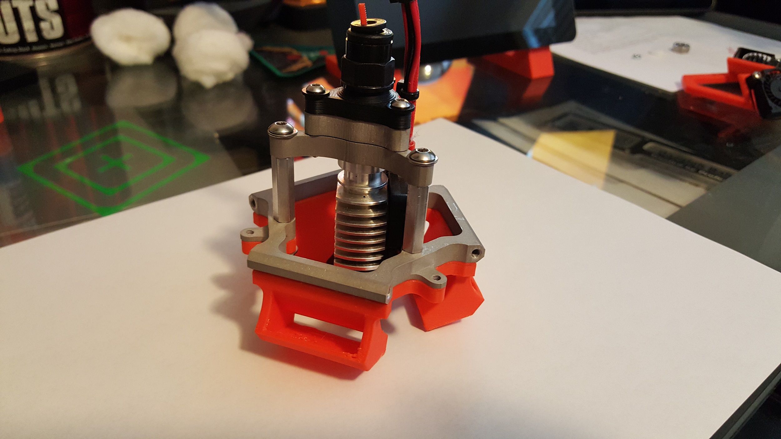

I've been designing my own enclosure, and I was worried about this happening... Thinking about working on a more compact effector, or at least one that doesn't have fans protruding as far.
What diameter would you say you can reach before hitting the wall?
				Re: Enclosure build to print ABS and Nylon bigger and faster
				Posted: Wed Apr 27, 2016 4:22 pm
				by EskimoRuler
				Jimustanguitar wrote:Captain Starfish wrote:Sigh. Effector platform is smacking into the wall and skipping the steppers during the MatterControl 7 point calibration.
I haven't built an enclosure yet but when I designed my layer fan Mount, I was trying to keep the fans as close to the effector as possible. This is what I came up with. I'm not really sure what radius I can get to. The only thing that will stop it right now are my towers. I can't go the edge of the platform without hitting the tower.
				Posted: Wed Apr 27, 2016 7:33 pm
				by Captain Starfish
				I'm still using the standard effector platform for the V1 loaded with an E3Dv6, layer fan free at the moment.
It wouldn't have been a problem using GeneB's calibration coordinates. It's not a problem using 3 point calibration in MatterControl. But the 7 point calibration takes the nozzle out pretty close to the edge which means a fair bit of overhang. I'm guessing but I reckon at least an inch overlap. It'd be ok if the triangle walls didn't come in past the edge of the circular base or top but, without vac forming round walls, that would be a monster of an enclosure.
Not just an issue for calibration, this will affect anyone trying to print right out to the edge of the bed too. It hauls your effective bed diameter down to about 230mm.
Might try and see if reducing the max radius on the printer settings fixes it. No spiffy spiral speakers for me without removing the enclosure, I guess.
