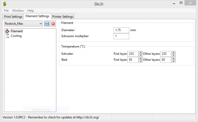

Attempting the first print , having some small problems , and one major. Of course the abs isnt sticking to the glass. didnt have any hair spray did find pink hairspray of my daughters , hope it works. What is also happening is when I hit Run Job button
my hotend temp drops down to 175 , I have change my default settings to 250 hotend and 115 bed , but it still drops it down? Anyone got ideas ?

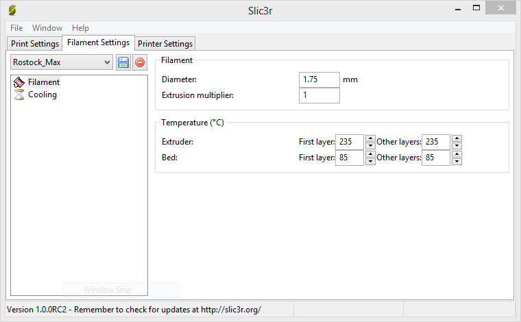

Thinking im confusing you all , my hotend I can set to 2xx whatever and it gets there pretty fast , but when I go to print the cali cube and hit Run Job , it changes the setting to 200 , when it is reached it begins to print but is not hot enough to extrude the abs , Im thinking.?
I heat up the hotend to 230 and extrude 20 mm of abs just fine. I just need to figure out why Repetier or whatever gcode is cause my hotend temp setting to change down to 200?

Im using the slic3r in Repetier -Host , Under printer settings I have change the default Extruder Temp to 230 , which it stays there , doesnt change. Now that I think about it not sure if that even that hotend ?

So in this window what temp? 230C?
and this one?..."manual control" Repetier host

Thanks that was the problems I was changing the settings in the printer and not the slicer , and must have overlooked that last night when i was averaging the abs diameter.
