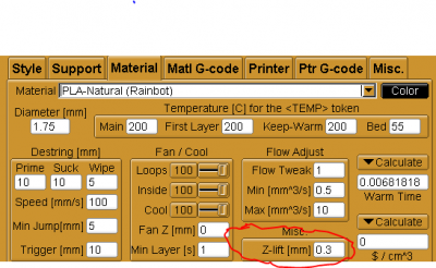

I figured it out. it is the extrusion width in the Slicer:Printer Settings:Advanced.
I was looking at that thinking there should be a separation setting, not realizing this one would do the trick.

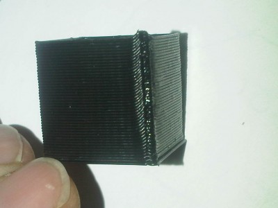

back to re calibration .7 noz printed test cube 20x20 looks beautiful Kiss setting included. BUT i have questions
1. what causes the lift in the corner where it starts the next layer and how do you stop that
2. why and what would cause the cube to be outa sq. 20.03 x 19.46mm
3. in Kiss where is the multiplier setting still trying to figure that out from begging thread in this post KISSlicer - PRO

in repetier, there is a randomize start/Finish option.

what is your zlift at?
- Posts: 99
- Joined: Wed Jun 06, 2012 3:59 pm
Re: Extruder Calibration
Bubba I was following the thread calibration settings and I have z at 0 which lead to my ?
I printed again at 100% infill and while printing looked like it would be overfilled but came out better than I think I will take pics in am and post next print willbe 50% and see what I get. Still not sure of all the settings 90% dont make any sense as to what they mean or even effect . But willing to learn and never to old to try
i was thinking that the lifted corner cause was z-lift.. my thought as it finished a layer it lifts high, and causes that raised corner. but because you say its at 0 nothing that would do that comes to mind. a wipe would probably help but if your following the directions in the thread i wouldn't worry about it right now.wildideas1 wrote:Bubba I was following the thread calibration settings and I have z at 0 which lead to my ?
- Posts: 99
? 1 why is my cube not sq 20.03 x 19.83 I have printed 3 cube now different infill but all 3 are exactly the same deminsions (freaky) but still not sq. Why?
