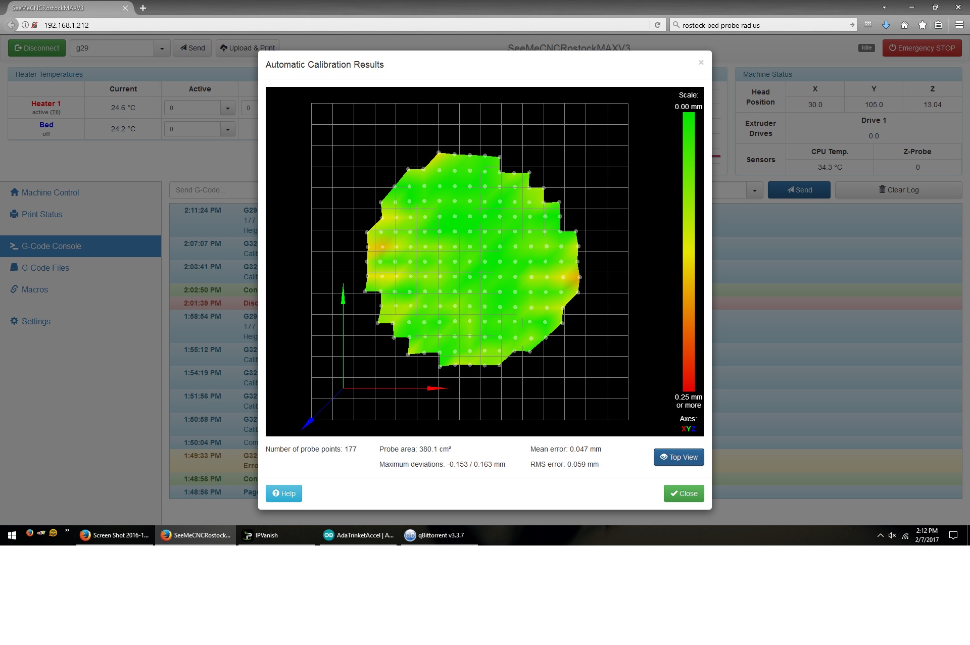

DerStig, did you ever figure out what was causing it to skip across the bed? Mines doing the exact same thing and I cant figure it out for the life of me. Running duet wifi with mhackney's YAAA in the 4 pin z probe. Ive tried everything listed in this thread and other buts to no avail. Ive made sure the M558 was set to p5 and ive used F value's all the way from 1200 to 6000 and they all give the same result. I also repeated various m558 F settings with an increased sensitivity of 30 on the trinket but it still skipped. Maybe someone can see something im missing...
**EDIT/Update 12:30a
Think I might have it solved. Did what kraegar suggested and commented out the following:
#define RESET_BEFORE_PROBE 1
and suddenly im able to probe at sensitivity 20 with M558 F1200. Hopefully im not speaking too soon.

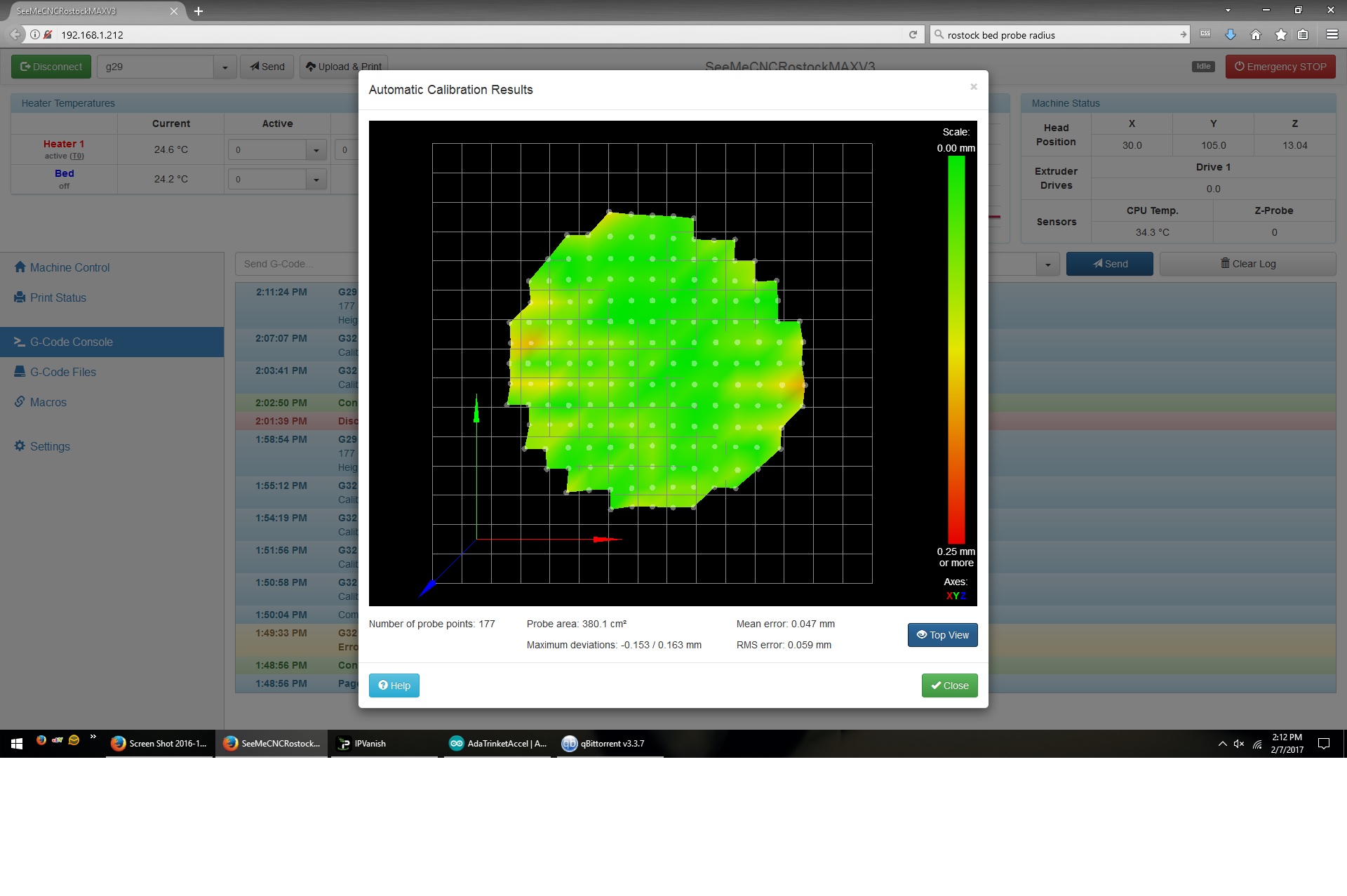

Just a follow up to my last post. Tweaked a few things and now mine is working great! Other than whats listed below, I followed everything to a T from mhackneys conversion and YAAA threads.
What I changed:
-commented out "#define RESET_BEFORE_PROBE 1"
-lowered sensitivity to 18(I dont know why but 20 would cause skipping, maybe someone can explain it to me?)
-M558 H13 F1400
A pic of my heatmap after probing:
What I changed:
-M558 H13 F1400
Re: RostockMAX V3 to Duet WiFi conversion instructions
The sensitivity setting is very sensitive!

Random followup to my last post. I had to up the m558 F to F2000 to get probing working reliably. But the main purpose for this post was that I had been unable to get my layer fans to turn on since I did the duet conversion. Finally got a chance to sit down to trouble shoot it this morning and discovered that despite following your instructions on your blog, the pinout for the layer fan was different. In your instructions, you said connect the orange layer fan wire to fan0 positive but that wouldn't turn my fans on. So I referenced the stock he280 pinout(linked below) and as soon as I put my orange layer fan wire to fan0 negative the fans fired right up. Not sure if there is more than one version out there but this had been bothering me all week haha

So I'm also having a few issues and I was wondering if anyone has any ideas.
I'm getting the issue where my probe will skip across the bed because it's not triggering consistently. I've tried sensitivity settings between 5 and 70 and messed with the f value (speed on the probe movement if I understand correctly?). I've also tried commenting out RESET_BEFORE_PROBE 1. The weird thing is nots not that probe board never triggers, it's that it triggers really inconsistently. It'll probe certain points fine but on others it'll just hit and skip across the glass and the points it messes up on aren't consistent.
I'm running an e3d v6 on the tricklaser aluminum effector and hotend mount with the tricklaser probe board mount. My probe board is stood off of the the tricklaser mount with some nylon spacers I had lying around.
Let me known if there's any more information I can give I usually forget something, Thanks
