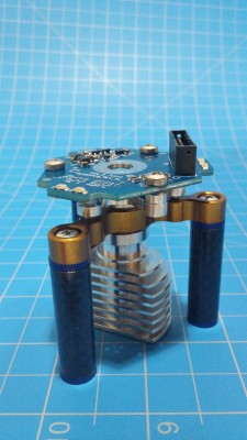

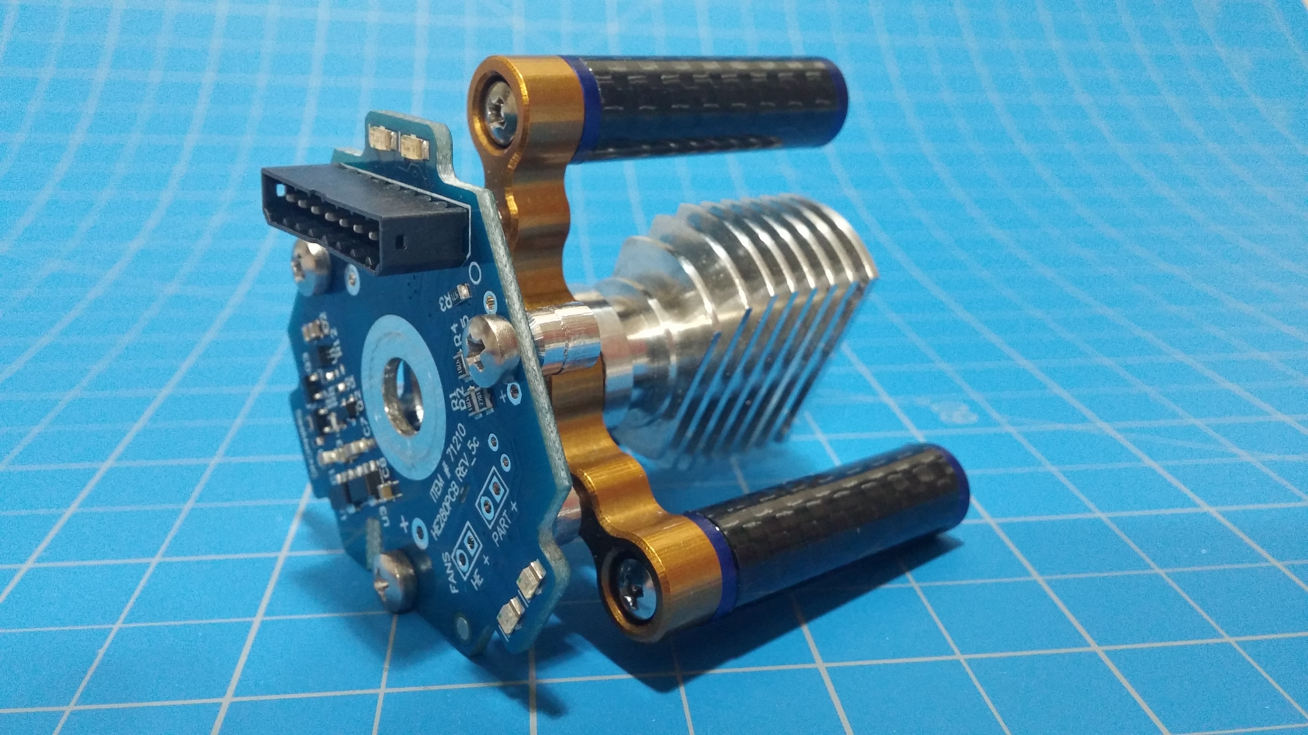

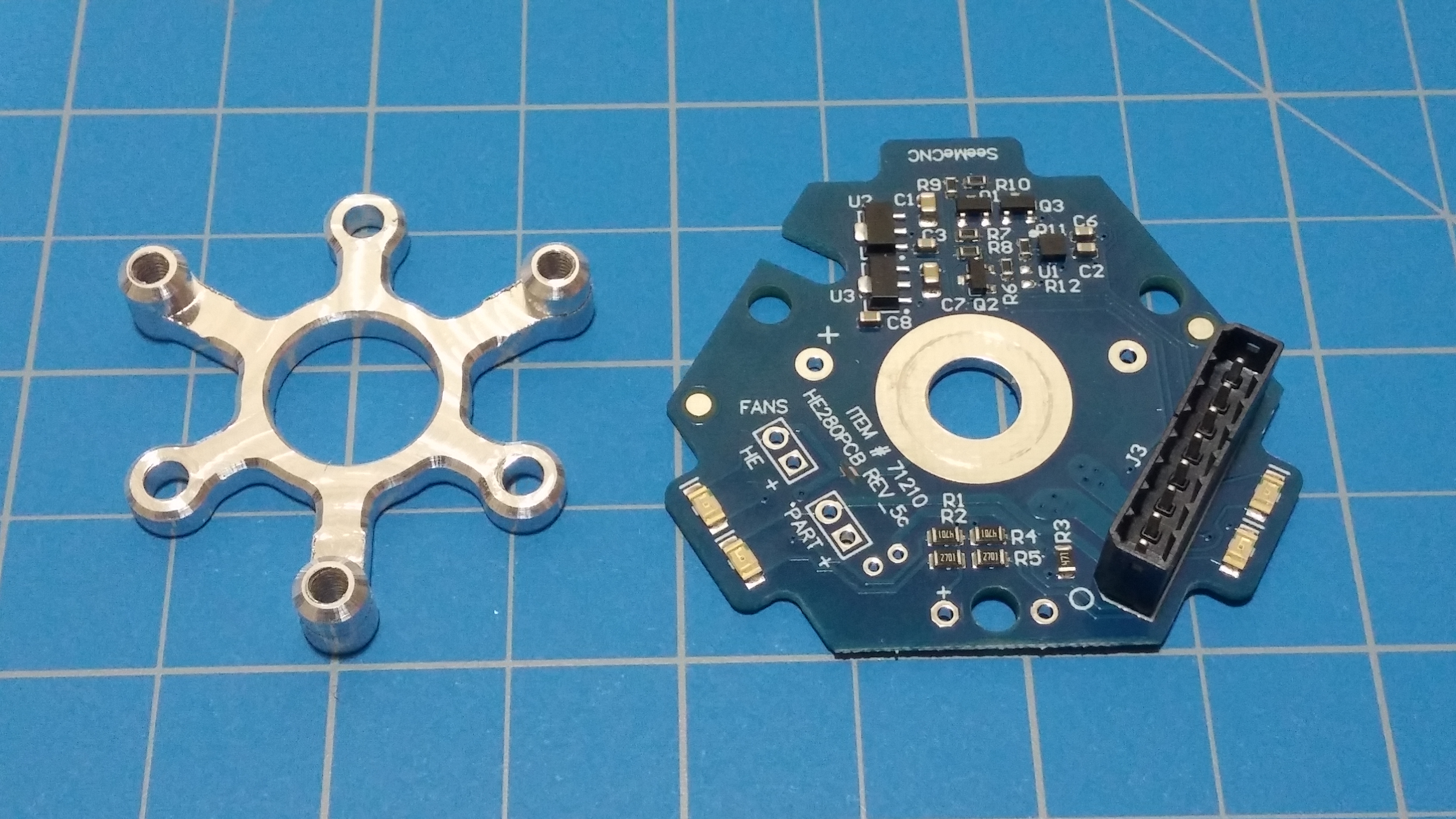

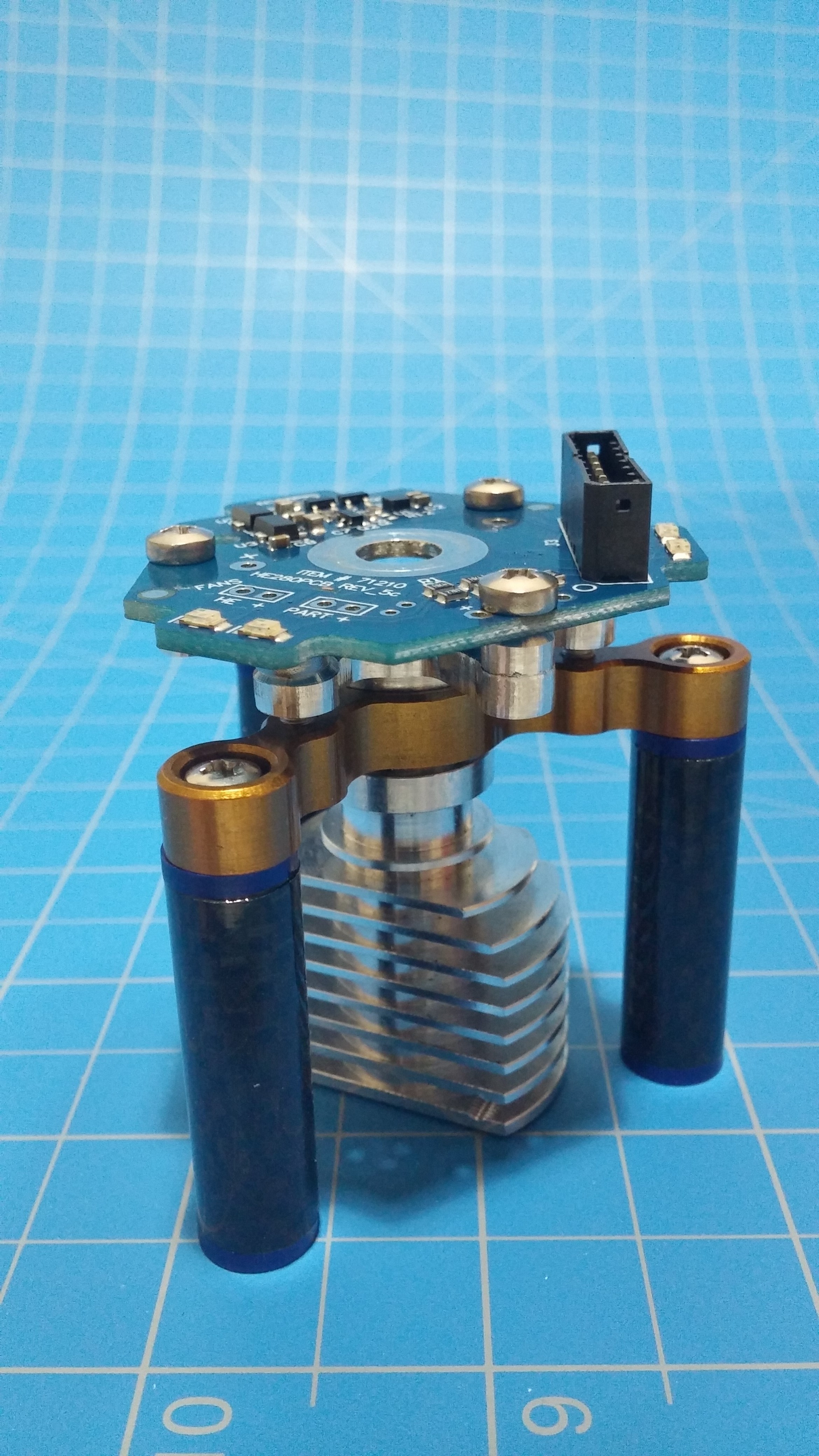

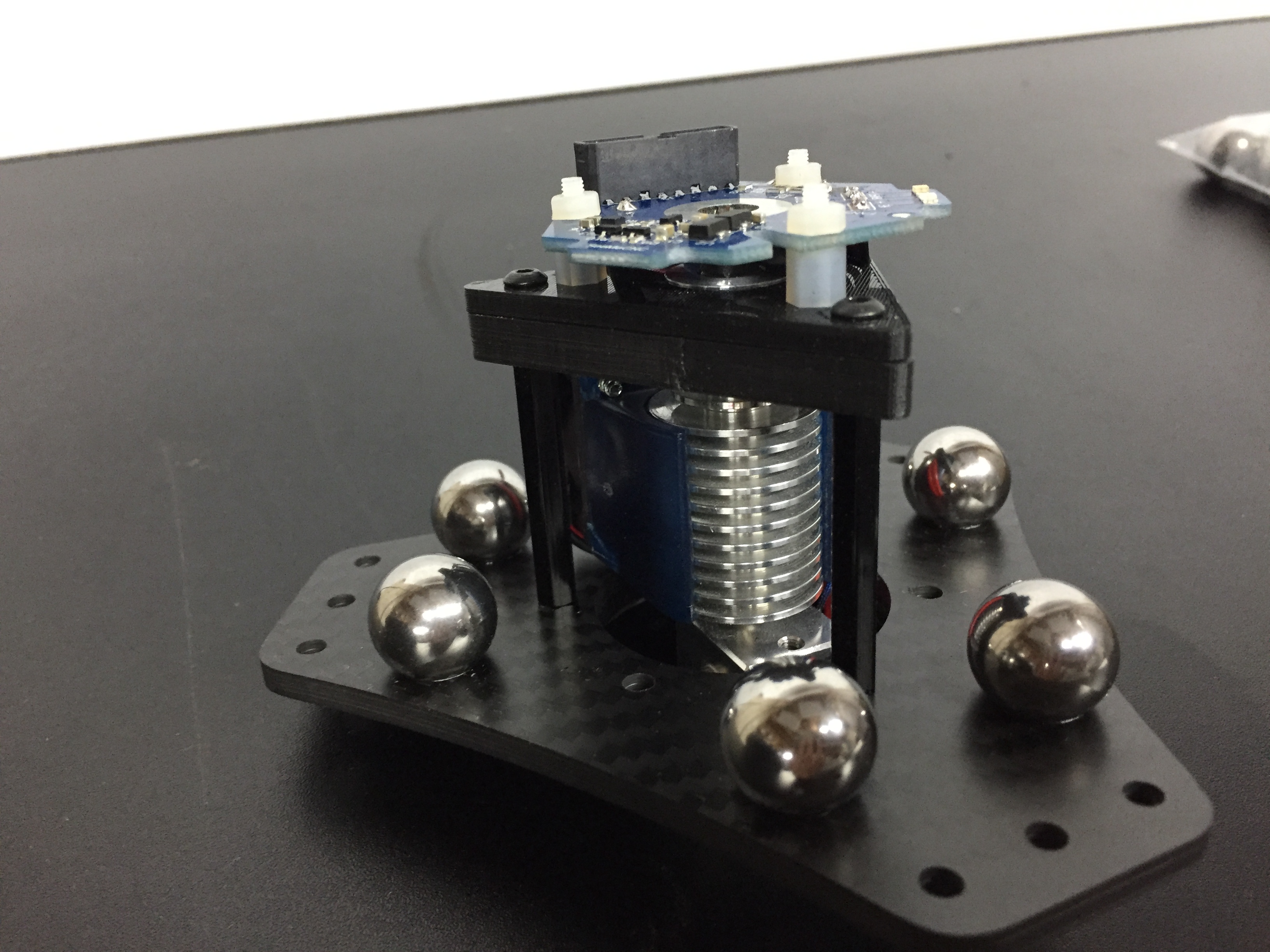

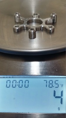

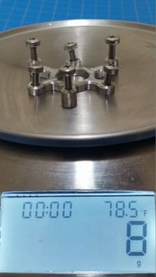

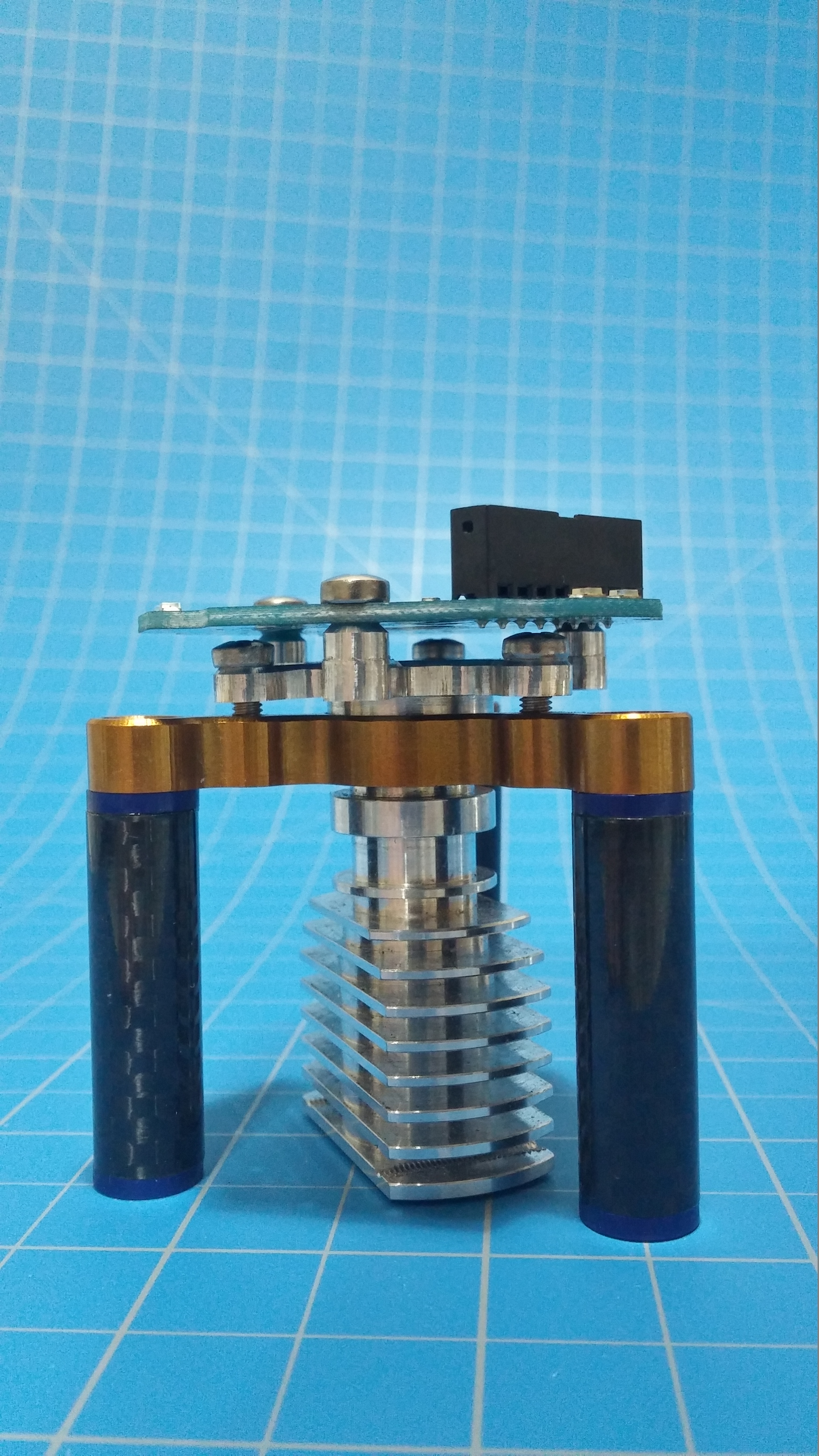

Here is the first prototype mount for the HE280 calibration board for the 713maker mounts. 4 grams alone and only 8 grams with screws. It replaces the standard lock ring and will be a standard option with all kits shortly. We are sending out a few test adaptors shortly and should have them on the site by Monday of this next week. We might still make a few changes to the design, but we have a great start already. For those who have already bought our kits, the rings will be listed in our store for around $5-$8 and we can offer first class mail shipping to save on such a small part.
Qdeathstar
- Posts: 622
Re: HE280 Hot End and Probe board on RMAX v2
Looks sexy. I posted it picture of it on the Arduino forums and they thought it came off a space shuttle.
That is looking sweet! I will definitely be ordering a full setup for the HE280. Just got to decide on color

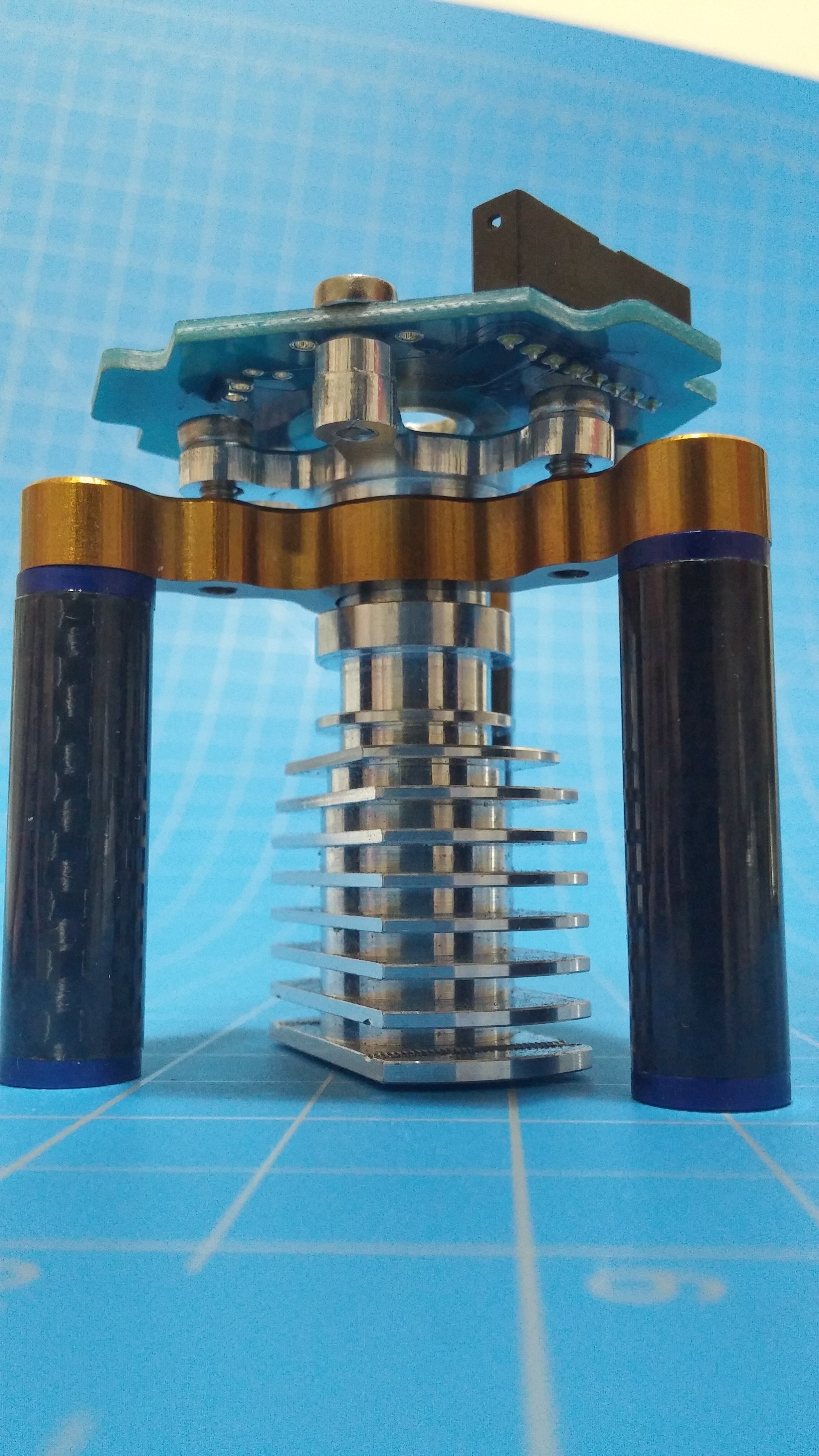

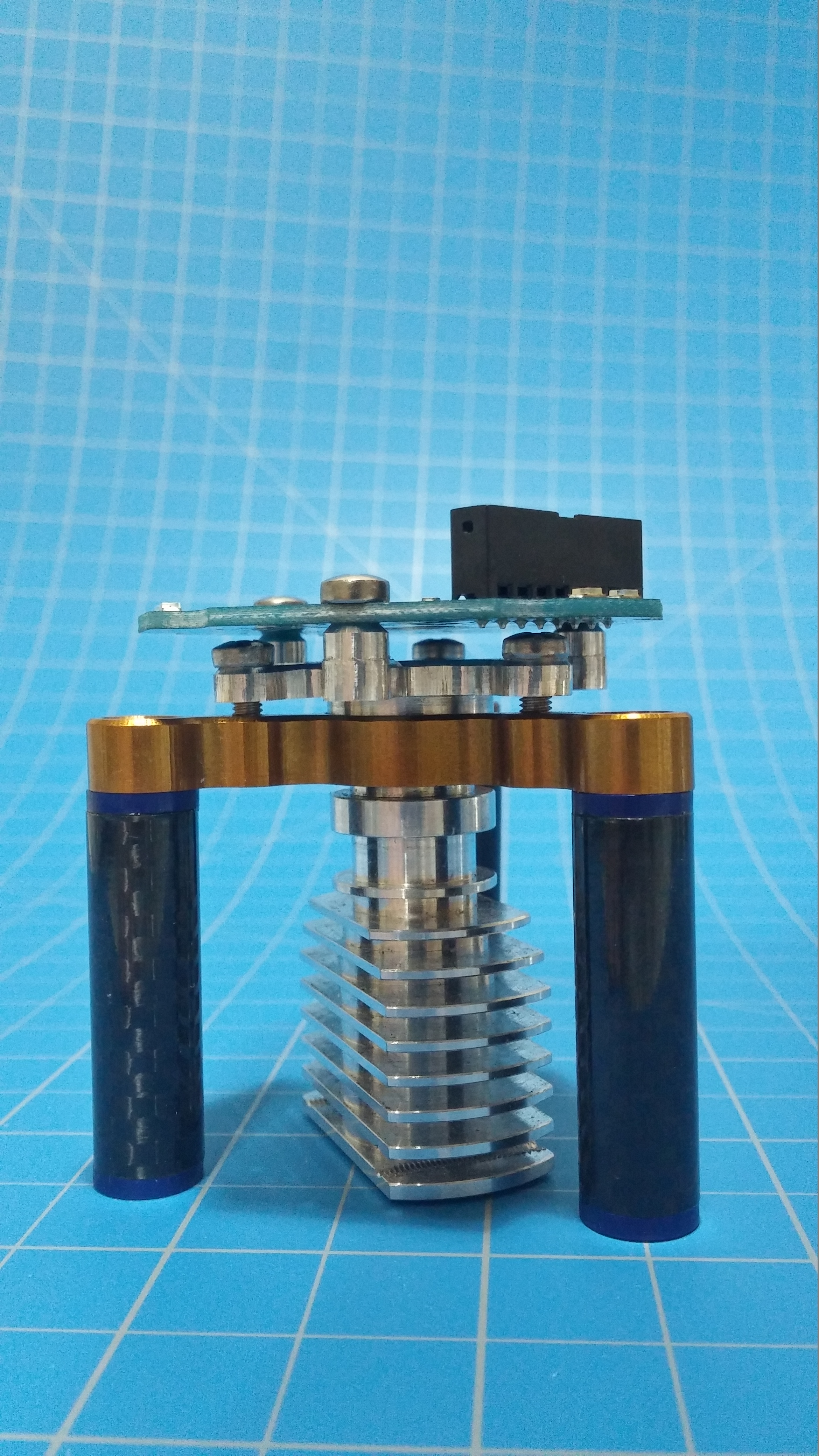

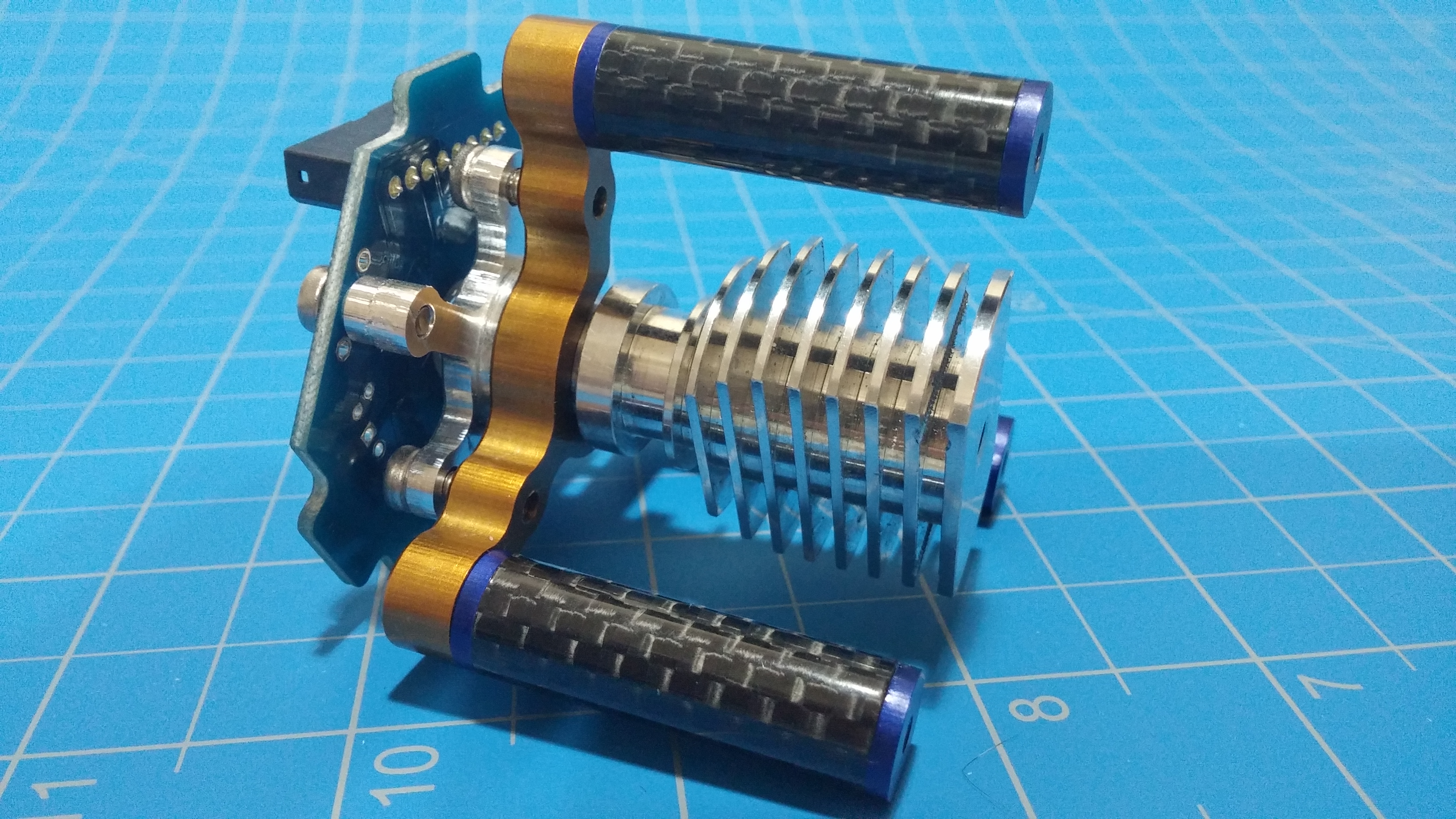

travelphotog wrote:Here is the first prototype mount for the HE280 calibration board for the 713maker mounts. 4 grams alone and only 8 grams with screws. It replaces the standard lock ring and will be a standard option with all kits shortly. We are sending out a few test adaptors shortly and should have them on the site by Monday of this next week. We might still make a few changes to the design, but we have a great start already. For those who have already bought our kits, the rings will be listed in our store for around $5-$8 and we can offer first class mail shipping to save on such a small part.2016-09-20 20.28.14.jpg2016-09-20 20.27.24.jpg2016-09-20 20.27.04.jpg2016-09-20 20.25.14.jpg2016-09-20 20.25.01.jpg2016-09-20 20.24.43.jpg2016-09-20 20.24.25.jpg2016-09-20 20.24.02.jpg
Can you give me the total height from the top of that Prometheus heatsink to the top of the board please.
I'm asking because we have the Prometheus multi filament kit coming and I'm trying to figure out if that board with your lock ring will fit under the Y junction block of the kit.
travelphotog
- Posts: 398
TwoTone wrote:travelphotog wrote:Here is the first prototype mount for the HE280 calibration board for the 713maker mounts. 4 grams alone and only 8 grams with screws. It replaces the standard lock ring and will be a standard option with all kits shortly. We are sending out a few test adaptors shortly and should have them on the site by Monday of this next week. We might still make a few changes to the design, but we have a great start already. For those who have already bought our kits, the rings will be listed in our store for around $5-$8 and we can offer first class mail shipping to save on such a small part.2016-09-20 20.28.14.jpg2016-09-20 20.27.24.jpg2016-09-20 20.27.04.jpg2016-09-20 20.25.14.jpg2016-09-20 20.25.01.jpg2016-09-20 20.24.43.jpg2016-09-20 20.24.25.jpg2016-09-20 20.24.02.jpg
I am not 100% sure where it is you are seeking to measure from. I can tell you that from the top of the mount to the bottom of the board is 9mm. The lock ring is 6.4mm at the thickest so that plus the board height which is 1.5mm will give you 7.9 total thickness above the top of the cold end. So from the top of our mount to the top of the board SHOULD be 10.5mm. Do these number help? Tomorrow my extra board comes in and I can mount it and send some pics if needed.
travelphotog wrote:TwoTone wrote:travelphotog wrote:Here is the first prototype mount for the HE280 calibration board for the 713maker mounts. 4 grams alone and only 8 grams with screws. It replaces the standard lock ring and will be a standard option with all kits shortly. We are sending out a few test adaptors shortly and should have them on the site by Monday of this next week. We might still make a few changes to the design, but we have a great start already. For those who have already bought our kits, the rings will be listed in our store for around $5-$8 and we can offer first class mail shipping to save on such a small part.2016-09-20 20.28.14.jpg2016-09-20 20.27.24.jpg2016-09-20 20.27.04.jpg2016-09-20 20.25.14.jpg2016-09-20 20.25.01.jpg2016-09-20 20.24.43.jpg2016-09-20 20.24.25.jpg2016-09-20 20.24.02.jpg
Thanks, I think that work, they said it's 15.5 mm to the bottom of the Y block from the top of the cold end.

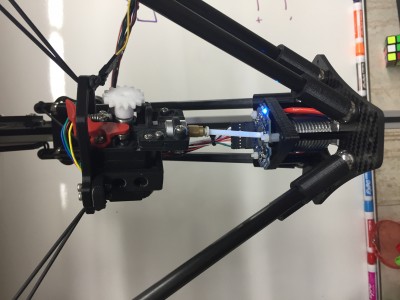

We did the top mount method using an e3D v6 hotend. Works wonders! The wiring needs to be a little longer to bend around the extruder if you have an Airstruder setup.
