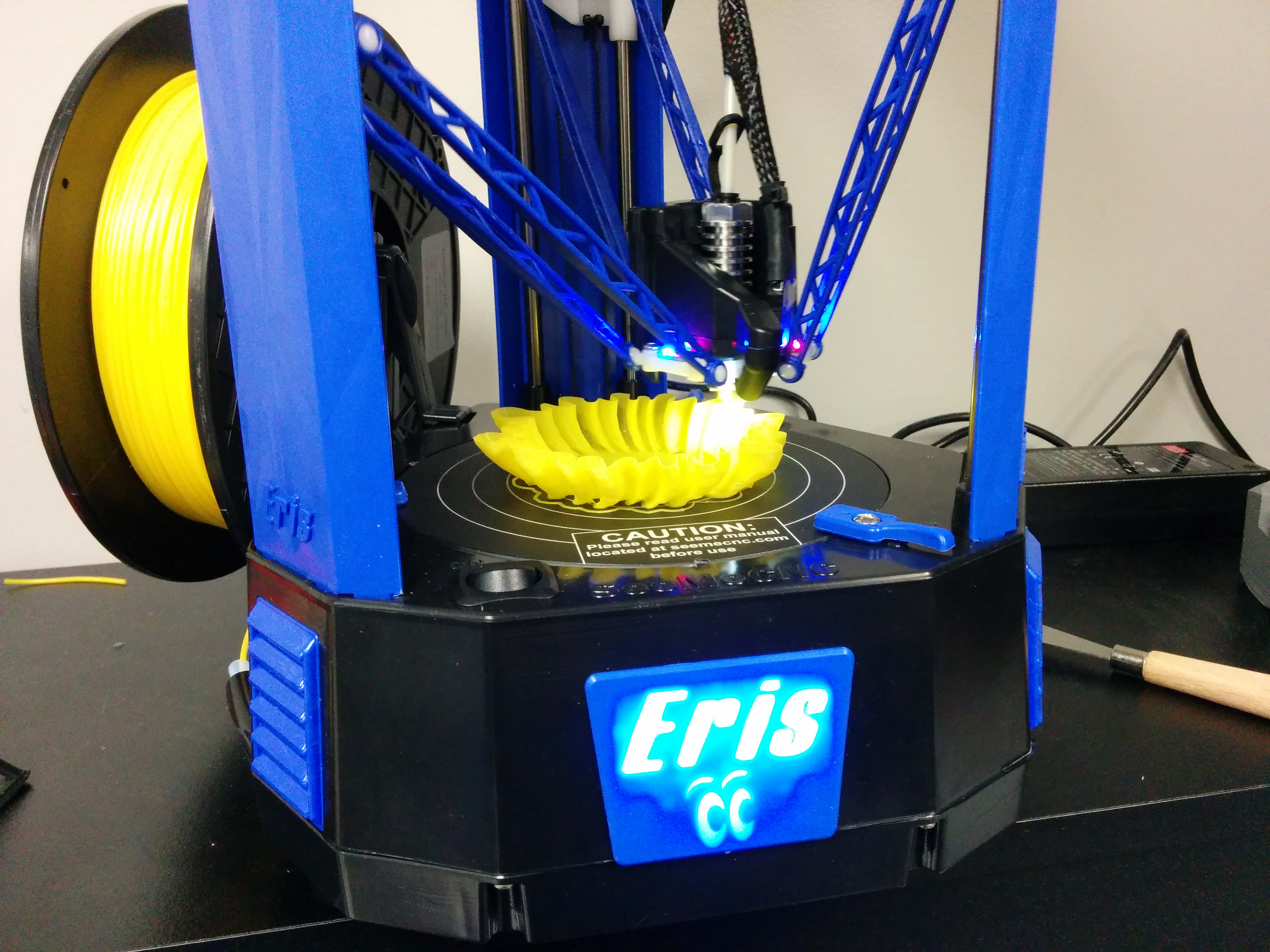

It Lives!!!  I just had to get into the settings and select COM 3, to connect to the printer.
Congrats Mac!   The first truly wild one is out!   How'd the calibration probe work for you?   PS, we almost drove it up to you when we went to print the label
 - Posts: 1407
Calibration was painless.,  I don't know if it was necessary, but I changed the file designation from .txt, to .GCODE so that MatterControl would find it.
 - Posts: 1407
and the packaging looks pretty durable.
 - Posts: 1407
First print was the cube,,,, Second print job is this one from Thingiverse http://www.thingiverse.com/thing:617395
Mac, Got any pictures of completed prints?
 - Posts: 1407
Nah, it's still printing the vase, and I need to tweak the default settings in Matterslice. I think .25 mm layer thickness is a little much to print in vase mode. It isn't a good representation of what the Eris can do.JATMN wrote:Mac, Got any pictures of completed prints?
