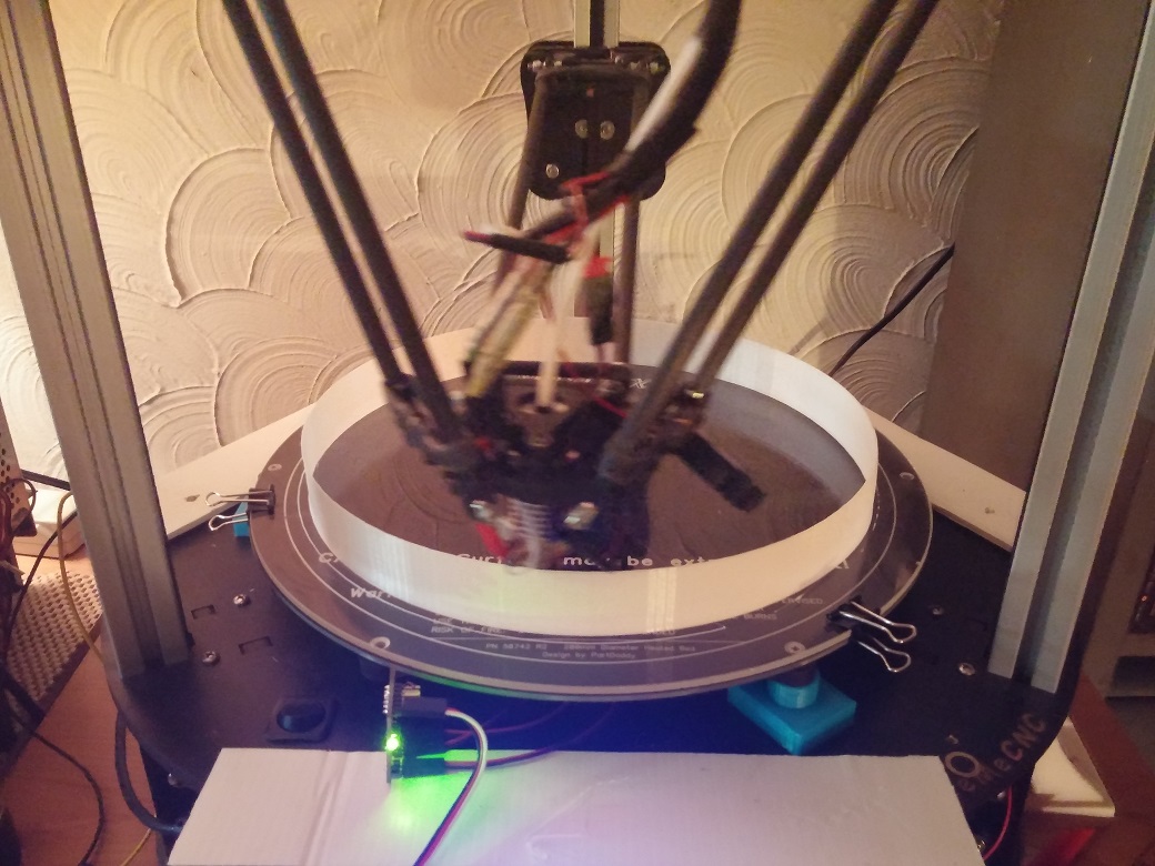

I should also mention to those who are still pondering on getting the FSR kit, that it is extremely convenient. They were definitely worth getting.
geneb wrote: I'm happy with it. it's a little thin near the Z tower, but that's not a deal breaker.
The layer thickness is excellent - I made no adjustments to the Z height after the calibration process was finished, so the first layer actually was .25mm.
I figured I'd make this a REAL test and print it on cleaned, totally bare glass. No glue, spray, PEI, etc. PLA @ 190C and the bed at 55C. \o/
Now to FSR-ify White MAX and Orange Menace. Poor Red Sonja and Orion Lannister will have to wait until I can get FSR kits for them. :)
Glad to see you've had success with this! The version that I've posted should give some improvements, I have made a lot of minor improvements over the past two weeks.

With the current steps per millimeter, 80.75, I am printing a tube 1 layer thick with a radius of around 133 mm. So far it is great, except for having the bed temp to high. I will post some pictures in a bit.
And milp, yes, you are correct!
Edit:
Here is a picture of the cylinder, it is one perimeter layer thick - 0.4mm.
File size: 252.45mm
Actual size = 252.413mm
