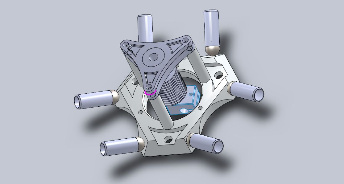

Hi guys, is someone using magnetic arms? any pro/con?
Is the upgrade worth it? if not, why?
To be more precise, I would love to read an honest review from someone ho has been using them for a few months.

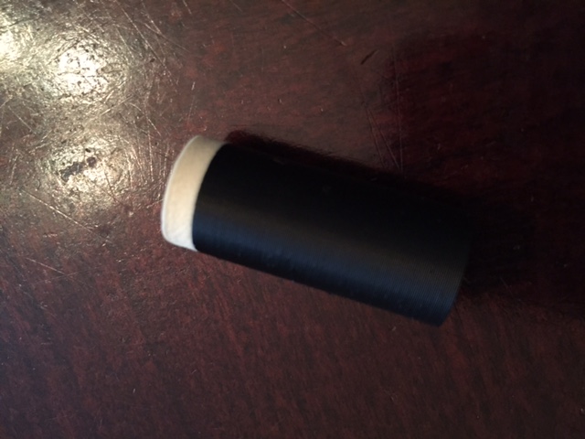

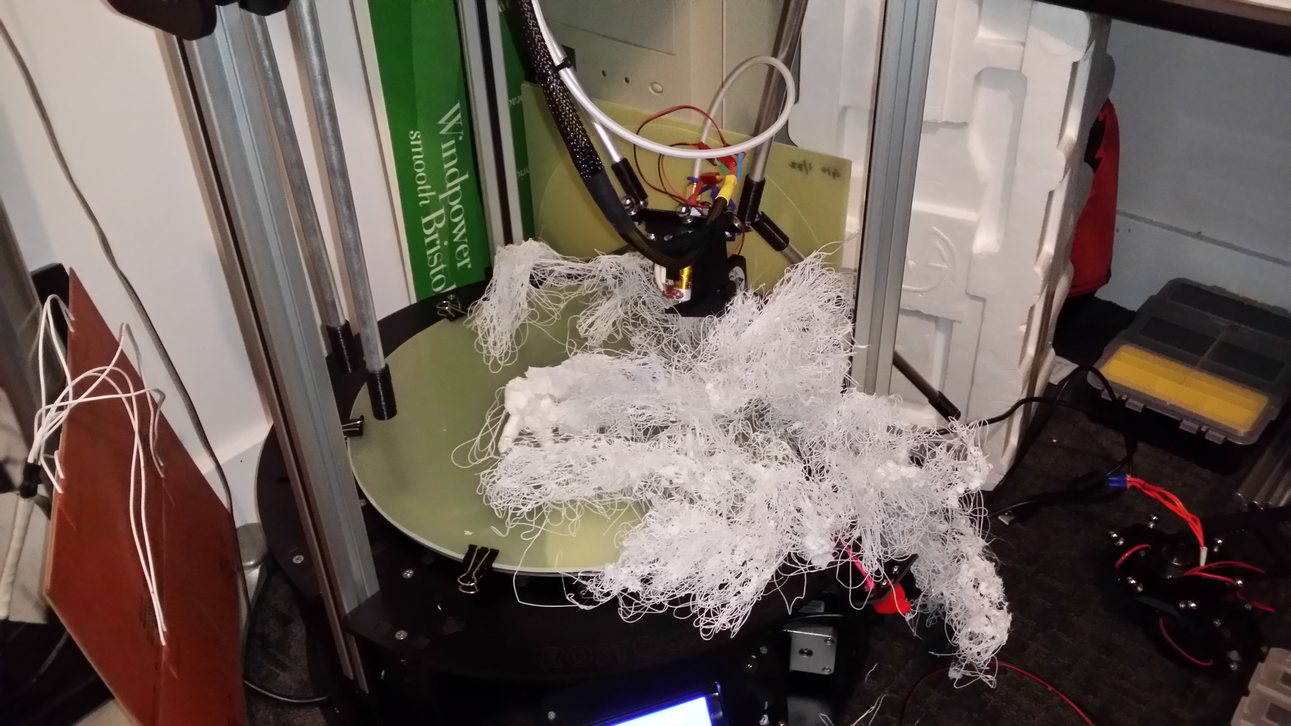

I used them for a number of months, but ultimately went to the trick laser arms.
Pros:
Quick changing hot ends (if you have multiple types)
Nice lines as there is virtually zero play
Cons:
Failed prints from effector coming off
I had MANY failed prints because of this. If the hot end hit a snag, a lip, or an upturned surface from an overhang or anything.... done. I would often come to my printer in the morning to find a big rats nest of filament and the arms flopping around as the printer was still trying to work.
Great idea in theory, but for me, it wasn't worth the effort. I'm much happier with my trick laser arms.

I have done a bunch of arm mods for the last couple years, mostly with magnetic arms. Here are some things you need to consider;
1) Arms are fairly straight
2) Arms are rigid. Metal tubes or CF preferably.
3) The length from ball center to ball center must be the same for all six arms to within 0.1mm.
4) The strength of the magnet is not enough to hold the arms on near the edges of the build area if your arms are not the same length.
You will not get a great setup with magnetic arms without some big calipers to measure with.
