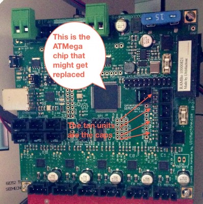

Salvaged thermistor port
Well, I may be on the right path. I suspected the small caps on the thermistor circuits on the RAMBo might have blown on my board. I replaced the cap on the original heated bed port that I blew over a month ago and it now works. This tells me that the Arduino muxed input for the thermistor pins is probably ok. I'll be interested to see if I can resurrect the other 3 ports.

Take good notes and pictures. I see another sticky as this has happened to a couple of RAMBO's. Always look forward to your write-ups.
Re: Mhackney's Rostock Max
are the caps the little bitty sqaure ones next to the thermistor headers. if they are those things are awfully small.

What are the values for those littleguys and if you don't mind could you snap a quick pic of the suspected components. Since I have a few rambo's here I could sacrific one to attempt the transplant or on of my scrap boards in my junk bin.

@Flateric - here's a photo of the parts placement:
This is the part from Digikey. I'd suggest waiting a couple of days until I can get to the other ones and see if this is indeed a fix or if the ATMega will need to be replaced too.

Do you already have an idea how to put the bootloader on the chip?mhackney wrote:if this is indeed a fix or if the ATMega will need to be replaced too.

That will be a bit of a challenge but I have a few EE friends who know how to do this.

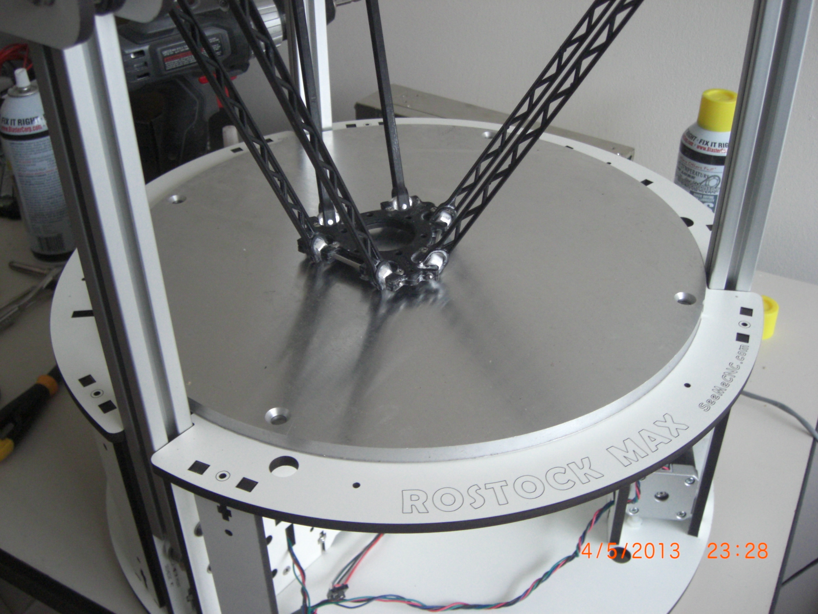

Build Plate Update
See Adjustable Build Plate Design
The three MIC-6 aluminum disks I ordered arrived today:

They are, as MIC-6 should be, flat. They are 5/16" thick and 16 3/4" diameter. They will be milled down as to make the micro-adjustable build surface shown in the link above. My ONLY concern with these are their mass and the amount of power it will take to heat these up. They weigh 7# each. Of course they will be a little lighter when they are cut down to 13" diameter, but still a big item that can't be shipped flat rate priority.

i haven't had a chance to test my 3/8 mic6 plate yet, i'm having too much fun playing around with my printer now that its somewhat dialed in.
