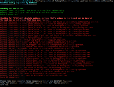

I got an email from the FirePick team about the possibility of adapting my calibration system to work on their robot. (It's an old-style delta with overhead rotating arms, rather than "linear" like ours.) I'm adding support to specify build area shape (round or square) with a config option, as they requested, because their robot has a square build surface. I will also help them adapt the routines to talk to their kinematics, which are very different from ours, but should respond about the same. I will be spending some time modularizing the code in two ways:
  • Allowing selection of different kinematic systems, and adding an option to choose linear or rotational delta.
  • Allowing selection of different heuristic calibration systems. This will allow me to offer schemes other than simulated annealing, such as the math used by dc42's Duet firmware.
I'm also bringing my fork up to date with the main Smoothie repo. I have the basic merge part done, and am currently working on getting the config files up to date. This has historically been torturous, because my config files are re-organized into sections so that it's easier to find what you're looking for. Diffs of .ini-like files are much harder to fathom than diffs of source code. To that end, I'm releasing a tool that will do two things. First, it will find any keywords that are present in the upstream (main Smoothie) config, but not in your local config. That will tell you any new options that you should copy into your config.
Second, it will tell you what options exist in your config, but not in the upstream config. This will tell you about any potentially obsolete options that have been retired. (It will also flag all the options I've put into my branch that don't exist upstream, so you can ignore most/all of that output.)
It will be included with my next commit, which I think will be in the next few days. In the mean time, if you want to take a look, it's here: http://pastebin.com/WCwXGQFv
The tool runs on Linux under bash. If you have Mac OS X, you may be able to run it in a terminal; obviously you would need to install the bash package (however you do that). If you have Windows, you will need to install cygwin (free). I'm not able to support this tool under any platform other than Linux. If someone wants to port it to run in JavaScript on a browser, that would make it run for everyone.

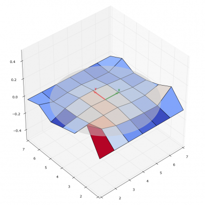

pyjamasam -
I'm including your excellent dm_surface_transform visualizer in my next release. I've put in instructions on how to install matplotlib for python, and modified the script so that it automatically looks for dm_surface_transform in the current directory. You have been credited, and a link has been included to your source on gist. If you don't want me to include the script (so people have to go to your gist to get it), let me know and I'll remove it.
For anyone curious, this is what the visualizer looks like. It lets you pan around!
I saw you've been having a few issues with your fork of my fork. Thanks for figuring out the new way to hand arrays to the FK/IK methods. Copying the array subscripts into a new array that those methods understand is alright. However, you forgot to copy the output back into the main array after the first call you modified. I fixed this on my side. I also noticed one of your commit comments is that you've disabled stuff because you're crashing. This is because you have enlarged the probing grid from 7x7 to 9x9. It may not seem like a large increase, but doing that requires significantly more memory. There are places where this can be addressed. For example, right now, we have some 2D arrays that contain XYZ coordinates (XY for bed position, Z for vertical deflection relative to bed center). The bed position subscripts of these arrays can be dropped in favor of calculating the coordinates every time we need them. This is a little slower than reading them out of an array, but not much. It requires a few adds, subs, and muls, but that's it. The relevant code is in ComprehensiveDeltaStrategy::init_test_points(). I will look into that in a future release.

  • Added ConfigComparator.sh to the ConfigSamples directory. Its purpose is to help you figure out whether your file is missing any new options, or holding on to any that have been changed or removed (such as the pause button options - that was renamed from pause to kill!) Run without args for help.
  • Added pyjamasam's dm_surface_transform visualizer to the Smoothie root directory. Drop dm_surface_transform into the same directory and run: python dm_surface_analyzer.py. You need to have python and matplotlib installed. Instructions are in the comments at the top of the script.

626Pilot wrote:...You have been credited, and a link has been included to your source on gist. If you don't want me to include the script (so people have to go to your gist to get it), let me know and I'll remove it...
No probs. Include it away. It's all good.

Also that ConfigComparator script is great. Thanks for that.
