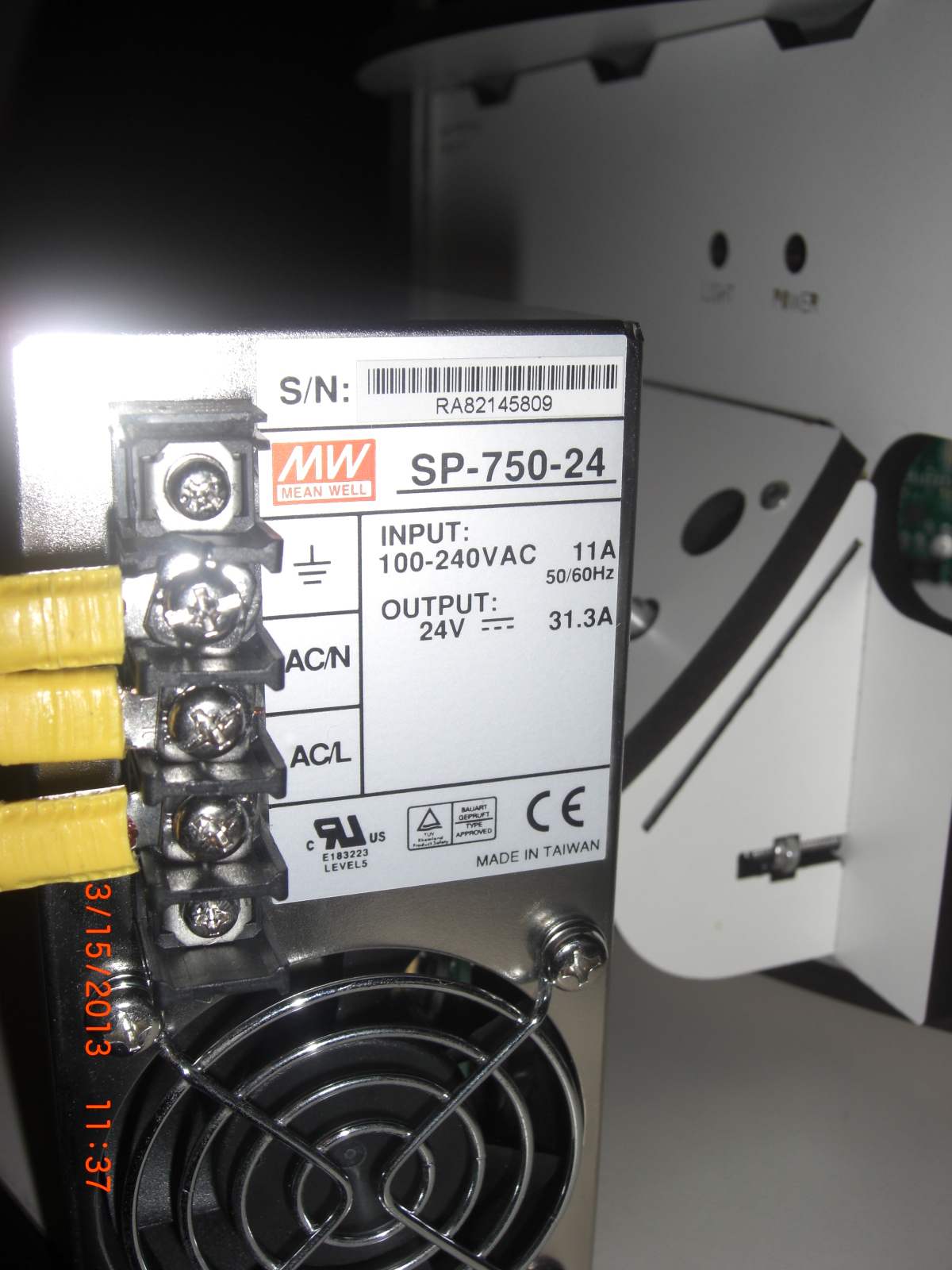

Continuing into the morning hours.. I decided to mod my voitek power supply a little. Just to clean some wiring up and add few things. Here is a sneak peak.
Dedicated 24v 31amp 750 watt Meanwell power supply and 25amp solid state relay for the Heated bed. To make sure my onyx gets to temp with the quickness. :mrgreen:
More to come later. I'm calling it a night.

So after some surgery on my voitek power supply. Here is the result. Combined that bunch of messy wires into something more manageable and got rid of lines that weren't needed.
3 dedicated 12v sources for the rambo. Plus one extra 12v source connect to fuseblock for accessories, One 5v source just in case I needed it for something, also wired to fuseblock for accessories
I will be adding a standby led light, manual power switch for the power supply, and power on Indicator on the front of the rostock.
Of course all this is just something I wanted to do and its not required.

cambo3d wrote:Continuing into the morning hours.. I decided to mod my voitek power supply a little. Just to clean some wiring up and add few things. Here is a sneak peak.
Why not just use the 24v PS to power the RAMbo? It's rated for up to 36v. I have a MendelMax running on a 24v PS to power the linear y-axis upgrade kapton heater. It doesn't complain at all.
Purple = sarcasm
cambo3d
Posts: 1057
Location: Florida
Re: Another rostock max build
Post by cambo3d »
Why not just use the 24v PS to power the RAMbo? It's rated for up to 36v. I have a MendelMax running on a 24v PS to power the linear y-axis upgrade kapton heater. It doesn't complain at all.[/quote]
The steppers that I have aren't rated for 24v and I wanted a dedicated supply for the heat bed.
