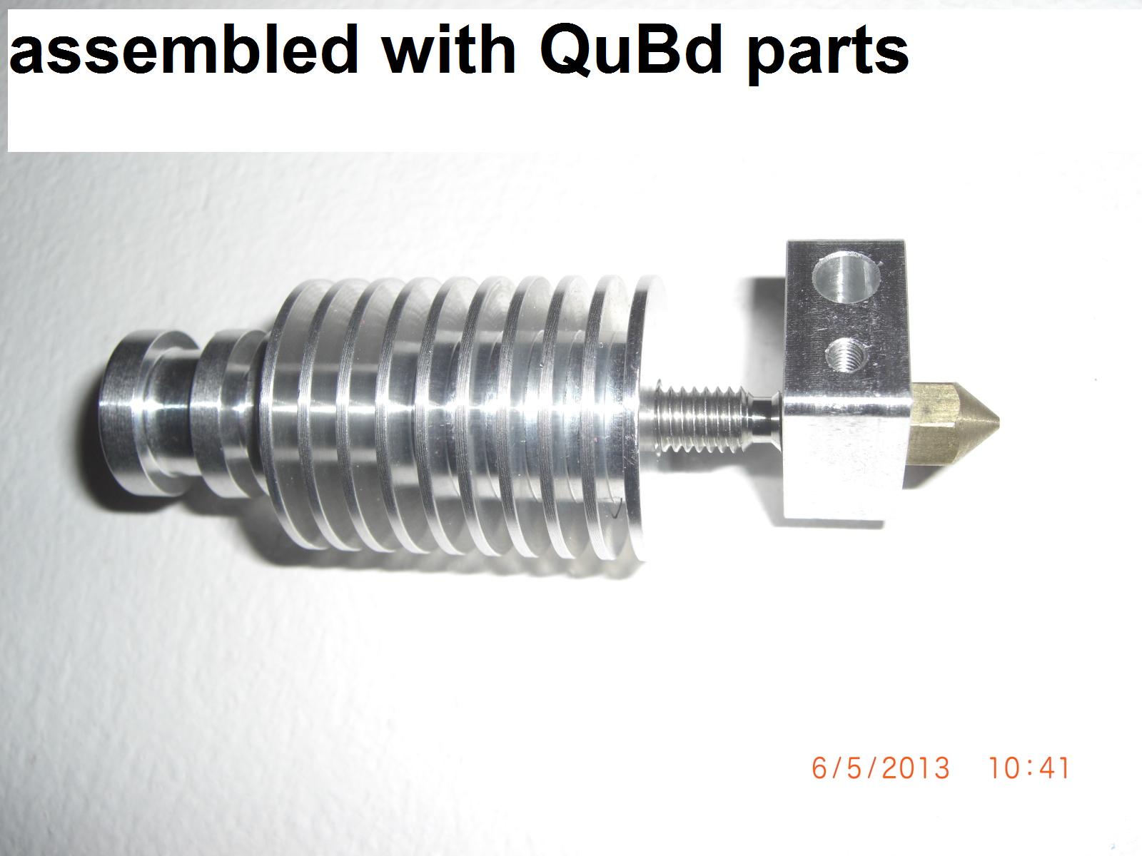

ed3/qubd hybrid..
Posted: Wed Jun 05, 2013 12:01 am
by cambo3d
since i bent one of the stainless steel tubes on my ed3, I found this to be a direct fit. Even though not the same and not saying this would be any better.
Qubd hotend has a beefier stainless steel tube and longer. Which would allow a larger size fan mount.
Just experimenting since I had the parts. If it works out be nice to know you could get replacement parts in the USA.

Re: Another rostock max build
Posted: Wed Jun 05, 2013 1:32 am
by ApacheXMD
with the longer stainless part, you have more of it exposed to open air (as opposed to it being either on the heat sink or heating block), do you think the plastic transition zone will grow? I think heat might creep up the stainless a little bit more since there's no heatsink there.
Posted: Wed Jun 05, 2013 10:01 am
by cambo3d
ApacheXMD wrote:with the longer stainless part, you have more of it exposed to open air (as opposed to it being either on the heat sink or heating block), do you think the plastic transition zone will grow? I think heat might creep up the stainless a little bit more since there's no heatsink there.
dont know, like I said just experimenting with it. but here is what the trinity labs hot end looks like. tube is just as long.
