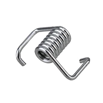

thank you for the advice, in fact it sound just right, where the carriage invert its direction.bot wrote:How tight are your belts? I've seen patterns like that on deltas, and it always leads me to belt tension. This is where deltas will experience backlash as the tower changes direction at that point.
 i'm using a tensioner on the carriage plus the spring one, i can't measure how tight they are but the feeling is that they are well tensioned.
[img]http://ecx.images-amazon.com/images/I/4 ... SX342_.jpg[/img]
I will try to print again with the belts more tight.
have I to run the calibration routine again after re-tensioning the belts?
Re: Heuristic (AI) calibration for delta printers on Smoothi
You should not have to do a calibration routine after tightening the belts.paboman wrote:thank you for the advice, in fact it sound just right, where the carriage invert its direction.bot wrote:How tight are your belts? I've seen patterns like that on deltas, and it always leads me to belt tension. This is where deltas will experience backlash as the tower changes direction at that point.

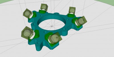

I already got started on the effector.
Done with the first iteration of my effector & carriages for magnetic arms. This is the best calibration I've ever had, by a significant margin. I told it to anneal everything except the arm length. After I get this perfected, I'm going to upload a new release of my firmware. After that, I'm looking at developing an expansion system that will let Smoothie drive more steppers.
