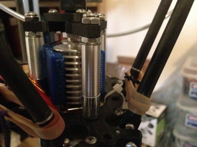

This might be hard to see but you should get the idea:
[img]http://mhackney.zenfolio.com/img/s5/v11 ... 6297-4.jpg[/img]
I used masking tape for a quick & dirty experiment. In addition to suspending the Bowden in the printer, I also "braced" the Bowden where it exits the extruder with tape. Since doing this, I have yet to have a "tat, tat, tat". I am printing with a filament now that I have noticed this problem with more in the past. Before adding the supporting tape, sure enough, at what I thought were reasonable temps, I was hearing the skips, I straightened out the Bowden and taped it as shown (after manually pushing the filament to get past the digit the extruder left) and now 85 layers later, no "tat, tat, tat". Not conclusive but maybe something to investigate.

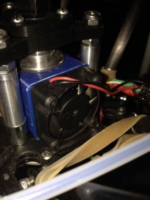

Well, I've been running 100% reliably now and feel confident (after some confirming tests) that I know the root cause of my and probably other's EZStruders skipping steps. The culprit? heat! My attempt to install a heatsink on the extruder driver was almost a disaster but luckily I did not do damage to my RAMBo. But, I did remove it. I then installed a 40mm fan in the cutout LCD opening in the door in the chamber when're the RAMBo resides:
[img]http://mhackney.zenfolio.com/img/s10/v9 ... 8937-4.jpg[/img]
This fan is wired to my E3D barrel fan on a switch so I turn it on when I start up and leave it on all the time. The fan is simply glued into the slot, it is almost a perfect friction fit. Now with the fan directed at my RAMBo, the board stays cool and I've printed for 100s of hours with many looooong 16+ hour prints with no "tat, tat, tat"! And, just to verify my hypothesis, I switched off the fan part way through a print and in about 10 minutes I started hearing the "tat, tat, tats" again. I flipped on the fan, manually assisted the extruder until the RAMBo cooled and I was back into flawless operation.
Now I think the symptoms make sense, I was seeing the stepper/extruder reverse during these skipped steps. Probably the thermal shutdown shuts off power from the stepper coils allowing the compressed filament to push back, thus reversing the rotation a few degrees.
