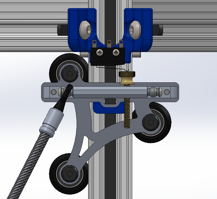

Does anyone have an STL of the Trick Trucks? That stuff is supposed to be open source, right?
- bvandiepenbos
- Posts: 923
- Location: Goshen, IN
I don't have a .stl model handy, but here is a .dxf file.626Pilot wrote:Does anyone have an STL of the Trick Trucks? That stuff is supposed to be open source, right?
- Trick Trucks rev3.dxf
- (2.19 MiB) Downloaded 639 times
Thanks, Brian! I'm gonna order another MAX METAL frame soon.
Thanks for this file, you are a life saver! Quick question: what thickness of aluminum should I waterjet this out of?

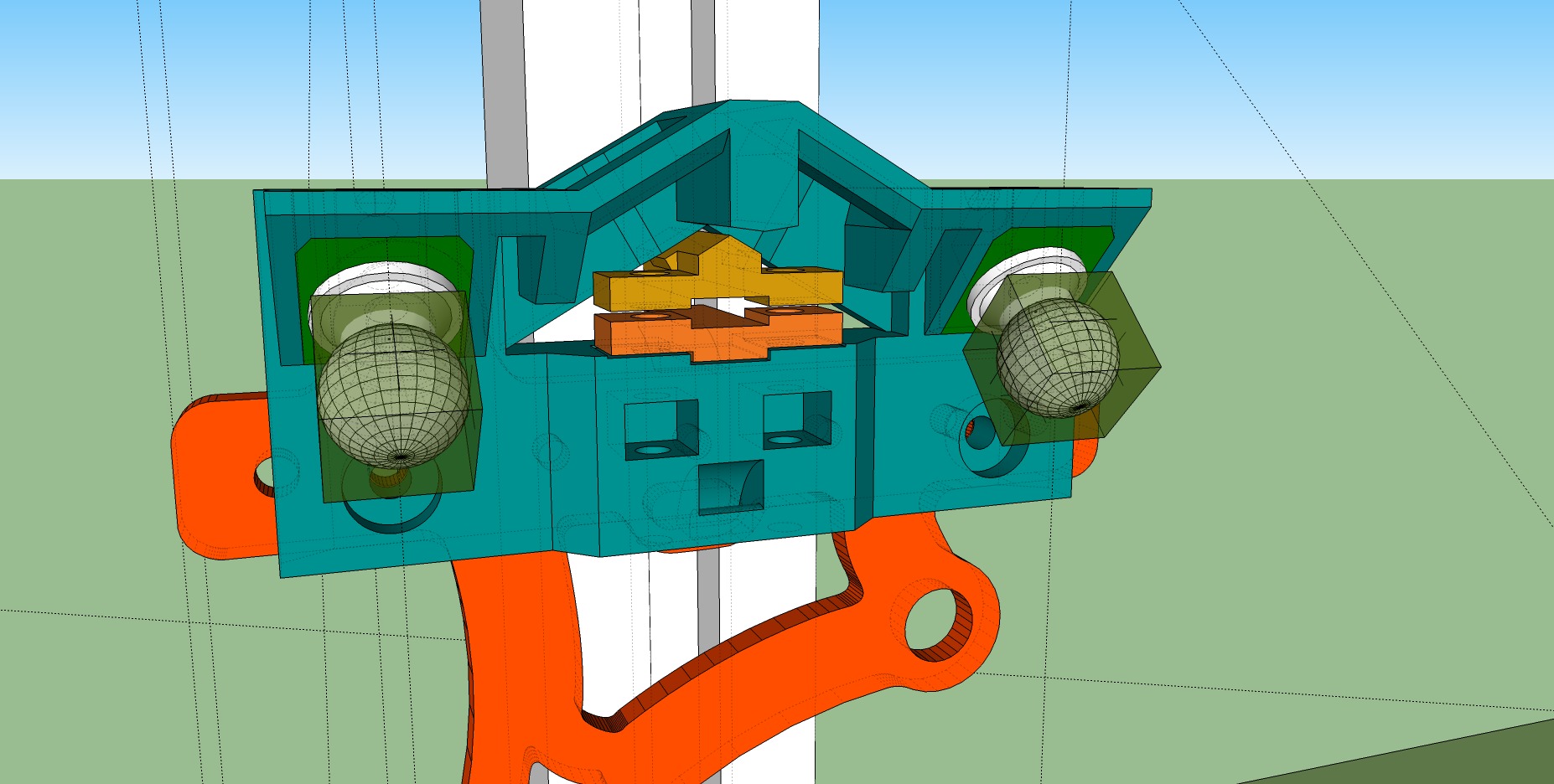

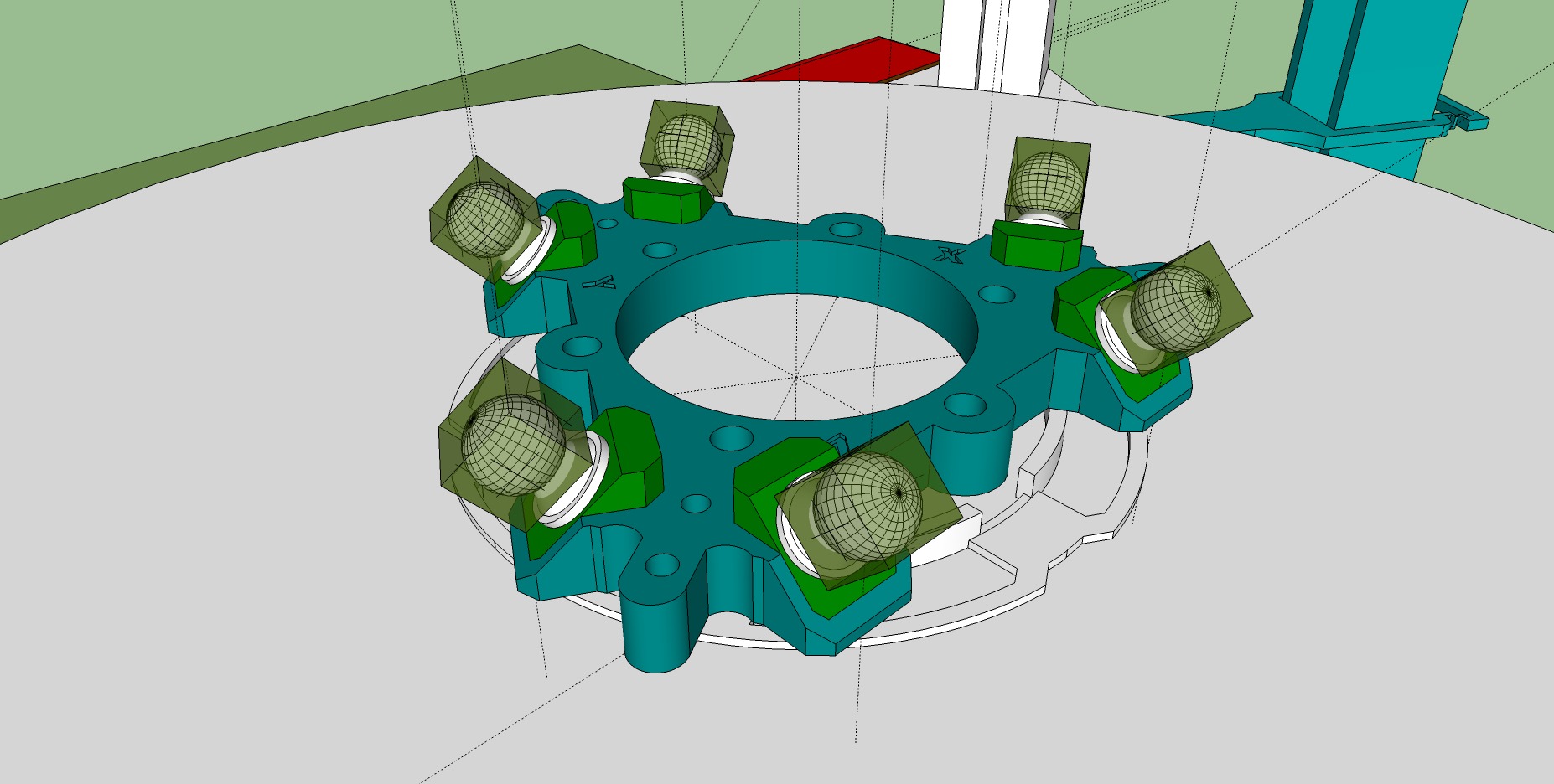

The MAX METAL is a great frame, better than any of SeeMeCNC's. I get much truer prints with it, and I think you will too. The design and construction are objectively better, in several important ways. There are MANY fewer parts, it takes far less time to build, there are no unnecessary degrees of freedom anywhere in the structure, and it has specific design elements that are there to make it self-aligning. Once you take the rails out of the packaging and see how cleanly and elegantly they've been machined, you will see what I'm talking about. I have no trouble saying that every printer I build from here on out will use this frame. I see no legitimate reason to consider another.
The only thing I would improve would be to use magnetic or tensioned ball arms. I 3D printed some carriages to bolt up to the Trick Trucks, and an effector, for mag arms. They are so precise that I no longer need to use a heuristic calibration. I still do the endstops and delta radius (GeneB calibration) but that's it. Mag arms can be annoying, so to me the perfect system would use tensioned ball arms, like the Cherry Pi IIIS. If Trick Laser sold something like that, I'd buy it tomorrow rather than sourcing all the stuff myself.
I think one improvement that could be made to the max metal would be to expand the horizontal distance between towers so that the "triangle" is completely within the 280mm build volume. In my experience, this has been the largest factor in making it easy to get full use of the entire print volume.

Does anyone kno what thickness of aluminum should be used when waterjetting the trick trucks?
- bvandiepenbos
- Posts: 923
I make them from 1/8" thick 6061 aluminum.TFMike wrote:Thanks for this file, you are a life saver! Quick question: what thickness of aluminum should I waterjet this out of?

Yes, balls to screw in place of the Traxxas end of Trick Laser CF Arms. It's in the works, I have had the parts and tooling for months... not enough hours in the day626Pilot wrote: The only thing I would improve would be to use magnetic or tensioned ball arms. I 3D printed some carriages to bolt up to the Trick Trucks, and an effector, for mag arms. They are so precise that I no longer need to use a heuristic calibration. I still do the endstops and delta radius (GeneB calibration) but that's it. Mag arms can be annoying, so to me the perfect system would use tensioned ball arms, like the Cherry Pi IIIS. If Trick Laser sold something like that, I'd buy it tomorrow rather than sourcing all the stuff myself.
I agree 100% about the tension spring/cord setup looks like the way to go. That's the plan. Either that or two spring each end pulling cup ends onto balls.
However, orienting cups and setting precise arm length as a field retrofit is much harder than screwing balls onto ends of arms.
I do not like the mag-ball-cup arms either, tried them, don't trust them and the stupid things can easily jump apart if you try to move platform by hand.

This is very good news!bvandiepenbos wrote:I agree 100% about the tension spring/cord setup looks like the way to go. That's the plan. Either that or two spring each end pulling cup ends onto balls.
I designed my carriages/effector with the ball mounts as separate pieces, so I could redo them to have recessed cups if I went to tensioned ball arms. A 45-degree angle seems to provide optimal range of motion. I also made integrated belt clamps and decided to use the structure itself as an "endstop screw" since the offsets can be modified in firmware. There are two front pockets for captive locknuts, and a curved channel for tying up a flying extruder platform, or for doing tensioned ball arms.

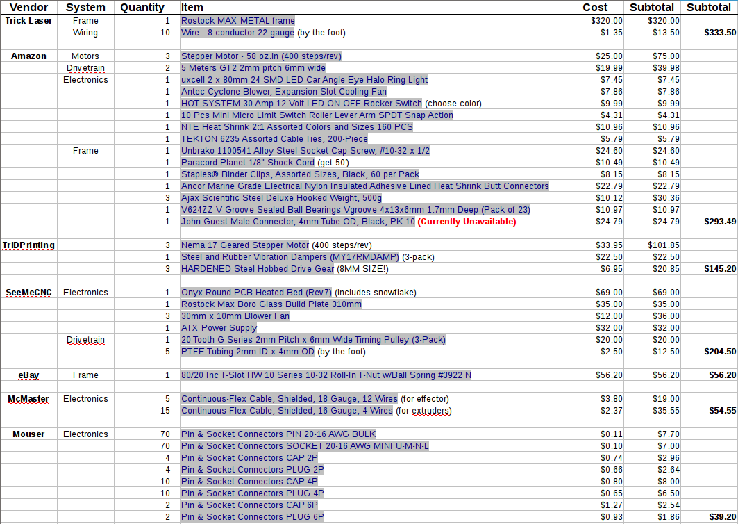

How bout a BOM for those of us thinking about building out a Max Metal Frame?
This is the basic part of my BOM. It gets you everything except the carriages, arms, effector, hot end, controller, and LCD panel. Doesn't include 3D-printed parts. Subtotal is $1,126.64, shipping excluded.
What can I eliminate out of this if I were to use components from my Max V2? This looks like an amazing upgrade and would be worth the time and effort expended.626Pilot wrote:This is the basic part of my BOM. It gets you everything except the carriages, arms, effector, hot end, controller, and LCD panel. Doesn't include 3D-printed parts. Subtotal is $1,126.64, shipping excluded.
You can reuse the steppers, pulleys (if they're the new 20-tooth ones from SeeMeCNC), hobbed drive gear, EZ-Struder, T-slot nuts, power supply, power switch, GT2 belts, binder clips, Onyx + glass, PTFE tubing, endstop switches, controller, and LCD panel. You can also leave out the paracord unless you're doing a flying extruder platform. The John Guest connector is the standard E3D PTC fitting, although they drill it out so you can pass the PTFE all the way through.
You also need a bunch of 3D-printed parts. The git repo is here.

I designed the MAX METAL Frame to re-use most everything from the Rostock MAX machine, basically a replacement of the wobbly imprecise wood frame. Other than needing to print a few brackets. You don't really *need* anything else that I can think of right now. Someone correct me please if I am forgetting something.
It would not be the prettiest thing, but with a bit of creative mounting you could reuse the LCD mount, Rambo mount, extruder mount, and spool holder from the current v2 kit. May save a bit and would save time printing the parts. ...call it up-cycling

Thanks for the information. How would I know if the pulleys are the newer ones or not? I bought my V2 at the very end of September and received it early October 2015.626Pilot wrote:You can reuse the steppers, pulleys (if they're the new 20-tooth ones from SeeMeCNC), hobbed drive gear, EZ-Struder, T-slot nuts, power supply, power switch, GT2 belts, binder clips, Onyx + glass, PTFE tubing, endstop switches, controller, and LCD panel. You can also leave out the paracord unless you're doing a flying extruder platform. The John Guest connector is the standard E3D PTC fitting, although they drill it out so you can pass the PTFE all the way through.

You have 20 tooth pulleys.
It has been since the early v1 days that kits used smaller size.
