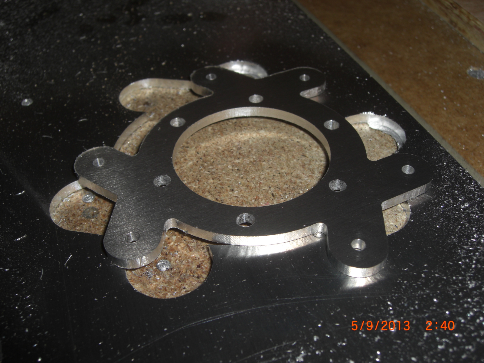

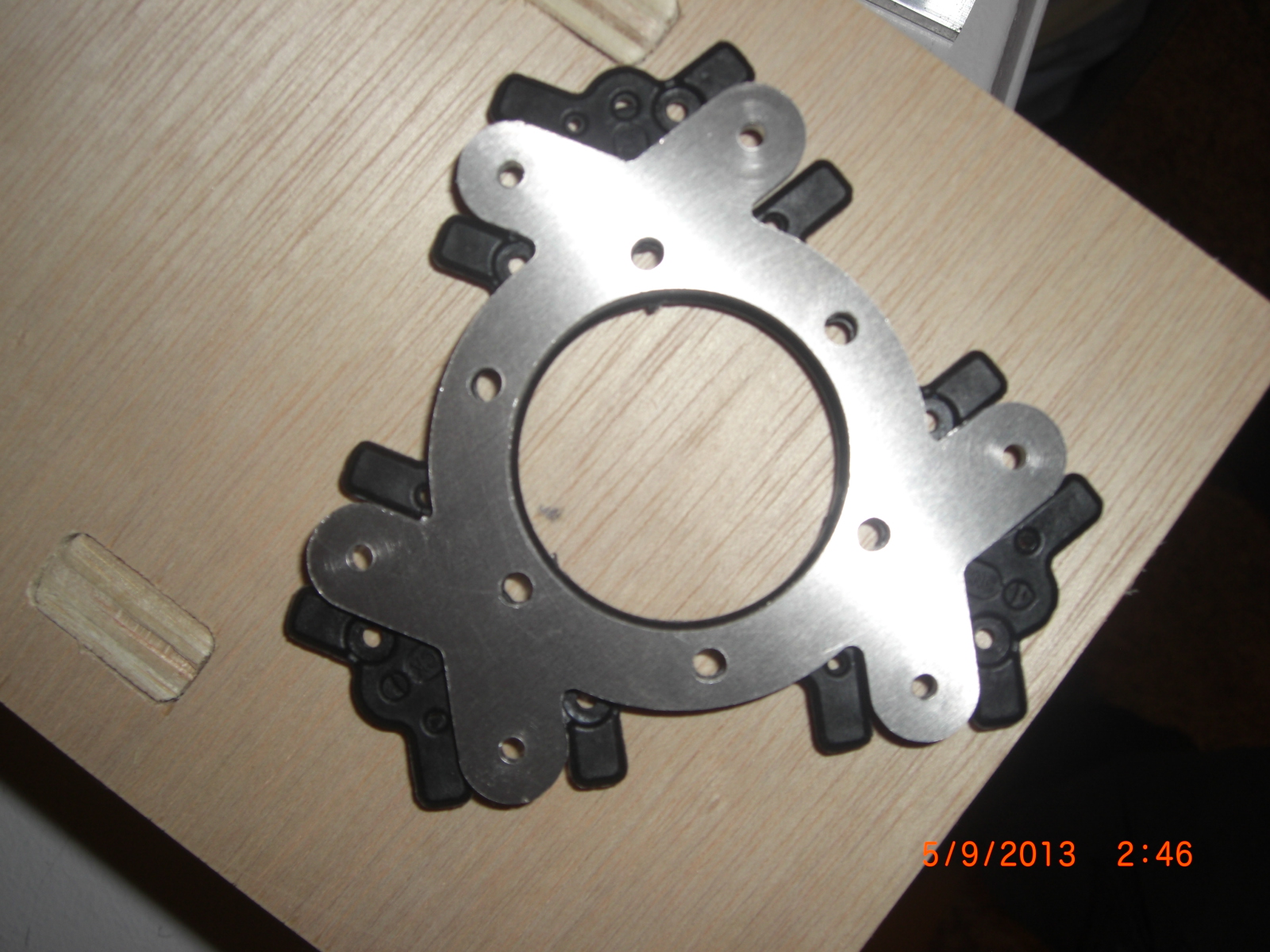

all aluminum platform for magnet ends
Post by cambo3d »
excited to show this off today, made from 1/8" 6061 aluminum. http://forum.seemecnc.com/viewtopic.php ... 300#p10848
off the cnc router
weighs about 24g, don't know if this is good or bad, but seems fairly light to me.
comparing to stock
can use ball studs with magnets ends on the rods or, cup mount for ball bearing, etc.. still working out the design

All aluminum platform for magnetic arms
Post by cambo3d »
Just trying to gauge how many people would be interested in this. I have a proto type made as you can see from recent post. http://forum.seemecnc.com/viewtopic.php ... 340#p11917
Originally made this for my own rostock but I've had a couple people interested in it also.
so I'm wondering many would be interested? What you guys think a reasonable price for this would be? If there's enough people interested, I may be able to swing it.

Re: All aluminum platform for magnetic arms
cambo3d wrote:Just trying to gauge how many people would be interested in this. I have a proto type made as you can see from recent post. http://forum.seemecnc.com/viewtopic.php ... 340#p11917
Put me down as interested. Price can only be determined by you because we have no way of knowing the cost of materials, time invested, and profit.

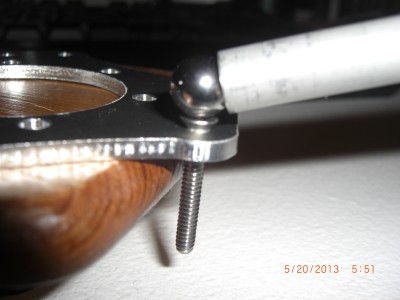

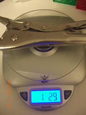

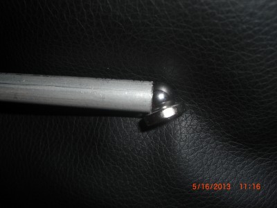

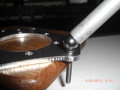

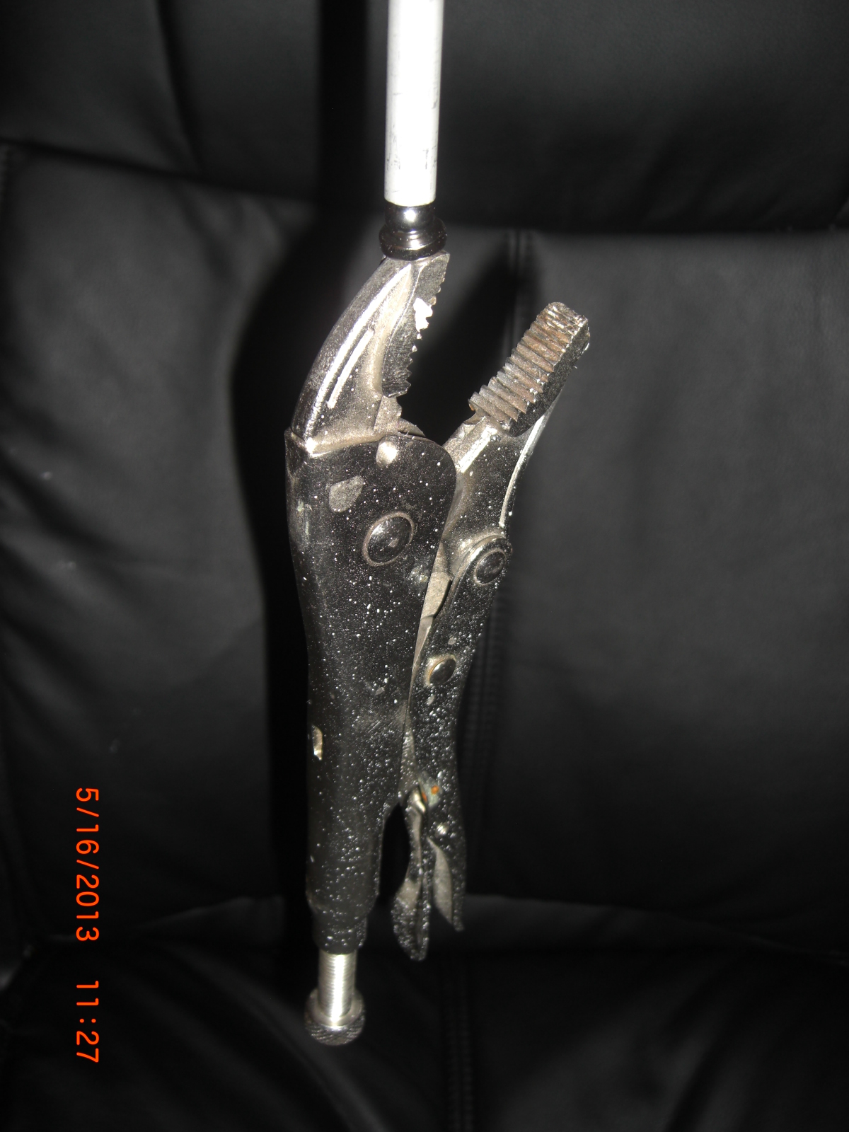

all aluminum magnet joint progress
Post by cambo3d »
some more progress on the all aluminum magnet joints compatible with seemecnc parts.
testing fit up
little more than a pound of weight

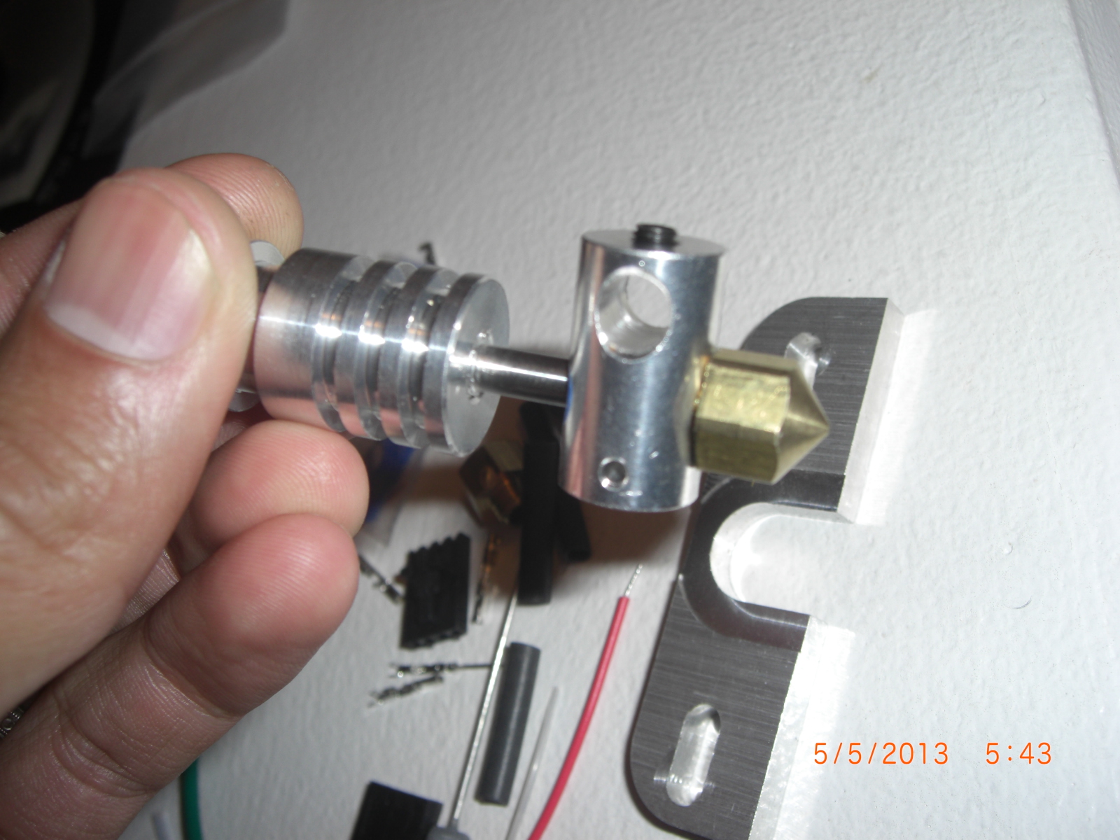

Post by cambo3d »
test fitting all aluminum hot end mount prototype . compatible with xnarons conversion.

Re: Another rostock max build
Cambo3d, I am confused how your effector works. Xnaron's mount the balls at an approximate 30 degree angle,
yours appears to be flat. How has the testing gone on your aluminum version?
