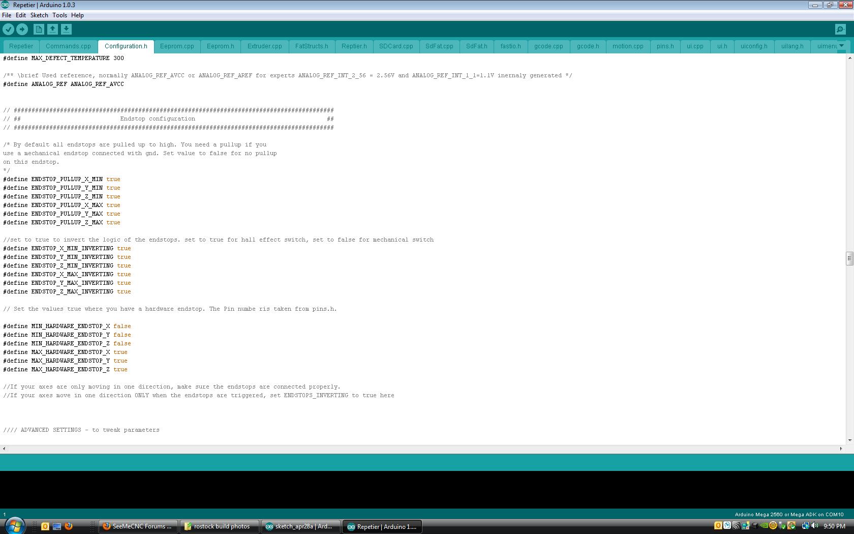

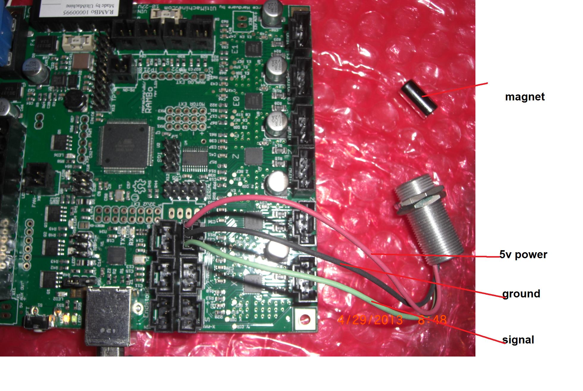

hall effect endstop/home switch testing success
Posted: Sun Apr 28, 2013 10:05 pm
by cambo3d
this is really easy to set up, just change some values in firmware and its ready to go.
testing on the bench
proof
firmware setup

Cambo3D, you told me how to get the nylon lock nuts on backwards and by golly it worked! Thank you.
I would like to see how you mount those hall effect sensors, those little micro-switches are a real pain to line
up with the screw head, the holes for the screws seem to be in the wrong place. We really need an alternative
and I think your idea will be great. I am looking forward to seeing some pictures on what you came up with for
the mounting of those hall effects. You are always coming up with great ideas and I love to steal em. :P

I am going to check out using the hall effect sensors that are about the size of a transistor. I think they would be easier to mount
and would fit the scale of the Rostock better. Place the hall effect sensor where the microswitch is now and maybe a small magnet on
the end of the screw. Just thinking out loud, if I come up with something I'll post it.

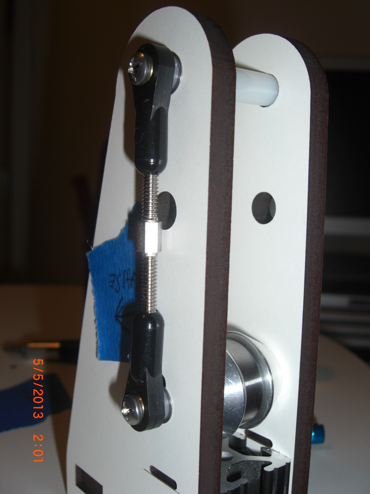

turnbuckle idea
Posted: Sat May 04, 2013 2:04 pm
by cambo3d
so i finally found some heavy duty turnbuckles and ball ends that fit the stock screw sizes, here are the pics in comparison.
installed

Eaglezsoar wrote:I am going to check out using the hall effect sensors that are about the size of a transistor. I think they would be easier to mount
FWIW I think using a hall effects the magnet must pass by the sensor not move directly towards it.
You should read the datasheet for the sensor and look at how they recommend using it.

you can use it either way,

cambos T-buck tensioner parts list and files.
Posted: Sat May 04, 2013 6:00 pm
by cambo3d
Turn buckle tensioner parts, FOR modified top supports.
I purchased some of these items in bulk, the quantities needed for assembly are in parenthesis ( ).
• (1) Dubro - DUBQ2316 – 12 pack of monster ball links, package has hardware needed for installation so don’t lose the parts
• (3) Packages of Great planes – GPMQ3754- Turnbuckle/pushrod, these come two per package.
• (6) 2.5in 6-32 screws Mcmastercarr part# 91772A161
• (12) 6-32 washers or #6 washers
• (3) 5/16 OD x 1.5in length nylon spacers for #6 screws. Mcmastercarr part # 94639A371
• (1) 5mm adjustment wrench, towerhobbies.com carries an assortment of these, just pick one you like. http://www3.towerhobbies.com/cgi-bin/wt ... 5mm+wrench& search=Go
• (6) Modified top support plates dxf file below.
Notes:
All the turnbuckles will need to be cut down slightly, they are 54mm in length, I removed 4-6mm off each end to give me the adjustment range I needed. If you can find shorter length turnbuckles in the 6-32 size and around 42mm that would be a better fit for the current top support plates. You can also modify the dxf file so that there is more spacing in between the very top and the bottom hole, that way you don’t have to cut down the turnbuckles. My top support plates were already cut so I did the later.
If you need to cut down the 6-32 turn buckle, this can be accomplished with just some wire strippers that have 6-32 bolt cutters integrated, makes quick work of it. Just use a file to remove any burrs.
