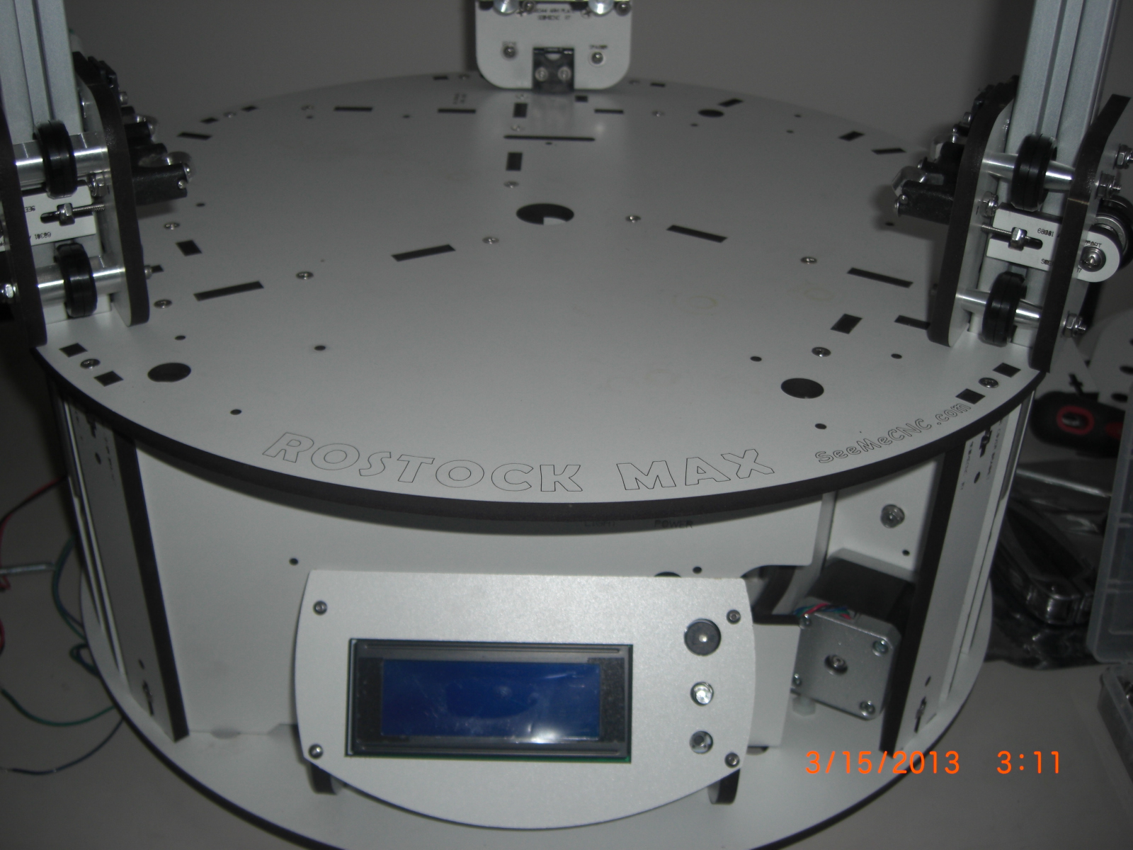

Posted: Thu Mar 14, 2013 3:26 pm
by cambo3d
rambo mounted up and lcd installed. I used 4-40 socket cap pan head screws to mount lcd panel (not included, I did this because it looked better) to the angled mount. You will have to drill holes in the angle mount to mount the lcd panel cover. Do this carefully or you will split the melamine angle mounts or damage your lcd.
Re: Another rostock max build
Posted: Thu Mar 14, 2013 3:32 pm
by mhackney
Yeah, I like that mounting location for the RAMBo - no wire flex and stress on connectors when opening/closing the access door.
Posted: Thu Mar 14, 2013 3:43 pm
by cambo3d
mhackney wrote:I like that. If you move the LCD door to the spot between the X and Y towers you will not have any problems putting the Add-A-Struder kit between the Y and Z towers since that door will not need to be accessed. Do all of the partitions have these mounting holes in your kit?
That's exactly how i've mounted them. So everything is accessed in one location and second extruder kit wont be in the way.

Mounted all the pcb headers in place to prep the new rambo lcd adapter for soldering. Would have been nice if these came soldered.
Posted: Thu Mar 14, 2013 5:17 pm
by cambo3d
The final result. I recommend soldering the two 10 pin headers first. Then turn it over and solder the others. This will allow you more room to solder without the other headers in your way.
In the photos, I did it the other way and found that soldering the two 10 pin headers last makes it a little more difficult. Especially if you do not have steady hands
all soldered up ready to install.
Installed and ready for cable connections. On the adapter as viewed from my photo. The top 10 pin header is your A connector from the lcd ( "A" connector meaning left connector on lcd) and the bottom is your B connector from the lcd. If you happen to reverse the cables, dont worry. All you have to do is swap them around. Your lcd will not power on if the cables are not in the correct spots

Has anyone wondered or knows what the slots and holes are for on the top plate of the rostock max?
or maybe no reason at all for them being there?
Posted: Fri Mar 15, 2013 6:45 pm
by Eaglezsoar
Best guess is they wanted to make sure it was ventilated and went a little overboard.
by aehM_Key
Maybe for this: http://www.youtube.com/watch?v=j8B1PypVCvU&hd=1 ...and other future extensions ;)
