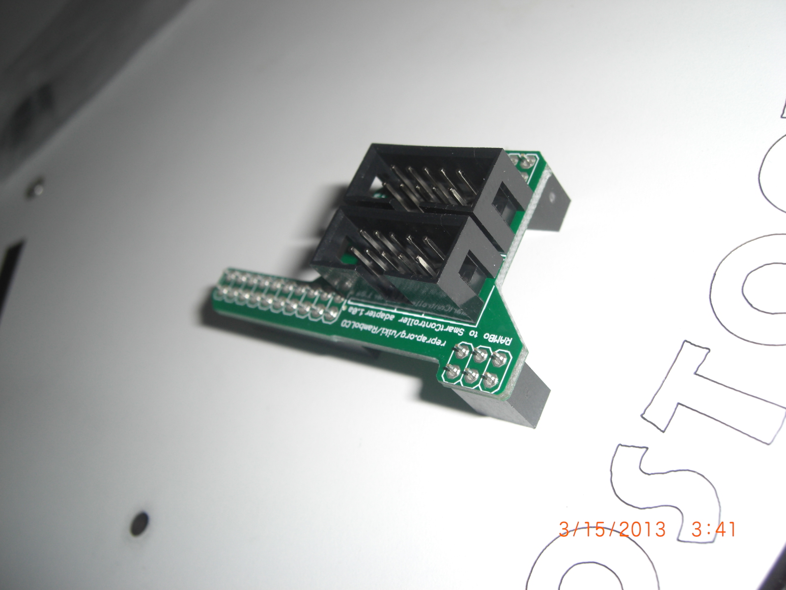

Mounted all the pcb headers in place to prep the new rambo lcd adapter for soldering. Would have been nice if these came soldered.
cambo3d
Posts: 1057
Location: Florida
Re: Another rostock max build
Post by cambo3d »
The final result. I recommend soldering the two 10 pin headers first. Then turn it over and solder the others. This will allow you more room to solder without the other headers in your way.
In the photos, I did it the other way and found that soldering the two 10 pin headers last makes it a little more difficult. Especially if you do not have steady hands

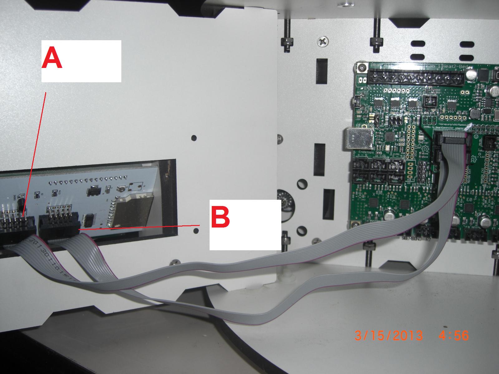

Installed and ready for cable connections. On the adapter as viewed from my photo. The top 10 pin header is your A connector from the lcd ( "A" connector meaning left connector on lcd) and the bottom is your B connector from the lcd. If you happen to reverse the cables, dont worry. All you have to do is swap them around. Your lcd will not power on if the cables are not in the correct spots

aehM_Key
Posts: 200
Location: Germany
Post by aehM_Key »
I'm not sure, if every soldering point is a good one..
Hard to say from the pictures. Maybe you want to doublecheck.
cambo3d
Posts: 1057
Location: Florida
Post by cambo3d »
aehM_Key wrote:I'm not sure, if every soldering point is a good one..
yeah its not perfect but they all metered good.

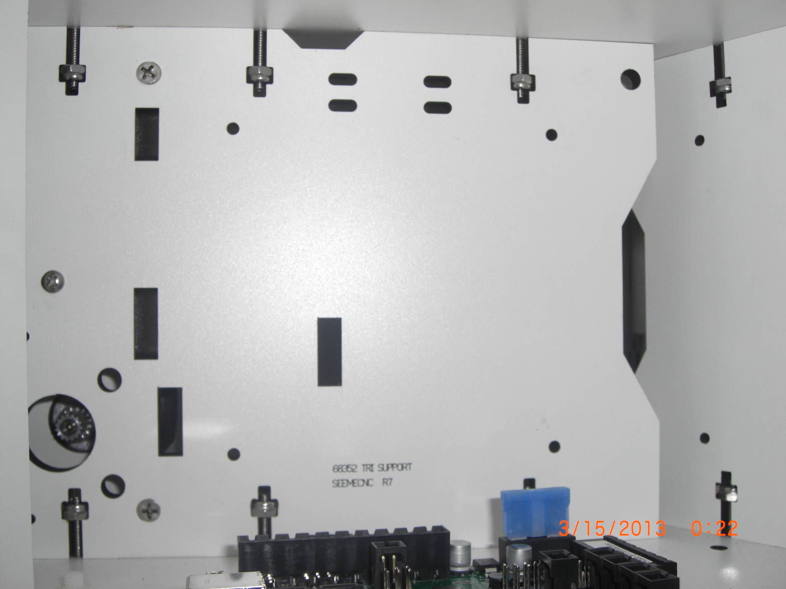

Has anyone wondered or knows what the slots and holes are for on the top plate of the rostock max?
or maybe no reason at all for them being there?
Best guess is they wanted to make sure it was ventilated and went a little overboard.
aehM_Key
Posts: 200
Location: Germany
Post by aehM_Key »
Maybe for this: http://www.youtube.com/watch?v=j8B1PypVCvU&hd=1 ...and other future extensions ;)
